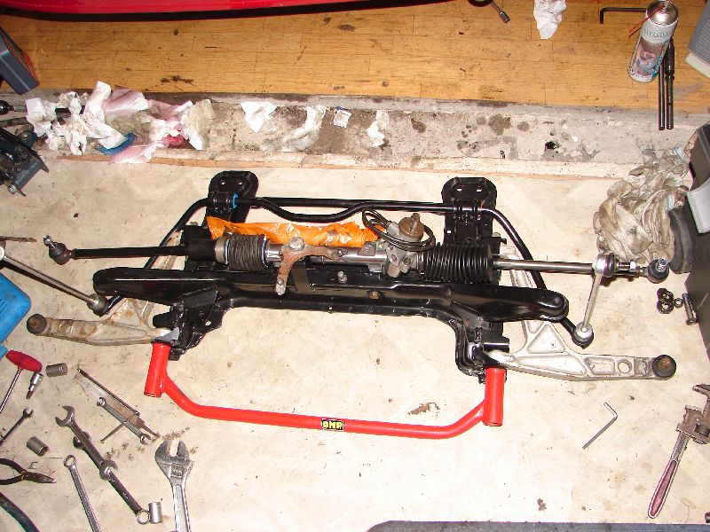

Changed almost the whole front suspension:

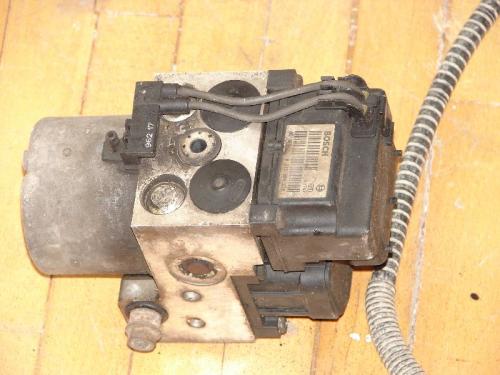

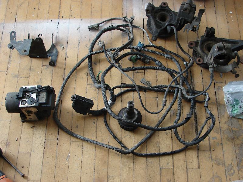

A four channel ABS5 from a 99 306. The ABS front hubs are on, just have to find a 306 ABS with disc brakes at the rear.

Just have to play with the driveshafts to adapt the cog wheel of the ABS.
But I have got a few solutions :blush:

Won't the calibration of the 306 ABS ECU unit be all wrong for the 205?

I don't think so because it's just an ABS unit, not ESP or something else. So just listening to the tyre slip and does his job.
Maybe I will install the late 205's load dependant brake pressure regulator, because it's similar to the 306's, or will use the 306's one.
But when it will come alive this question will be answered :lol:

The Bosch 5.3 ABS units on the 306 had electronic brakeforce distribution (EBD) as well...
The ABS ECU will be calibrated to allow certain amounts of slip on each wheel and to apply the brakes at differering amounts to the wheels not slipping (The EBD part). This will be calibrated to the car by the manufacturer at the design stage.
This ABS unit also controls the front\rear proportioning of the braking, so no need for external valves, again if it's calibrated for another car you may get to much braking on the rear of a 205, causing anti-lock activation just when you dont want it.
It will be interesting to see if it works well, keep us updated. (Hopefully it will work and then we'll all be doing it :lol: )

maybe the ABS from a saxo or a 106 would be more suitable if that's the case, the actual installation would be the same and pretty straightforward as the ABS wiring is self contained, all it needs is a permanent and switched live.
The 306(the ABS came form) has got external valves on the rear axle. It hasn't got EBD. It's only ABS 5.0
In 1993 Bosch developers built the generation 5.0 with new magnetic valves. It was followed by the 5.3 and 5.7 versions. Additional functions were added, e.g. electronic brake force metering which replaced the mechanical brake force proportioning valve on the rear axle.

Ok, fair enough, it's just my old 306 was a 1999 HDi model which had 5.3, which is why I thought this one was.
It certainly makes it more likely to work as it came from one with the rear proportioning valves, go for it :wub:

My mate(306 electric guru) said, he hasn't met any 306 with EBD till now.
The donor was 1999 too, but just Diesel not HDi.

Yep, I've just checked Servicebox - it seems there were two types of this ABS running at the same time. The cars with rear compensators didn't have EBD and the ones without rear compensators which did have EBD!
This confirms then that the ABS unit you have is probably the best one to retro-fit into a 205.

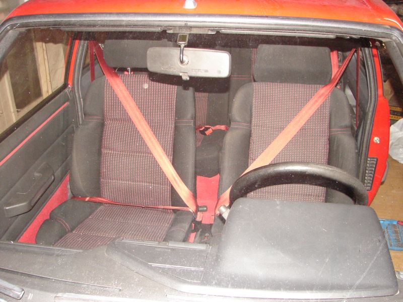

The real present was a set of EuroRallye seat belt, I think it looks great

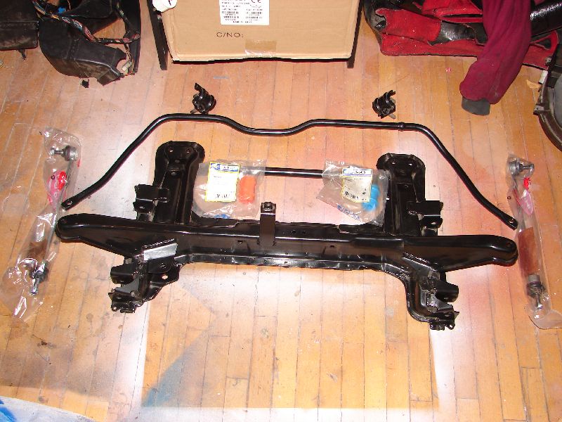

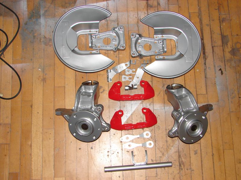

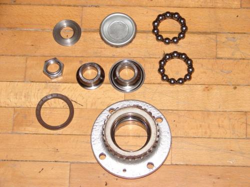

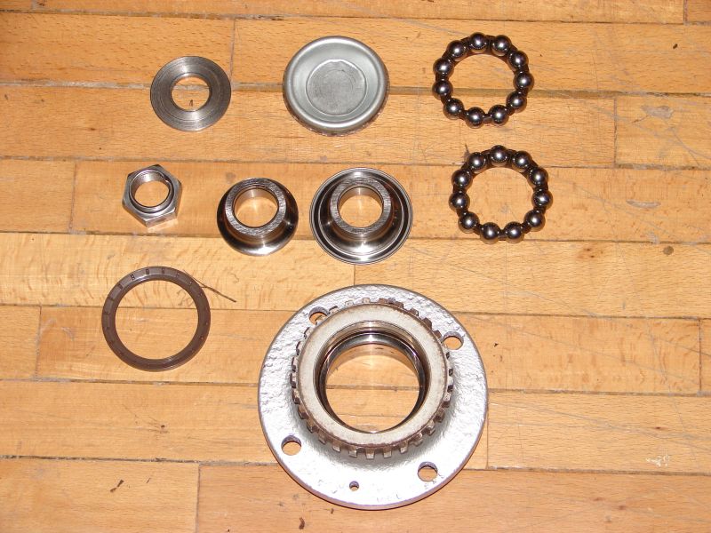

In january I started the suspension upgrade to prepare my car for the 306 ABS. Refurbed the rear hubs, the Xsara(32mm) rear calipers, trailing arms and the 205 front ABS hubs. Almost everthing has been powdercoated.
