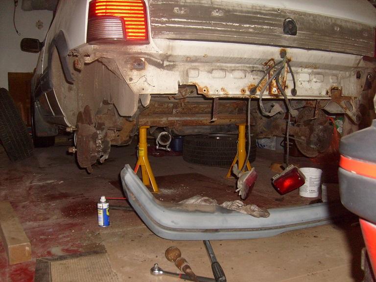

Starting with the rust!! So she's up on axle stands on the rear beam at the moment. bumpers got to come off but everything's rusted up! so snap snap snap............................
Few issues I noticed after getting the wheels off with a lump hammer!!
Near side brake lines rusty as anything so will need replacing
Far side caliper is stuck and bleed nipples snapped!
Rear bumpers rusted fixings so these need replacing.
On the plus side I'm getting good dripping bolts out :) Pictures to be uploaded as soon as I take some but I plan on spending one day a week doing bits starting with the underside of the car.

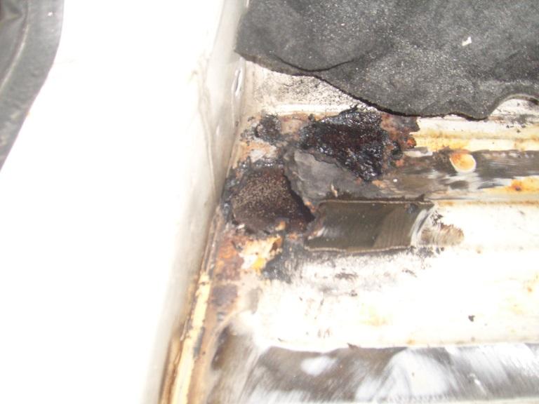

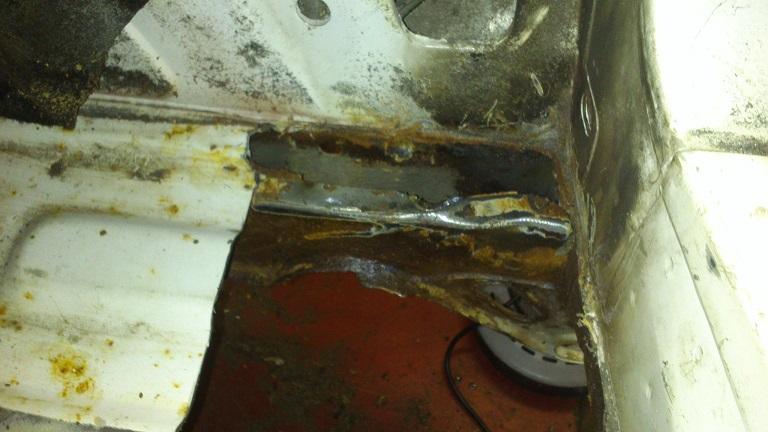

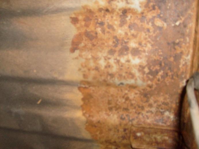

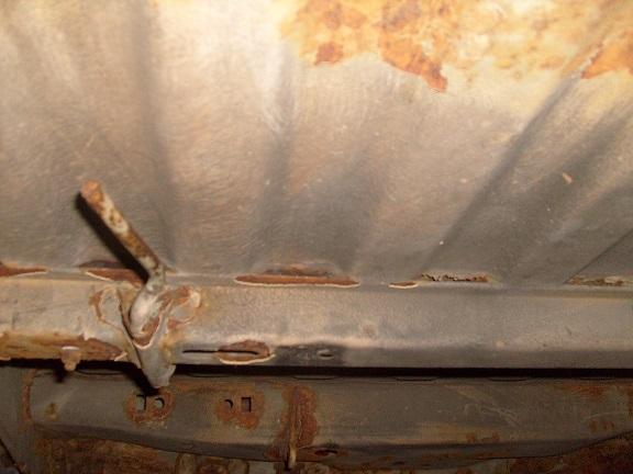

Rust in the underside of the boot floor
previous repair

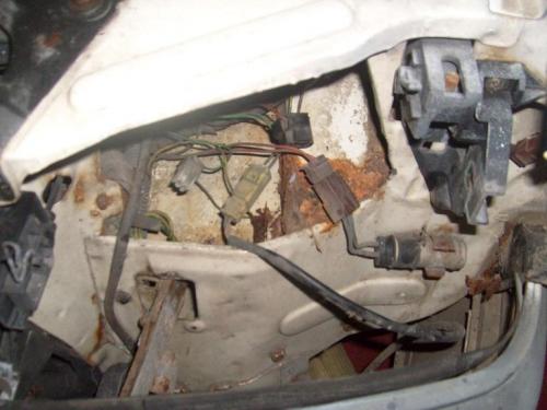

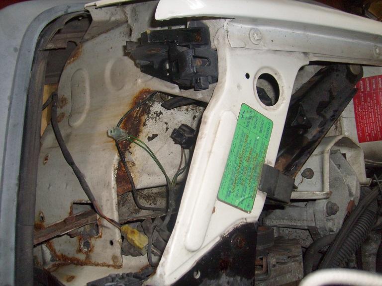

the front inner wings
So the front is looking good be the back boot.......... um...............

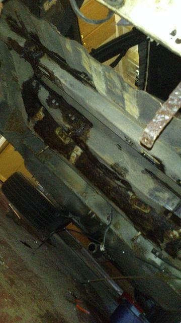

So following the removal of the rear beam and fuel tank the usual spots behind the tank looked good.
Rear beam in the garden so as its out its only right to rebuild it!! More money :)

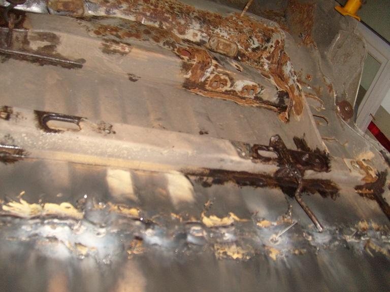

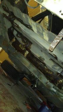

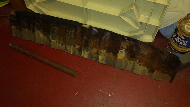

So a good and and wire brush was in order. On further inspection and a little poke, the boot floor was proving to be a rust mine field with holes etc!!
so the rust had to go and the cutting starts!
boot corners
And finally the hole back strip needed to go as it was too far gone :(
heres the section cut finally
apologies but my camera filled up so phone pics. not the best showing the hole

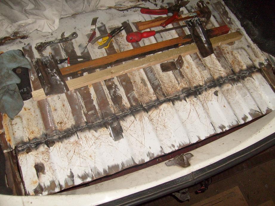

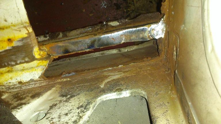

Well another Sunday in the man cave with Sefan :) he welded in a good bit of a boot floor from another 205. Couldn't really help weld but I'm good at cutting things now :)
underside shot
I gave the welds a code of oxide primer for protection until its all done and seam sealed up :)
So this weekend we may have the floor fully finished so we can find a few other jobs to keep us busy!! I'll get some more pics once the floors done.
damo

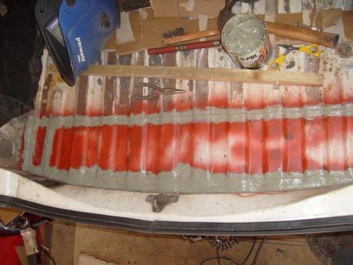

Another weekend with Stefan round welding. Big thanks again and I now have a boot floor :) (Stressing over!)
Here is the boot floor finished and the welds oxide primed
Then seam sealed

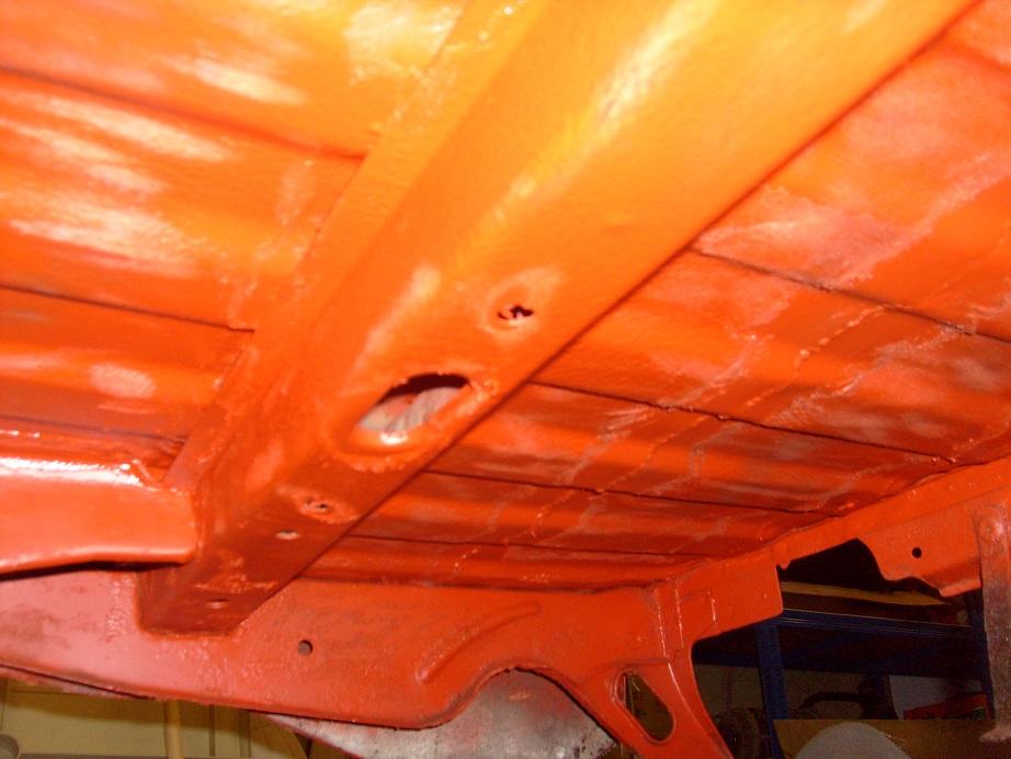

Finally got out during the week and wire brushed all the rust with the grinder
Petrol tank area
other underside shots with a fresh coat :~)
Finally a mucky pup although I look rather clean!
So next job it to etch prime everything then paint it all with rust proofing primer and a coat of hammerite. Well 3 or 5 coats :)

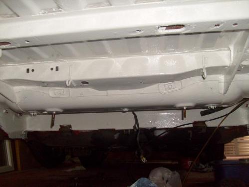

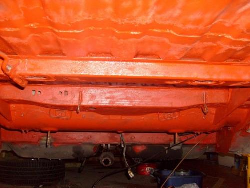

Been busy the last two weeks :)

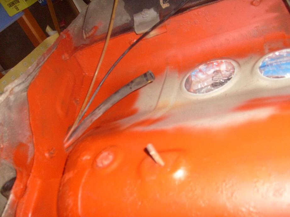

so the boot under floor and tank area got etch primed and 3 coats of hamerite (messy stuff to paint on and time consuming!)
finished finally

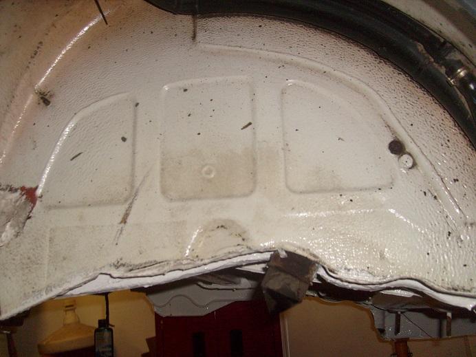

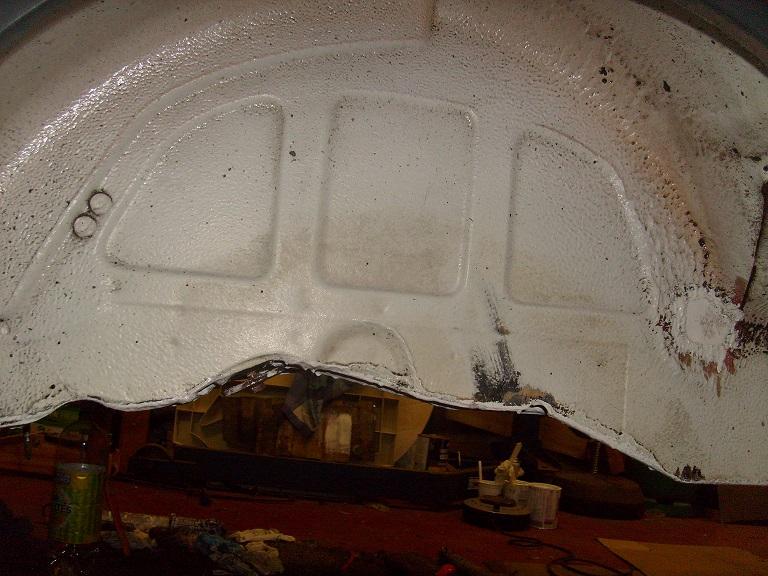

Cleaned the wheel arch both sides to give a paint over at some point when touching up underneath after fitting the brake lines and fuel tank back.

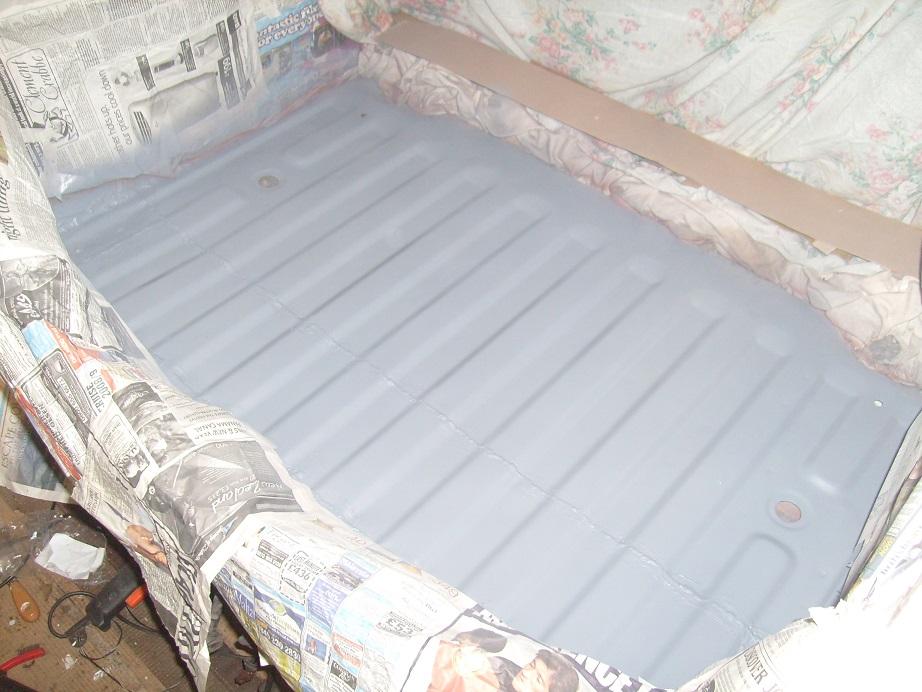

Inner boot floor prep -
Final primer coat before painting :)
So all left for over 24 hours to go nice and hard before sprays :)
Underneath took too long painting and drips everywhere so next time some spray method is in order!
