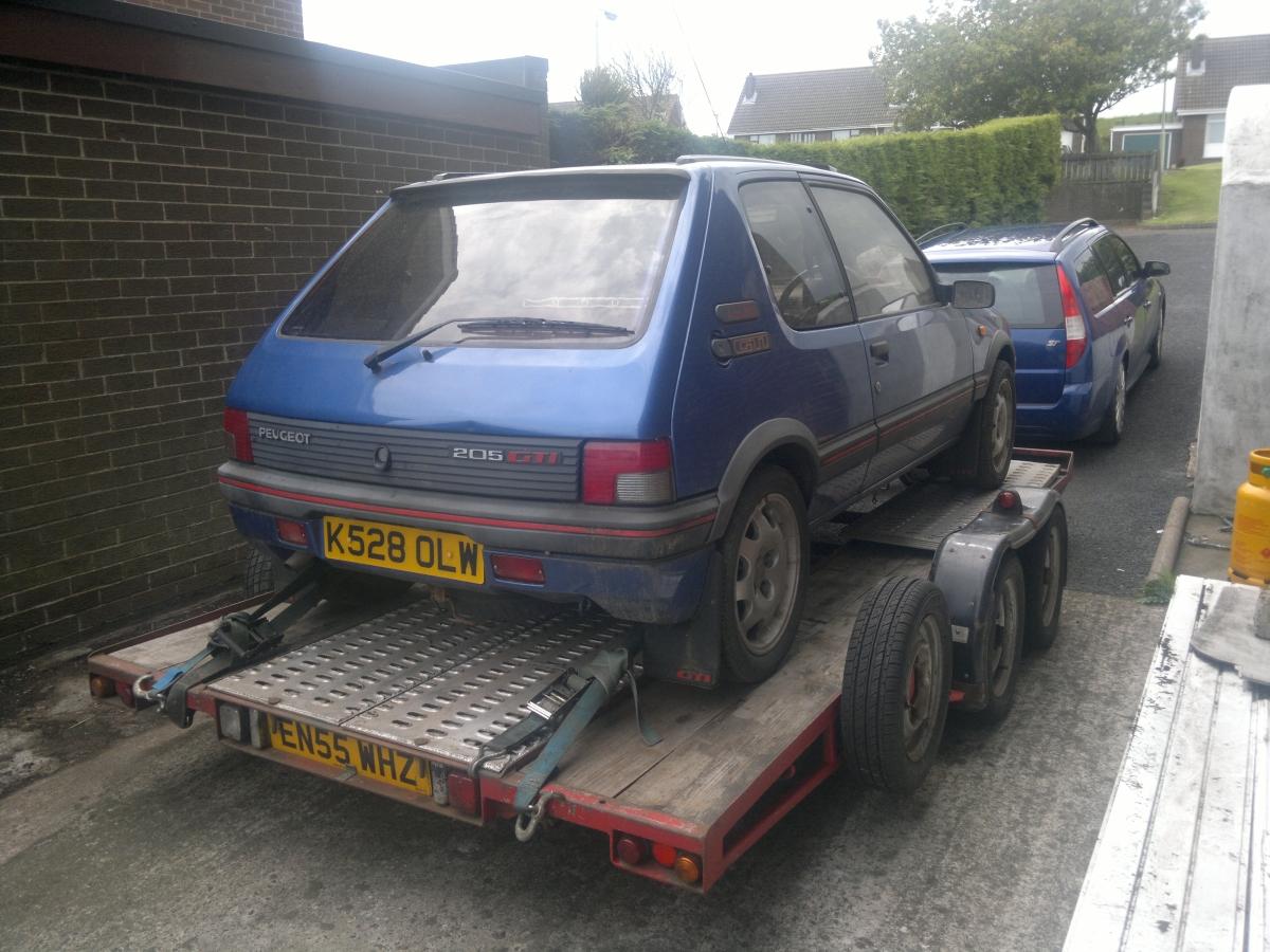

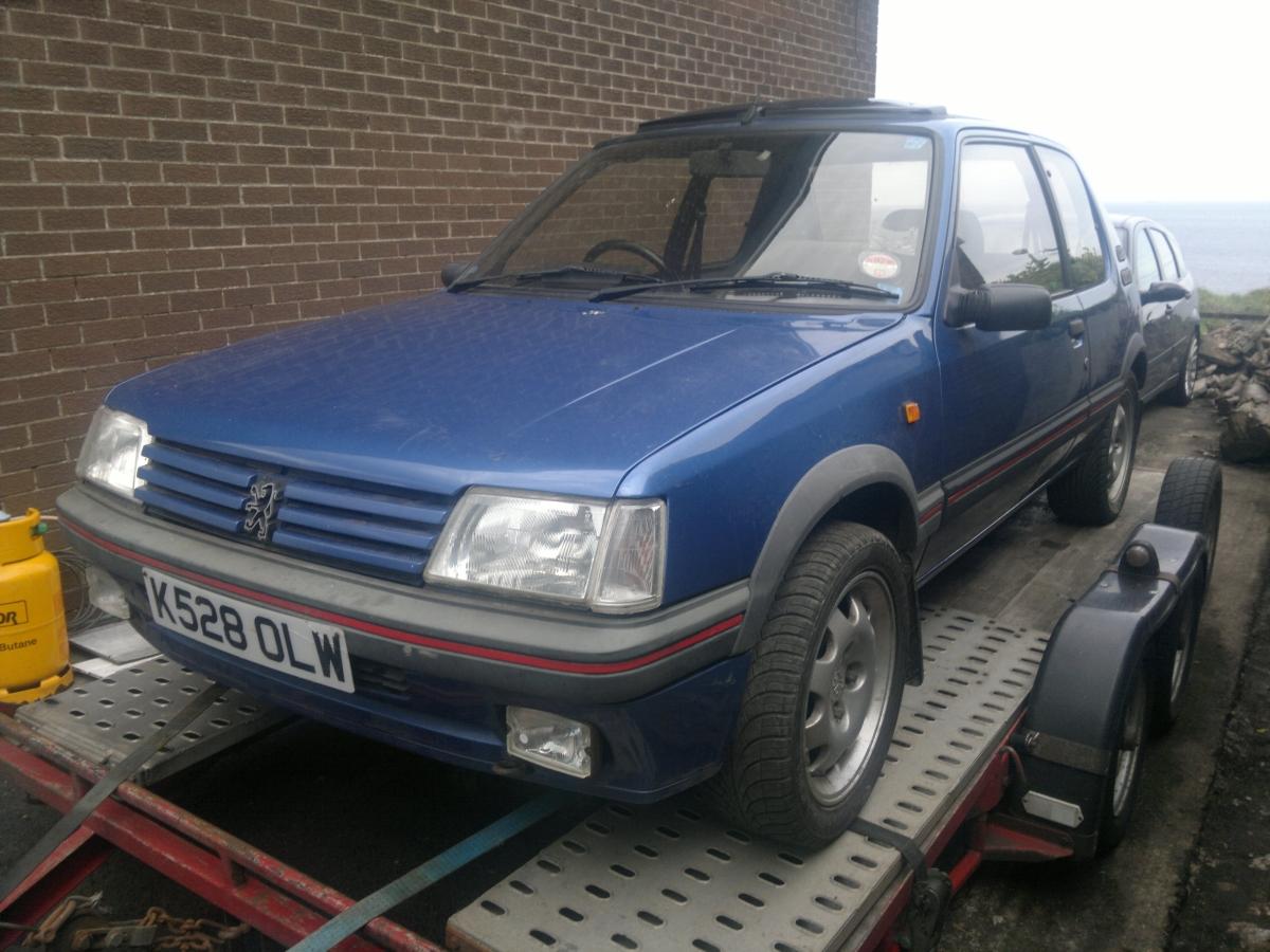

Here goes on the my 1st proper post, introducing the latest purchase, how it's came about, and what the plans are for it.
I'd been looking out for a GTi for quite a while. I was mainly interested in the later Ph2 cars but wasnt worried whether it was a 1.6, 1.9 or Mi16/GTi6 converted , just wanted somthing in reasonable shape, that hadnt been butchered or chavved out. Although 205 GTi's are relatively common (well, relative to the old, rain soluble Fords that Iā€™m used to) being located in N.Ireland seemed to limit my choice a little. After viewing a few, I did eventually come across a 93 sorrento green 1.9 advertised in Dublin, so after a quick run over the border, a look around and a nights pondering, I rang the guy, agreed a price and went back down with the trailer to get it. Iā€™ll start another thread for ā€˜Miss Sorrentoā€™ later.
Ā
So, now that I had got my 1st GTi, how the hell did I end up with another one? I think itā€™s mainly down to this ā€˜bugā€™ Iā€™ve heard people talk about. I swear, I only went on to look for a steel water pipe, yet found myself watching loads of other parts and 205ā€™s. Then one Saturday night, the inevitable happened and I now had a road trip to Gloucester to plan. It had been advertised as dry stored since 05, solid, but hadnā€™t been running. The pictures werenā€™t great but the interior seemed pretty good (which for a cloth interior is impressive) and there was a set of genuine mud flaps on it (which seem to be worth a lot to some folk out there!) I didnā€™t remember / realize until after, that the words ā€œsold as a restoration projectā€ and ā€œwould make good project or rally carā€ were in there too!
So, a 33 hour / 860 mile non-stop trip via Stockport (had a friend who needed a trailer load of belongings brought over to mainland) and myself and the girlfriend were back home. Our plans for a relaxing trundle through the lake district on the way back up were scuppered by the motorway rush hour traffic. Instead we ended up grabbing a KFC in Kendal, getting slightly lost and doing a few laps of the one way system before getting back on track but having to race to make the boat. A bit of a shame because it really would have been a beautiful drive from what I could see out of the corner of my eye! As for the GTi, I think I got off quite lucky (open to honest opinions here by the way), Thereā€™s the usual small car park dents, the passengers door will need fixing and the near side inner wing has just about rotted trough in the usual spot. A few marks around the petrol cap along with a different key for the ignition suggests a theft (or at least attempted theft) at some point but apart from that the little car seems very solid and very complete. It has parts still there that I never seen before, or realized ever existed like the plastic cover for the hole in the gear box, and even a little heat shield on the gear linkage joint closest to the exhaust!
..Right, apologies for the speech, less words, more pictures..

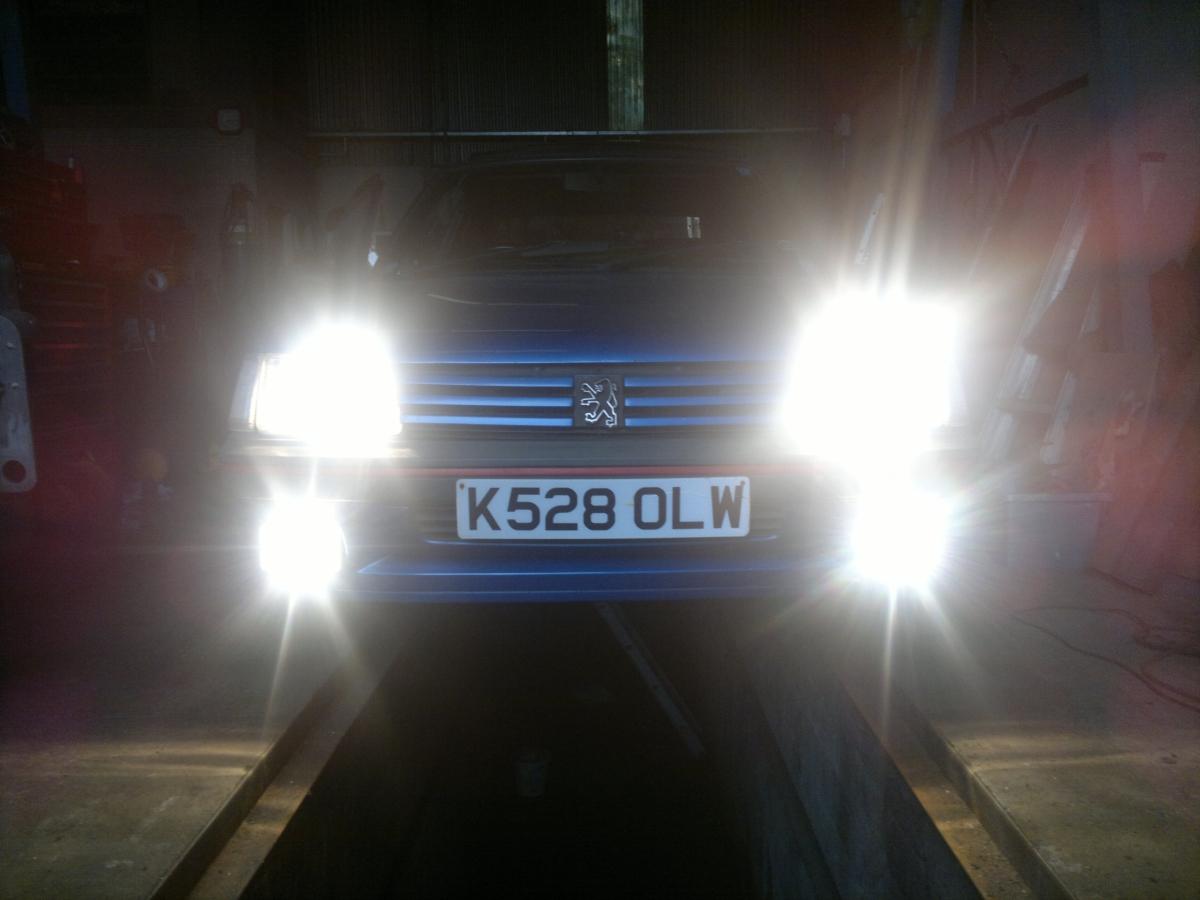

So, a quick update.
Ā

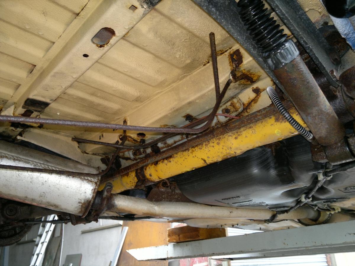

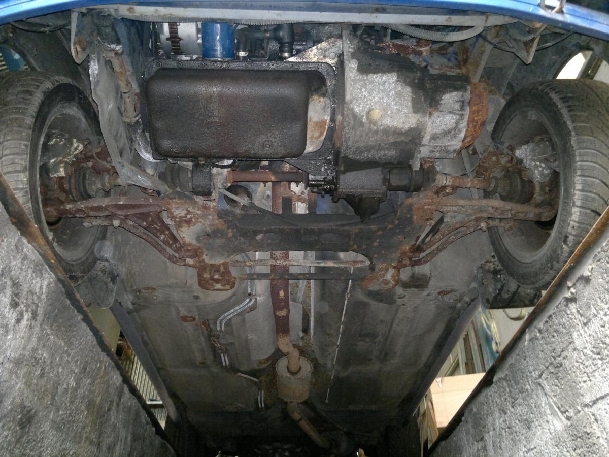

Got the car over the pit for a better look and am happy enough to see there's no major rot, just a bit dry and flakey in places. Should get away with a days scraping / wire brushing / rust proofing / painting. I really dont want to have to remove the tank or strip the rear beam at this stage otherwise there's a risk it'll turn into a full strip down etc and just end up sitting beside the other half finished projects. I'm sure some of you know that gut wrenching, no light at the end of the tunnel feeling with different projects in different states of repair / dispair. :( The plan here was / is to get it roadworthy, get a few summer months driving and tease out any gremlins, then sort them out along with a beam refurb during the winter months.
Ā
Ā
Ā

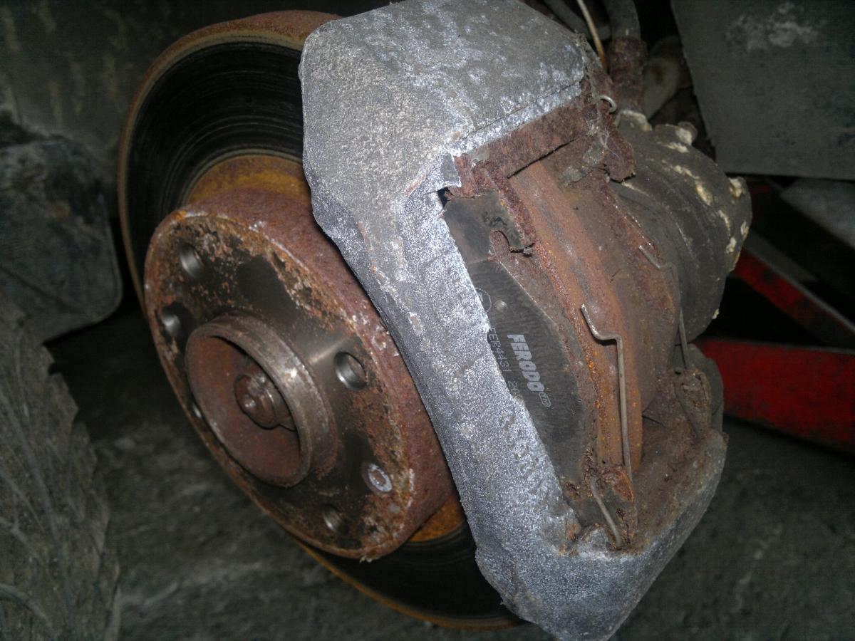

Also, turns out there's been new brakes all round (rear drums still have the paper stickers on)
Ā
Ā
Ā

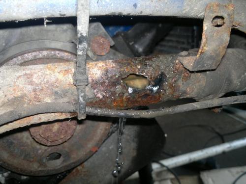

Removed the timing belt and water pump and, sure enough, the water pump sounded noisy just spinning it by hand. So fitted the new pump and belt kit and all seems well. As it turns out, the carā€™s fitted with the late type eccentric tensioner and 114 tooth belt. I had noticed the black plastic belt cover when I first opened the bonnet but never thought anything more of it. Iā€™d always just assumed (wrongly!) that the late type tensioner belonged to the later Motronic managed 1.9ā€™s. :huh: However, after a quick search here, I found thereā€™s a few people have came across this on a 1.6.. you learn something every day eh!
Also, the inner guard pipe looked very scabby but hadnā€™t shown any signs of leaking, until a gentle tap with a screw driver changed that! I had gotten a ā€˜new old stockā€™ one for the other project so it was nicked and put on.

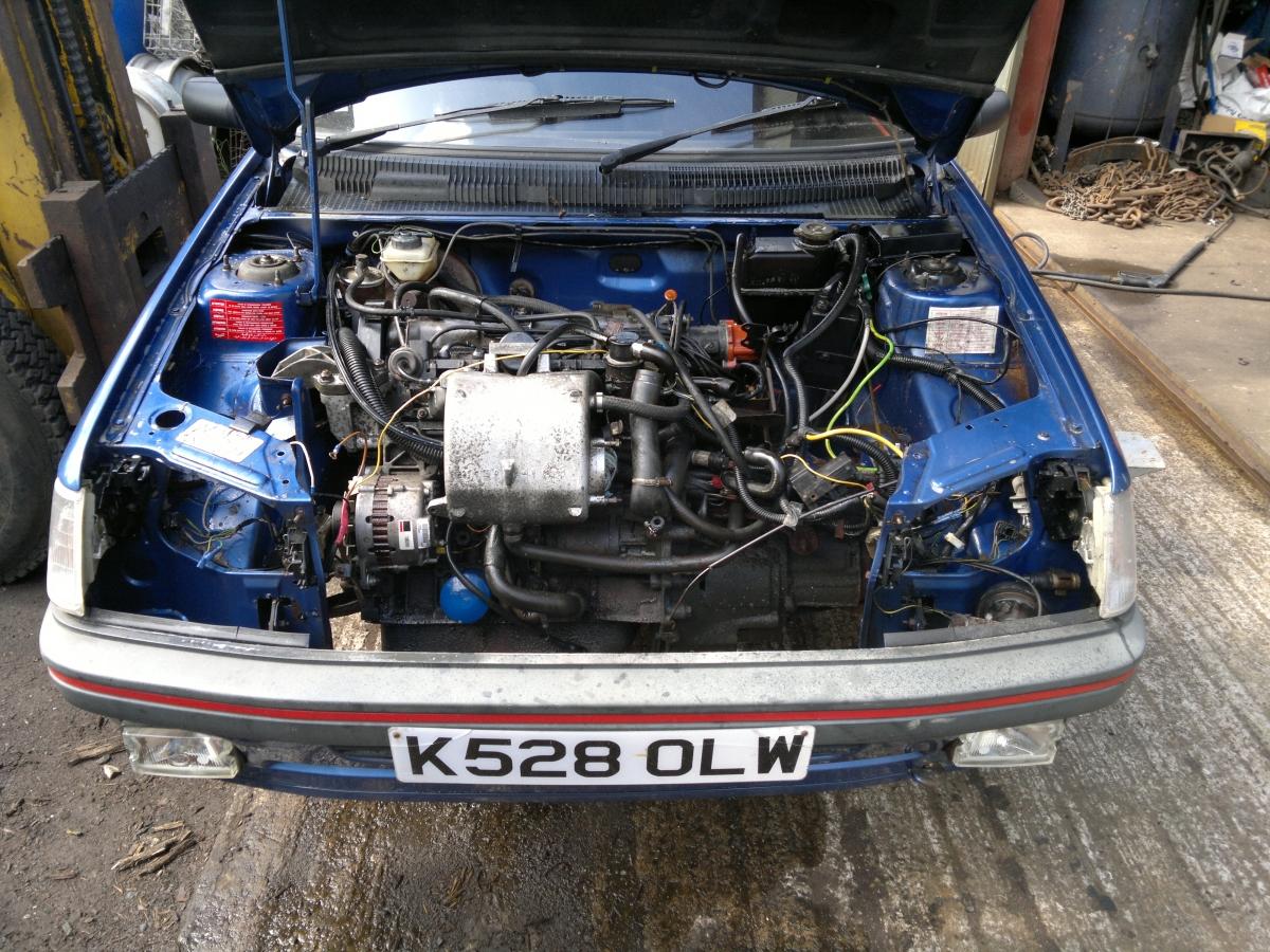

I decided the next job would be to give the car the forklift / power wash treatment to clean underneath and in around the engine and box. I find itā€™s a lot easier to spot fluid leaks at source when everythingā€™s clean and grime free.
As the air flow meter and throttle body would be removed for cleaning anyway, I took them off at this stage to get power washing the engine and box. The radiator wasnā€™t leaking, but I reckoned efficiency may be down slightly (you could have posted letters through parts of it where the fins were missing! :o ), so it came out to help the cleaning exercise too!
Ā
Ā
Ā
I didnā€™t remove the fuel tank, but in hindsight, wish I had as Iā€™ve since decided to renew the fuel and brake lines and will be bringing the tank out afterall. :angry:
A few ā€˜beforeā€™ and ā€˜aftersā€™ā€¦
Ā
Ā
Ā

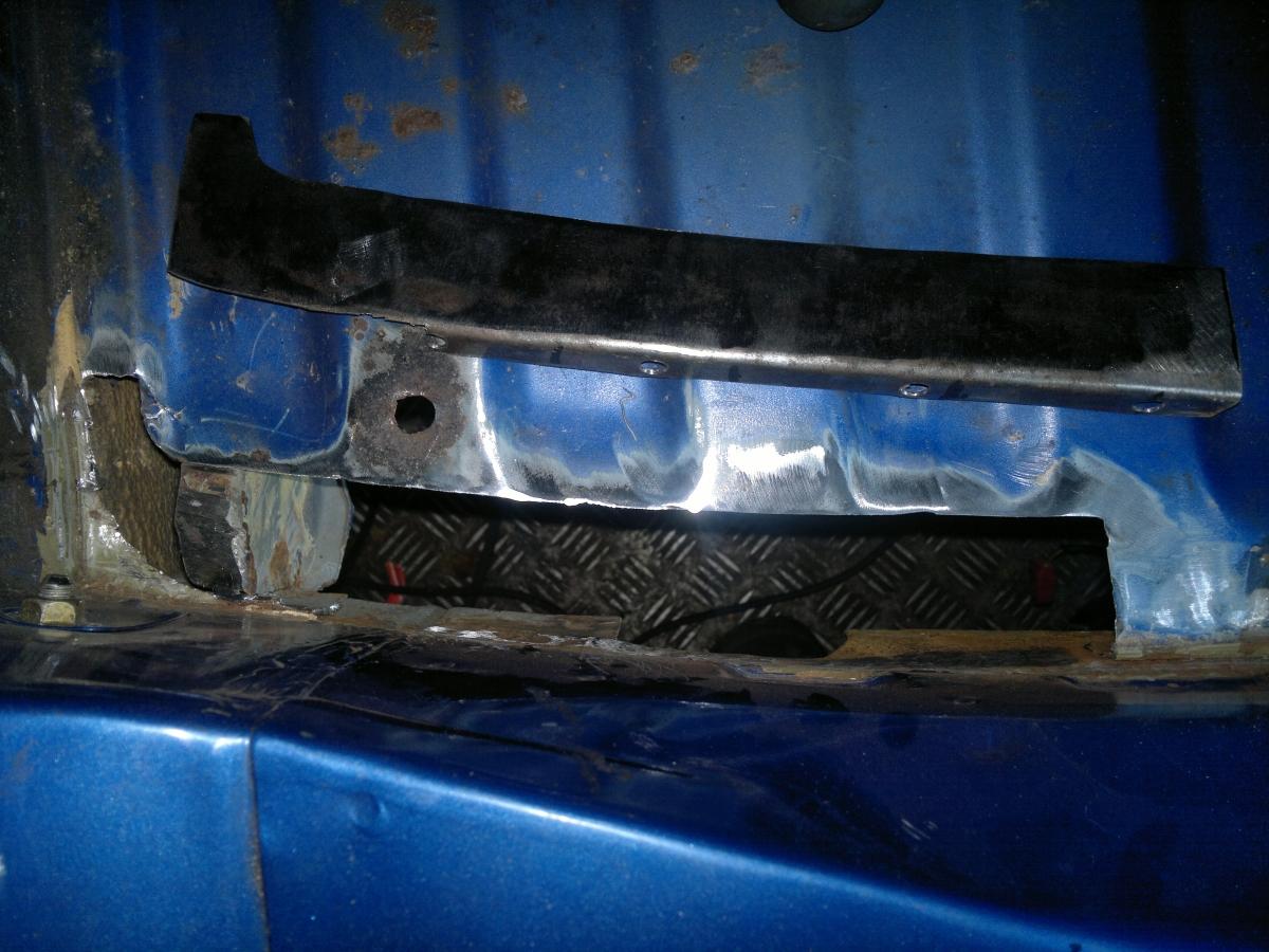

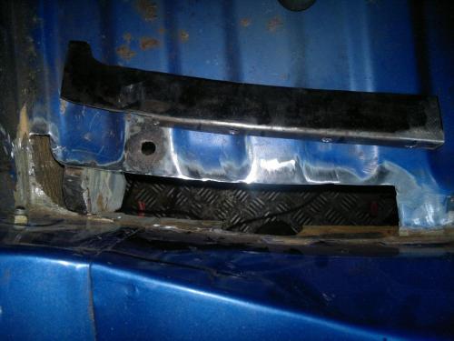

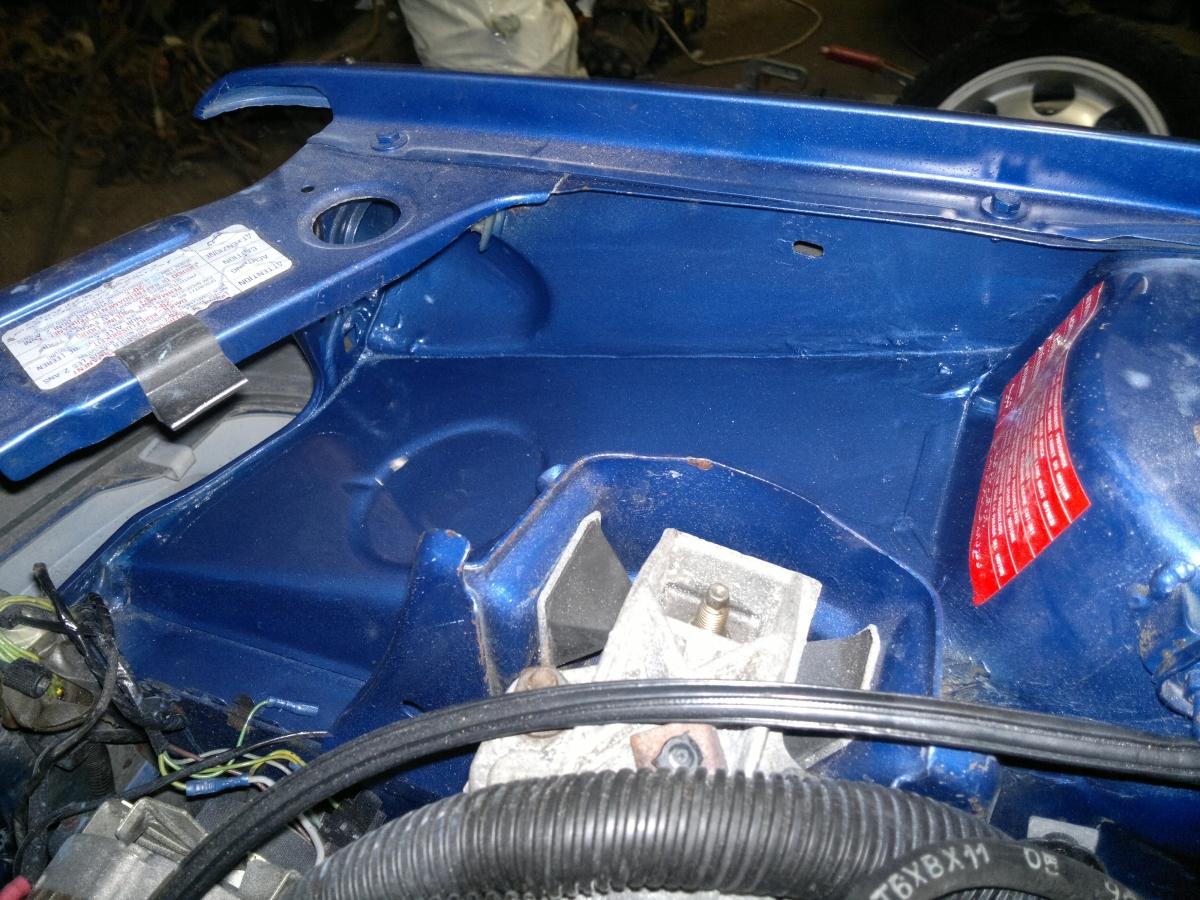

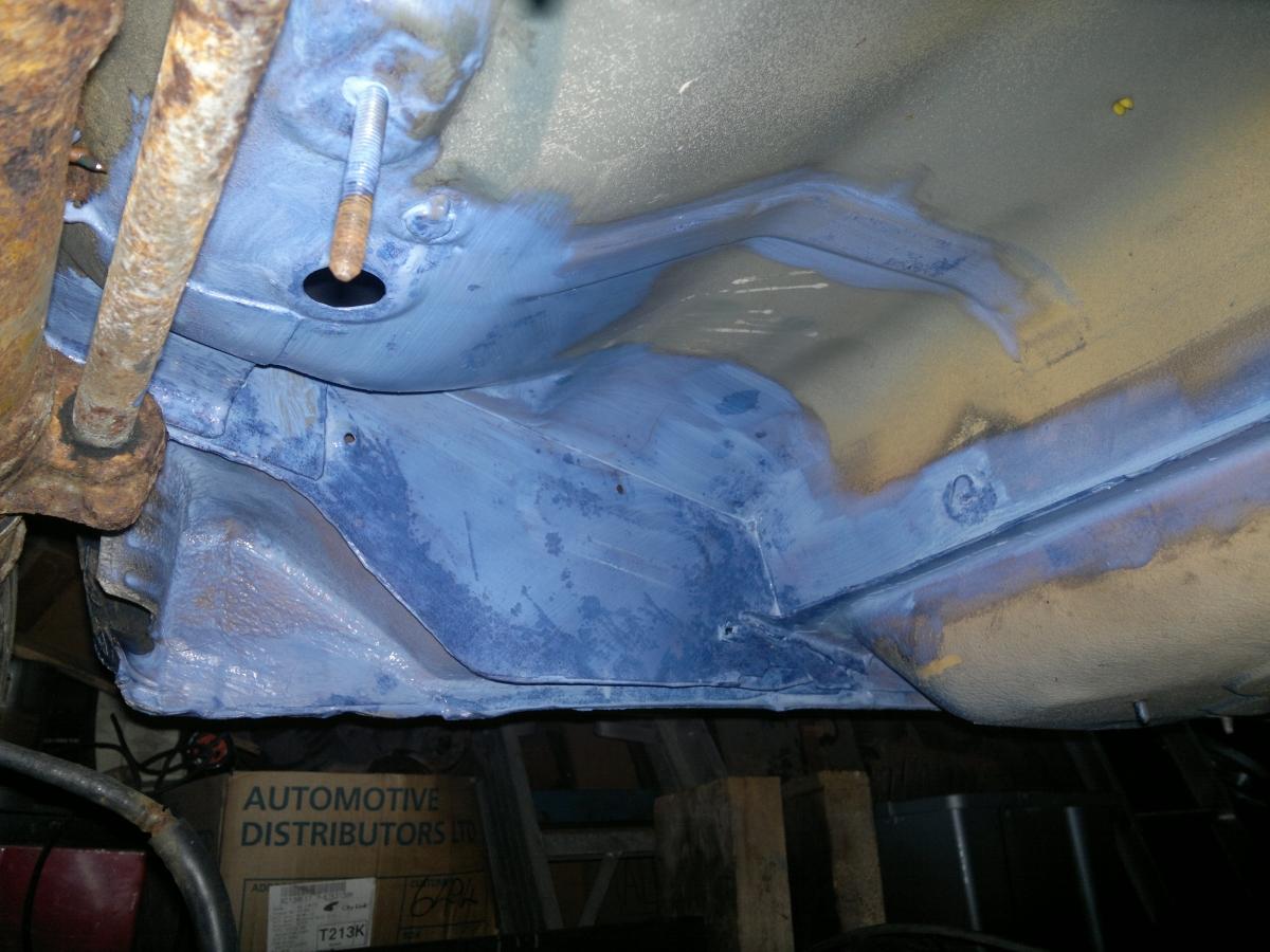

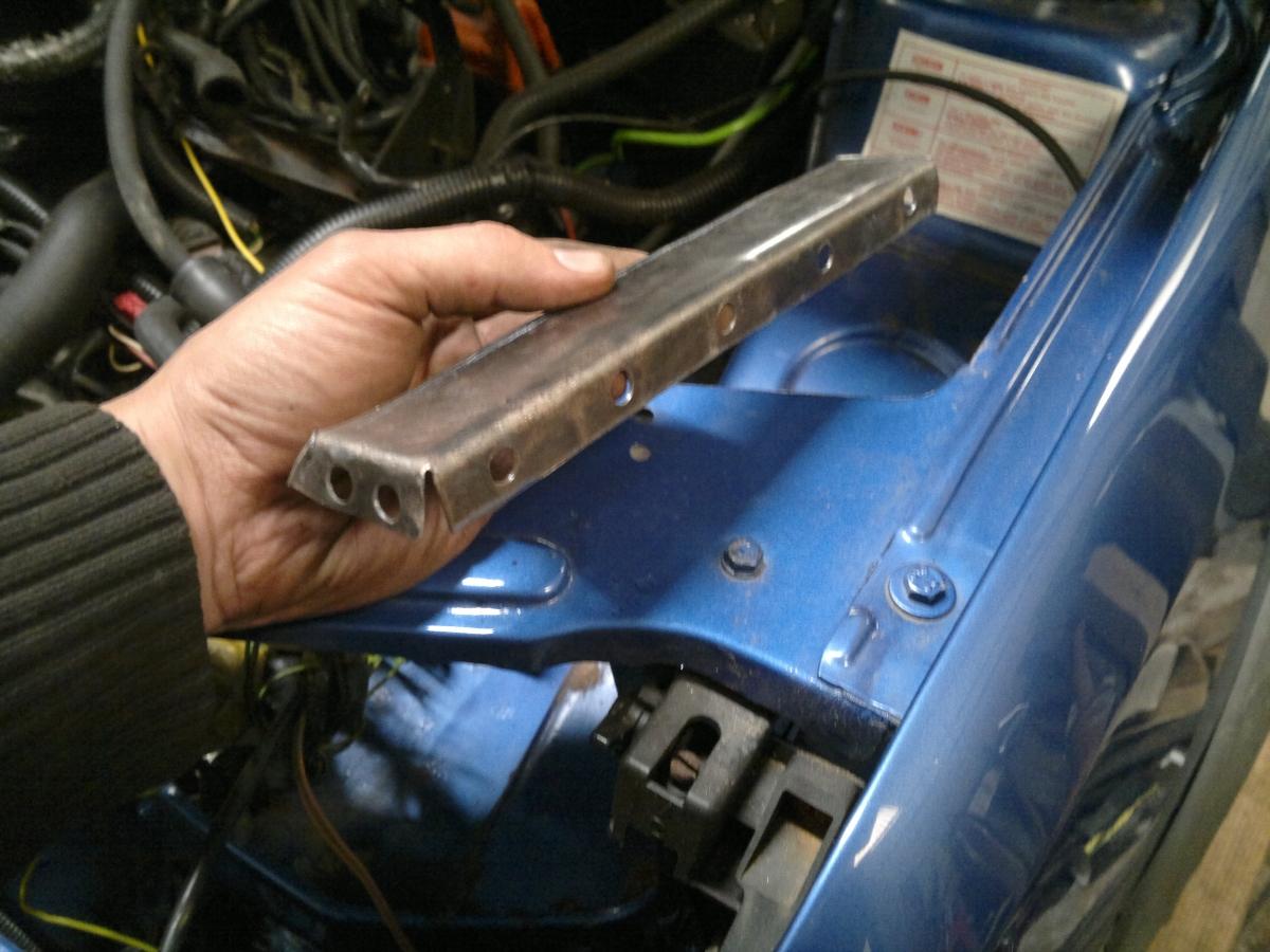

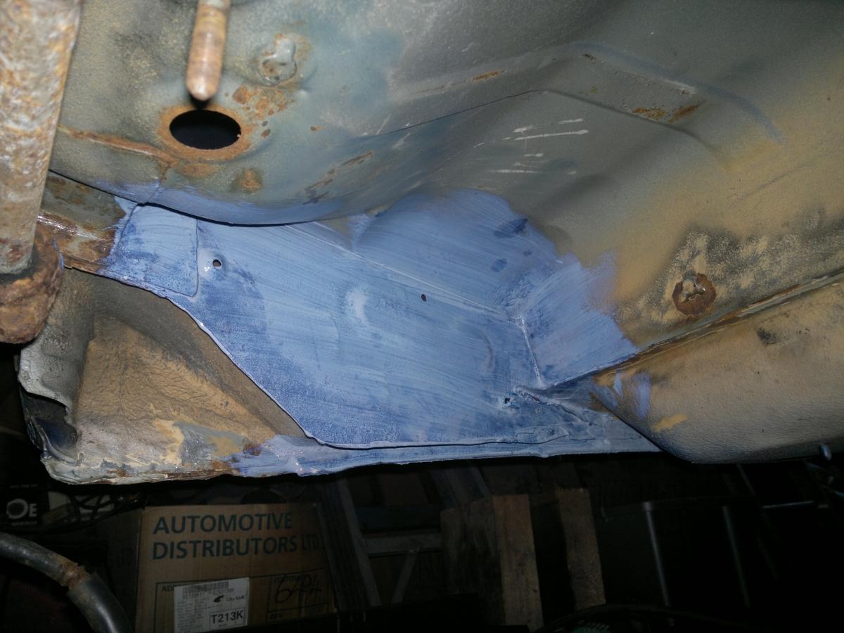

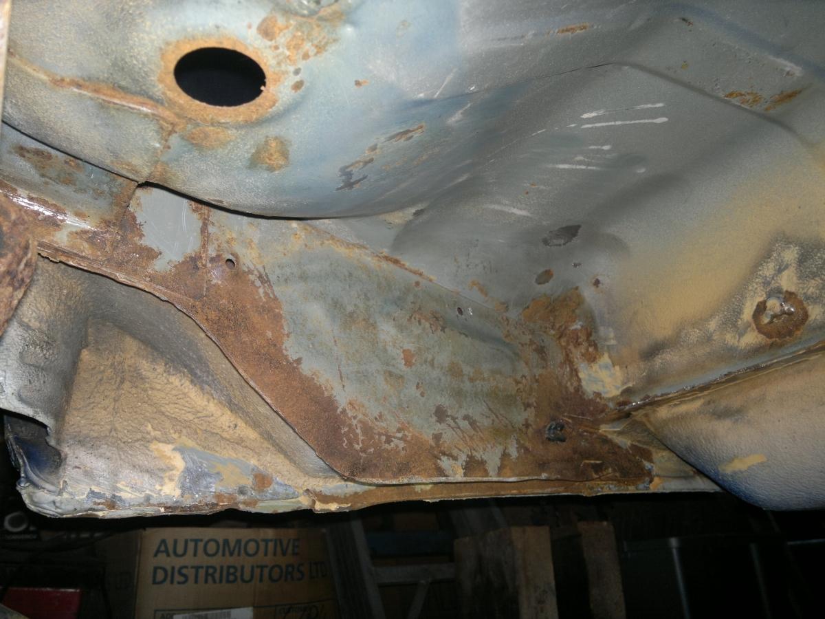

Next I thought Iā€™d tackle the N/S inner wing repair. Iā€™d given both sides a bit of a scrape etc before the power wash and was happy the O/S was still sound.
Ā
So after a bit of cutting, cleaning, folding, welding, buffing, priming, filling, flattening, priming again, base coating and lacquering, the two inner wings were a bit more presentable! Iā€™m guessing some people will be thinking ā€œWhy didnā€™t you stick some seam sealer on while you were there!?!ā€ā€¦ I was 50/50 on the ā€˜better rust proofed vs more original lookingā€™ thing, and just went without sealer in the end. The car will mostly be kept inside and probably SORNā€™d in the winter months. Thatā€™s not to say it will never see dirt or water, but it wonā€™t be getting the same abuse or neglect as the old daily driver for example.
Ā
Ā

johniban
where did that bit of metal go you made up?
Davy
Ā
Apologies johniban, the picture of the repair piece is from the oppostie angle as the picture below it. The 2nd picture is standing at the passengers headlight, facing into the engine bay, and the repair piece in it's correct orientation for fitting. I wanted the repair to look as original as possible so bent a 1/2" web downwards to spot weld to the original vertical panel of the inner guard which was still sound. The same with another shorter web to spot to the front panel.
Ā
I know it's a bad design as it's a water trap, but I've primed, sealed and stone chipped the underside, and put a very fine filling of seam sealer along the top side along with a few heavy coats of primer before the final coats of paint so here's hoping it lasts.

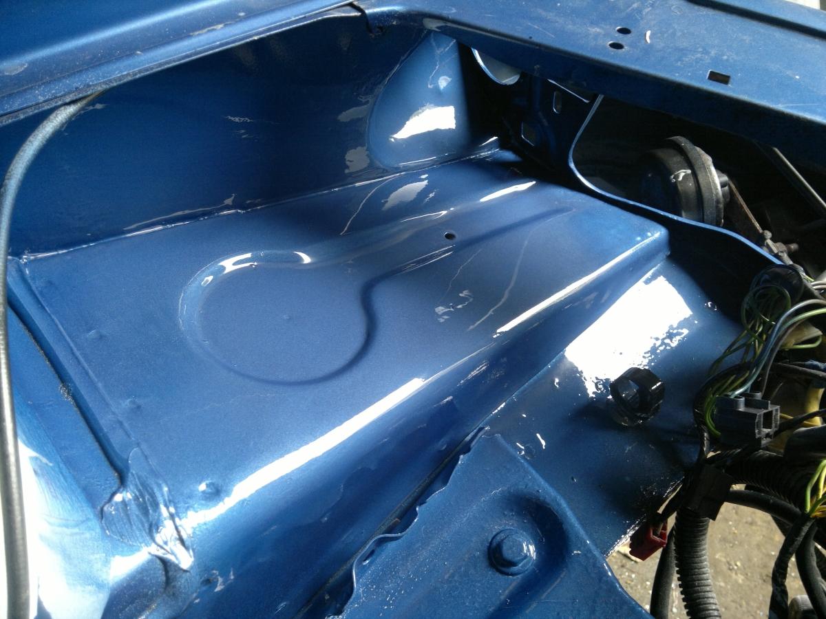

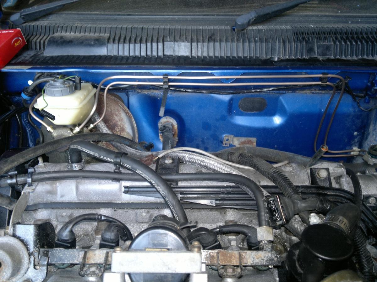

OK, so feels like only a small amount of progress given the time thatā€™s passed but better put something down while itā€™s in my head. Having to run through pictures to remind myself what Iā€™ve done!

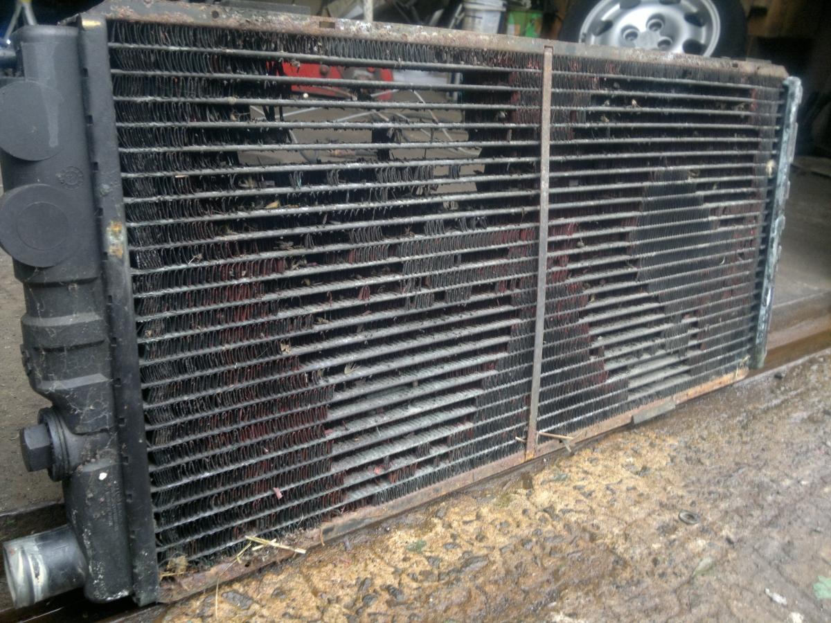

The front end is all back together with new radiator, hose clips, new horns and everything going back together with a quick clean, and nuts and bolts oiled or greased along the way. The two earth points either side of the radiator were a bit corroded looking so were unscrewed, cleaned up reassembled.
The AFM was tested using the guide on here (tho I think the pin numbers may be numbered the wrong way round?..will check again) and was cleaned along with the throttle body and put back on. I didnā€™t put the two water pipes back onto the bottom side of the throttle body as I personally donā€™t see how it would make much difference. Is this some attempt at a heater for cold climates? :huh: Even so, I donā€™t see that it would be that effective as it just seems to meet at a point on the base rather than have water flowing around the body? Strange! Instead I saved a tiny bit of space and ran the header tank pipe straight to the thermostat.
Ā

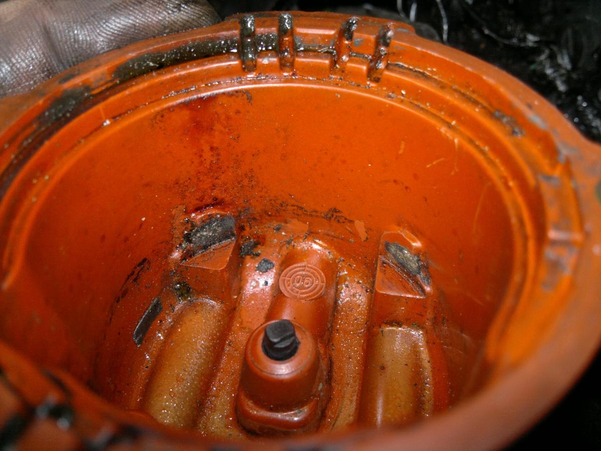

I had a bit of bother sourcing the correct dizzy cap (even GSF couldnā€™t get one), but eventually got one off Ebay after cross referencing the part number.

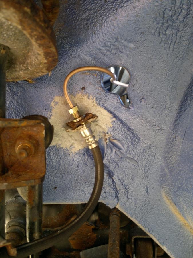

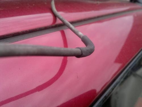

I got the original steel brake pipes removed without having to bend or distort them too much so was easy enough to shape the new kunifer pipe using the old pipes as patterns. Itā€™s been a while since Iā€™ve made up new pipes so had forgotten how you donā€™t get to reshape the pipe much before it work hardens. I tried to get one of the pipes shaped ā€œjust that little bit betterā€, but ended up making it worse, getting frustrated, scrapping it and starting again! :angry:
Ā
I shaped them slightly differently at the master cylinder just to what I thought looked a bit tidier. The rear brake pipe originally crossed over the reservoir to the rear, o/s port of the master cylinder but Iā€™ve swapped it to the n/s. Iā€™m not sure why they would have been plumbed like this originally!?... (This is when someone educates me as to why, under no circumstances must you ever pipe the rear to the n/s port, and that Peugeot did this becauseā€¦)
:huh:
I had been thinking about putting adhesive lined heat shrink over the pipes but decided against it in the end. I think the kunifer piping will last more than long enough, and although it may dull a little, it wonā€™t corrode like steel. I tried a piece of 6mm adhesive lined heat shrink on an old piece of pipe as a test and found the extra layer made it a lot harder to push into the clips, almost enough to cut through the heat shrink anyway!
One thing bugging me about the new pipes is the longer type male fittings Iā€™ve used. Theyā€™re just what came with the piping, but Iā€™m wishing Iā€™d gotten some of the shorter ones to be a bit tidier! Ah well.
Ā
Iā€™ve only piped down to the compensator for now as the underside would need some tidying first.

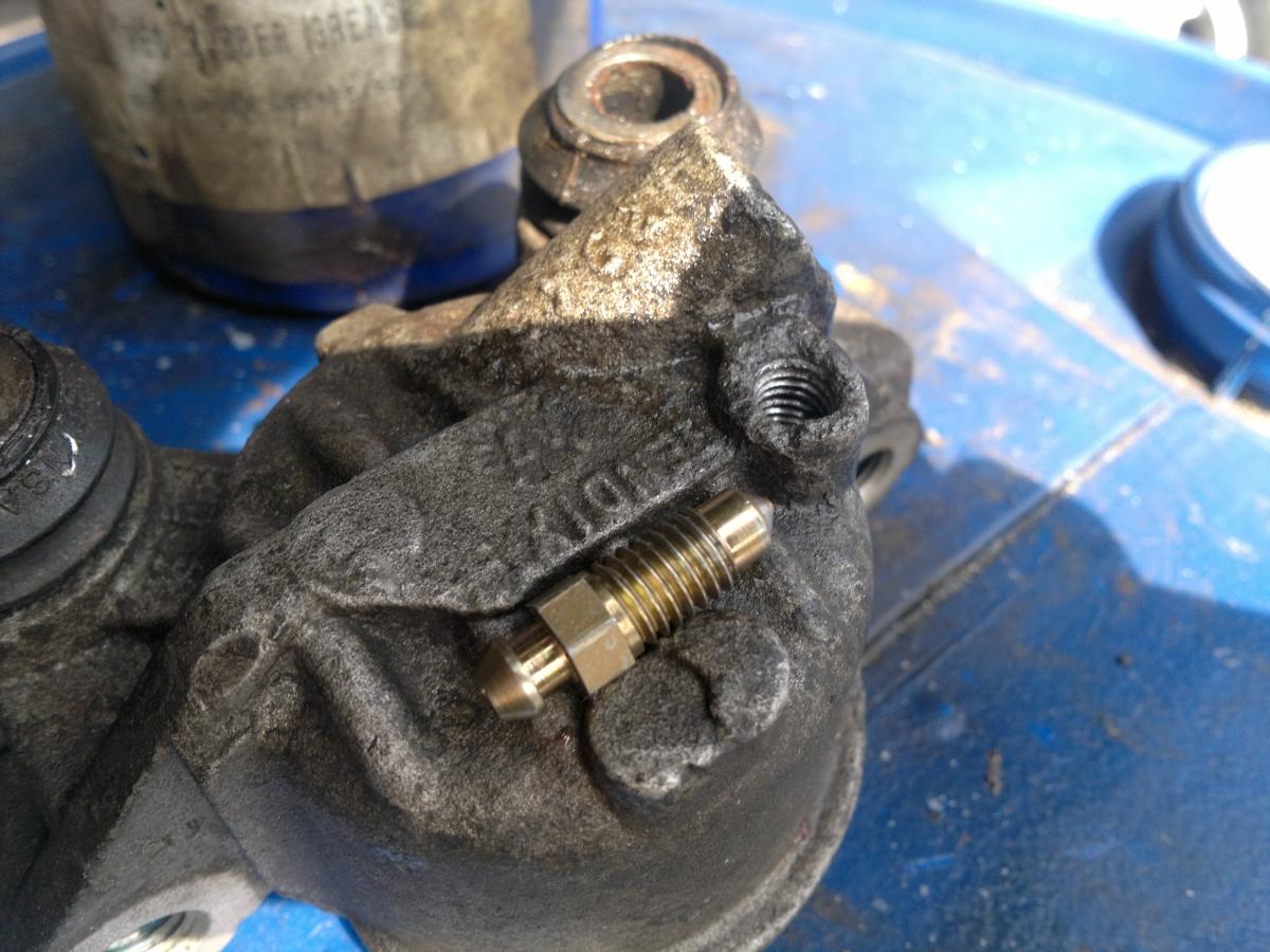

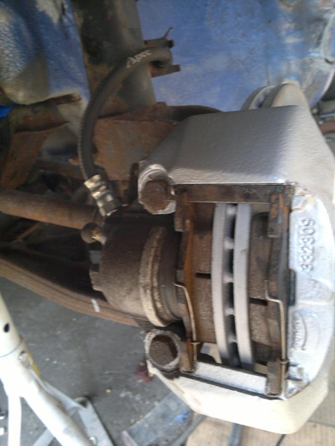

Next up were the front calipers. They were a bit sorry looking with a lot of alloy corrosion but all the rubbers seemed crack free and supple enough so I thought Iā€™d strip them and try cleaning them anyway.
First obstacle here were the 5 sided bolts holding the pad carrier to the alloy body, so rather than try to hammer some ā€œclose fitā€ socket on, I decided to take the more chilled out, proper approach and just spend Ā£6 on the right socket and wait a few days for it.
I then went to take the pistons out. The brakes had been binding and Iā€™d had to lever the calipers off the discs so didnā€™t even try the airline trick for fear of taking down a low flying aircraft, ^_^ or maybe even injuring myself! Instead I went for the slow and steady (but messy) grease gun method. Even then the pistons were pretty tight to push out and once out, one of them had a few scores on itā€¦Great! Iā€™d remembered that there should have been a pair of calipers ā€˜stored safely somewhereā€™ from my straight diesel Junior days so I set off in search for them in the hope that piston diameter might be the same. I actually found them quite quickly and sure enough, from what I could measure, itā€™s the same caliper, the only difference being the wider pad carrier on the GTi to suit the vented disc (Maybe someone can confirm or correct me?) .
So, out of the four bleed screws, one unscrewed ok (but that caliper had crap rubbers!), one sheared, and two brought the alloy threads out with them. I had plenty of 10mm bleed screws, but decided to source some 8mm ones and try them first as there was still enough alloy to achieve a good 8mm thread. Iā€™ve never tried boring and tapping a caliper for a larger bleed screw and was worried I wouldnā€™t drill concentric enough to get it to seal or something, but it all seemed to work ok. I tried a gentle pressure test once the calipers were built and soapy water didnā€™t show any bubbles so hereā€™s hoping.
The other issue I had with the calipers was the sliders. I removed and cleaned them to a shine, removed the rubber o rings from inside the calipers and cleared all six grooves of crime and corrosion and built them up again with rubber grease, but they were a bit too tight for my liking. When stripping the four calipers, I noticed one didnā€™t have the o-rings for the sliders, so I tried them again without the o-rings and I much prefer the way they feel now (free to slide but not rattling about). Iā€™ve decided to leave the o-rings out for now. Has anyone else found this? Anyone else binned the o-rings too?..or is this another predictable mistake?
I didnā€™t put too much effort into tarting the caliper bodies up as Iā€™d rather see if theyā€™re going to work first (no point in standing polishing scrap!), so a quick coat of VHT silver on the discs and pad carriers will do for now!
I assembled the pads in the orientation they were taken out. Can anyone confirm if the pads are 'staggered' the correct way?..i.e outside pad lower than inside pad. Whats the reason for this? The only thing I can come up with is that, because the caliper sliders 'carry' the pads, then this stagger counter acts the tendancy for the caliper to twist on the slides when it grips the disc?.. :huh: or am I away off overthinking things? :blush:

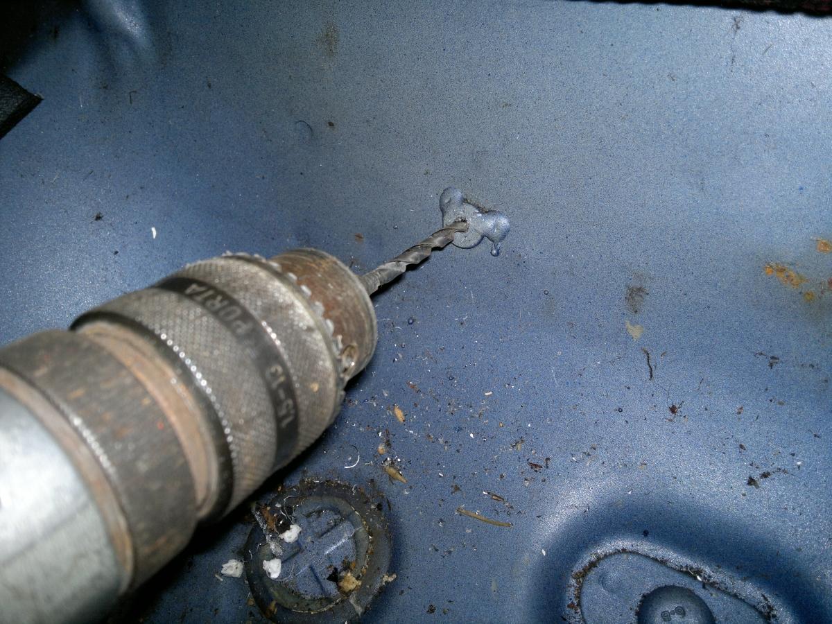

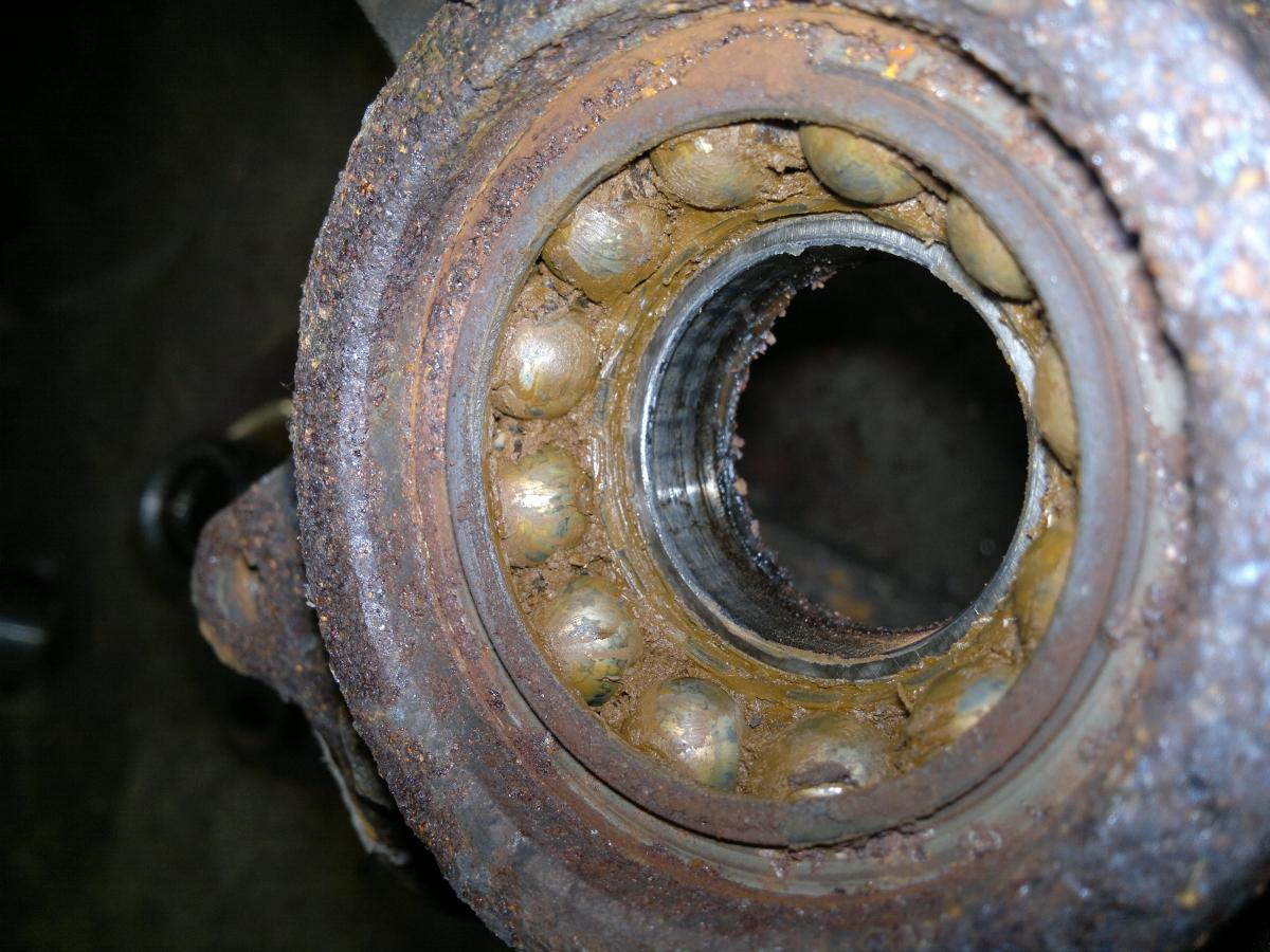

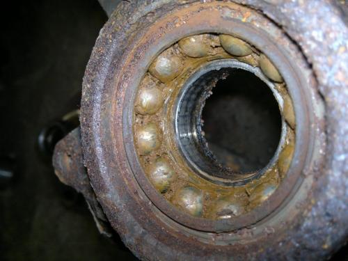

Back when Iā€™d first prized the calipers off, I stuck the front wheels on quickly with a couple of bolts to check wheel bearings and the drivers one was noisy so have replaced that. I donā€™t have access to a press so it was a matter of placing the hub on a block of wood and sledge hammering the old one out, cleaning and greasing everything and squeezing it all back together in two stages with the vice.
The old bearing had definitely seen better days.

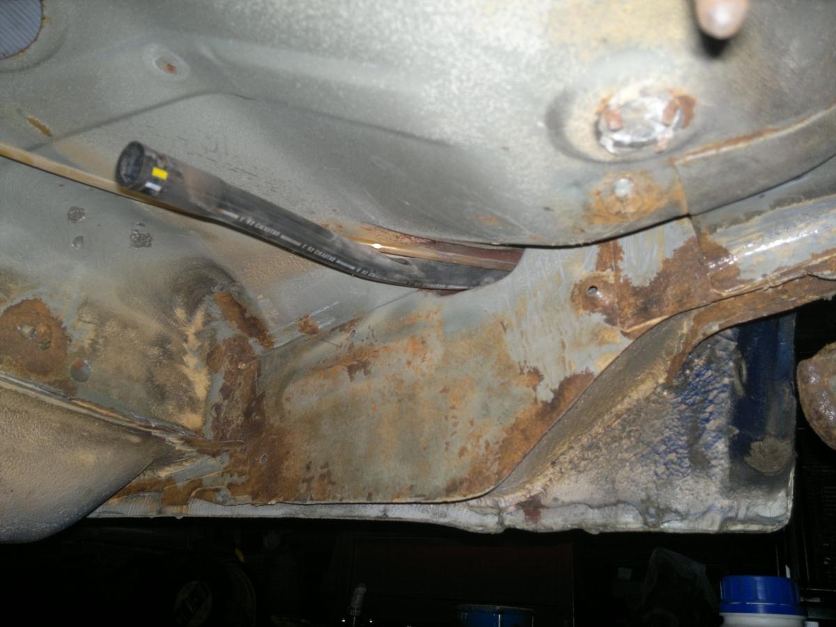

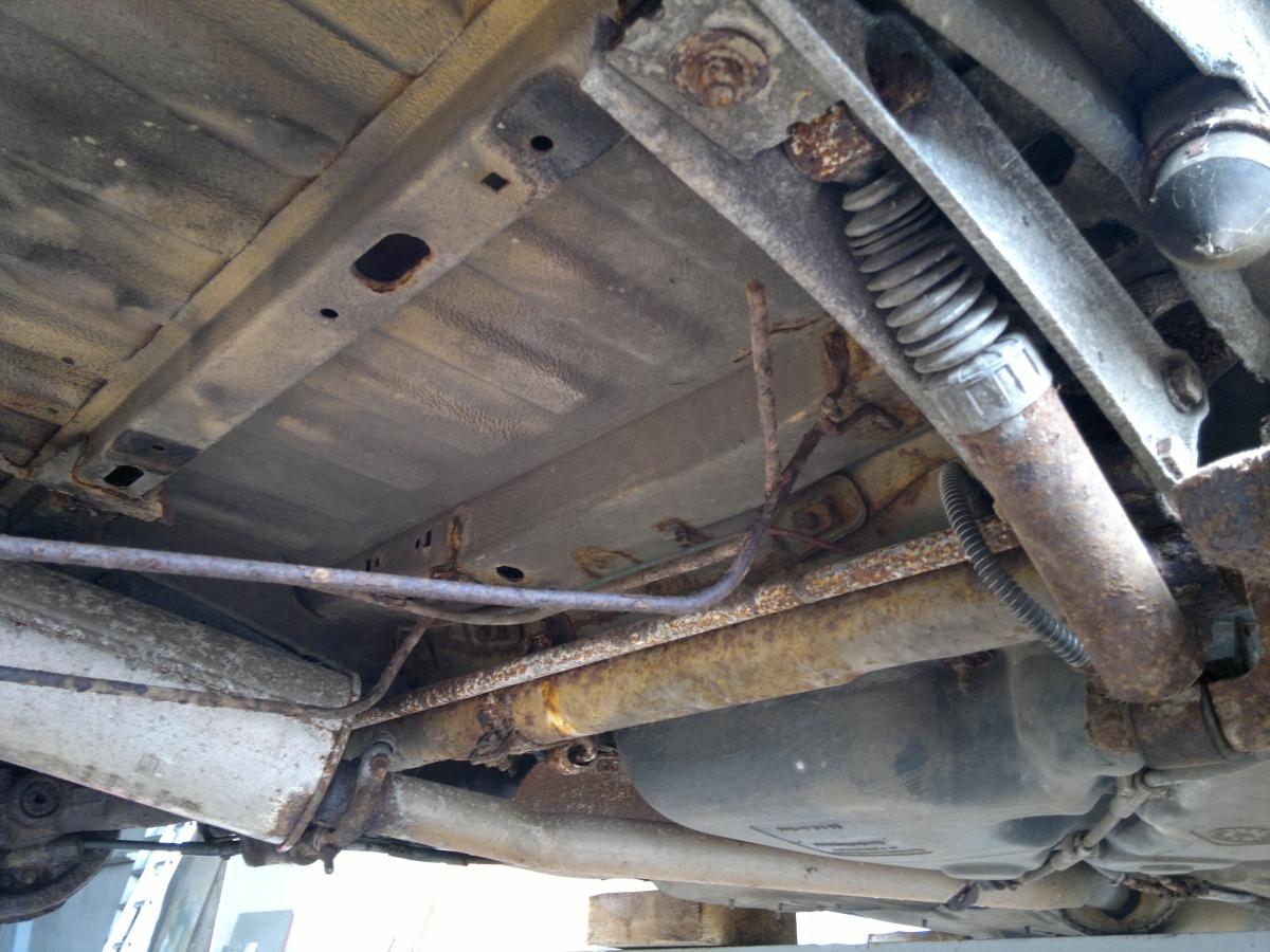

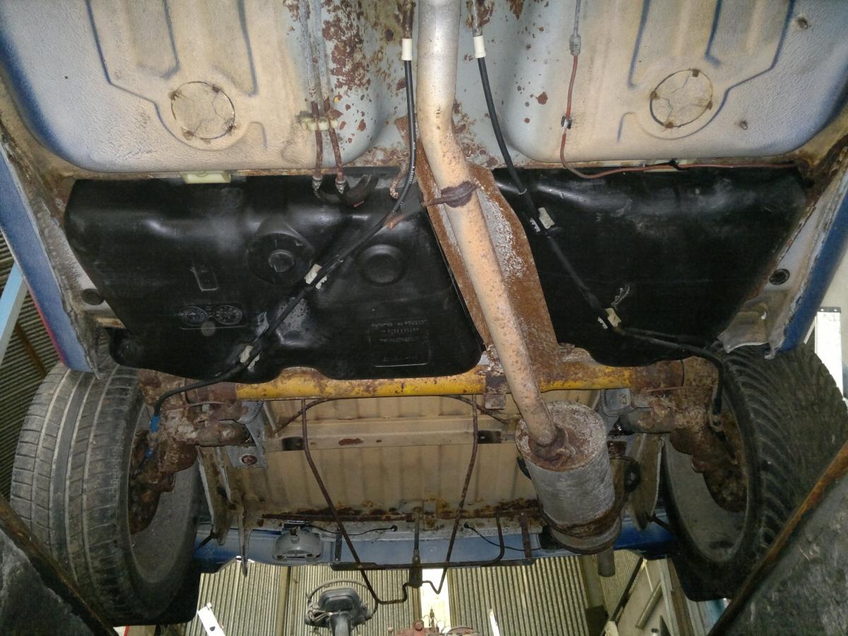

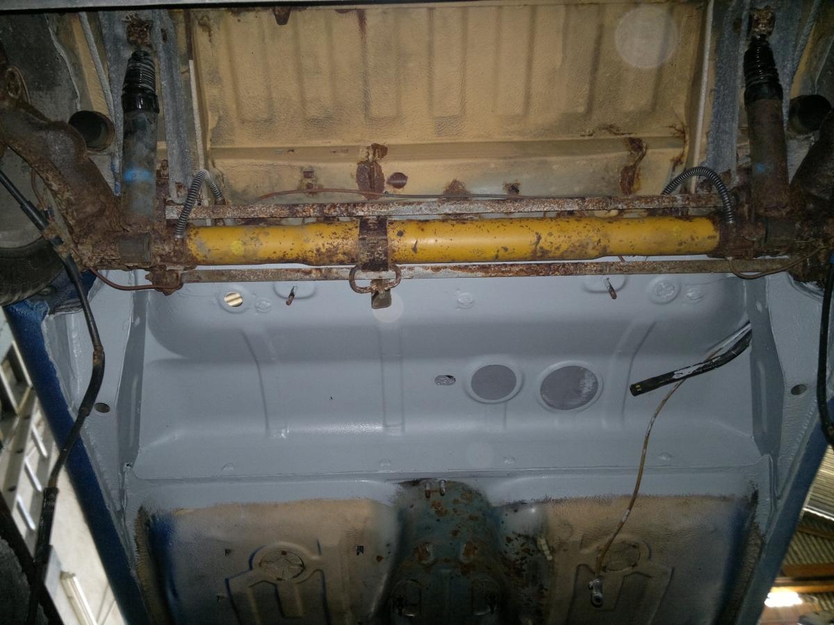

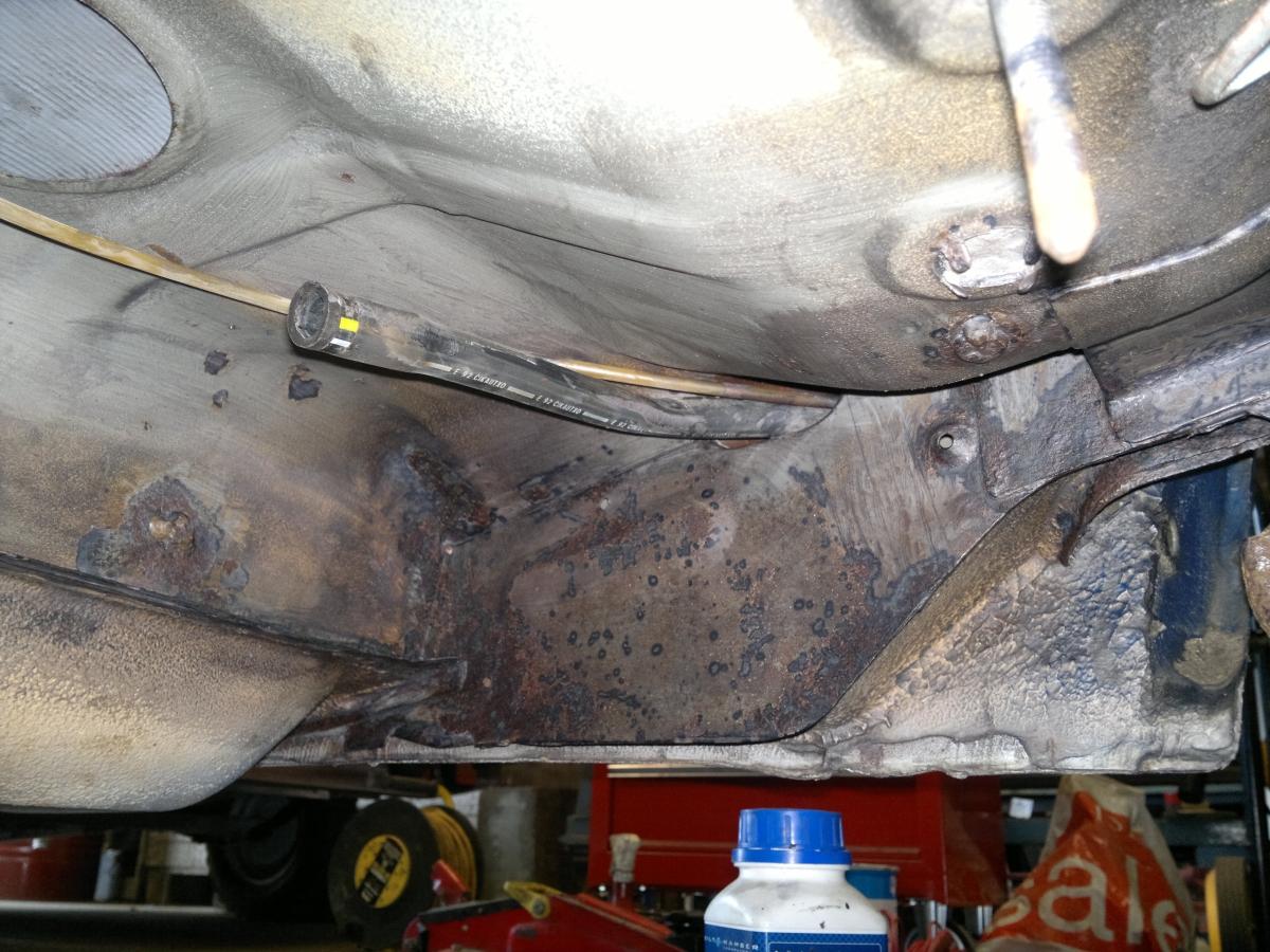

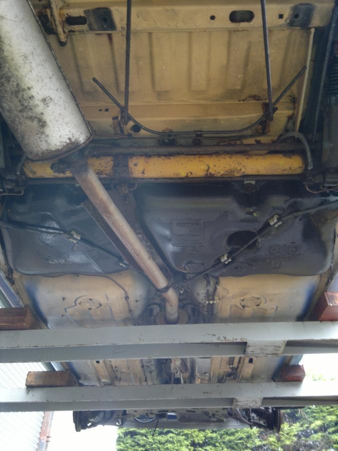

Next, it was time to get underneath and get the tank out to get at the rear brake line, and to see what scabbyness was hiding behind the tank. Every nut/bolt I went to had the ā€˜Iā€™m gonna ring off and drive you mad!ā€™ look about it, but some wire brushing, penetrating fluid and patience saw them all eventually screw off! The tank came out easily enough and I got a reminder of what stale petrol smelt like. Iā€™m still surprised it started and ran on it and am looking forward to getting a fresh taste back in and getting it fired up again. On that note, Iā€™ve searched for opinions on which fuel is best so Iā€™ll not open the Super Unleaded vs 95 ron can of worms by asking any more. I think Iā€™ll set it up for one fuel, try it for a while, then re-set ignition etc for the other and try that. The one opinion that does seem common is that any performance difference isnā€™t as noticeable with the 1.6ā€™s, so maybe itā€™ll be a MPG along with Ā£/Litre comparison.
The remainder of the rear brake line and the fuel pipes came off easily enough. The original fuel lines arenā€™t in great shape at all on closer inspection, so Iā€™ve ordered some 8mm kunifer and will renew them too.

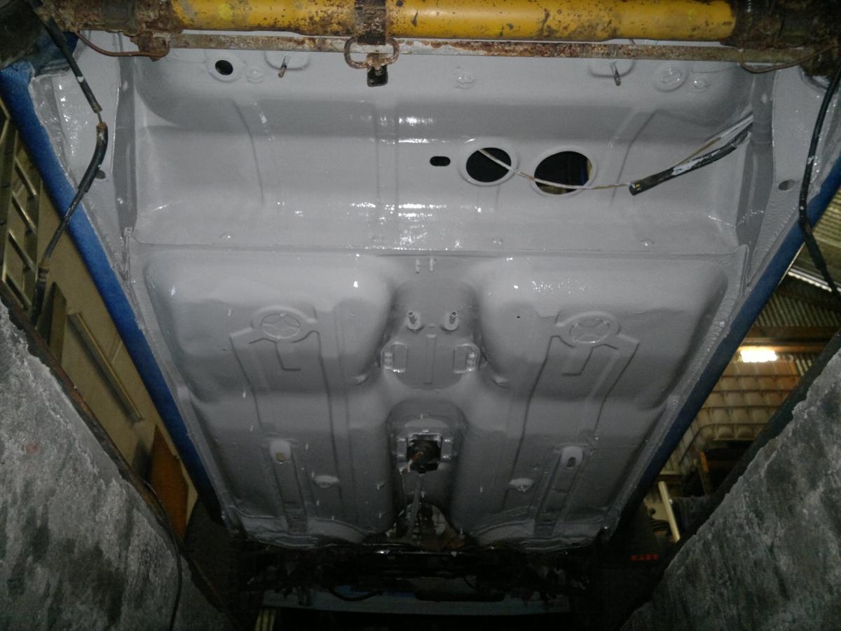

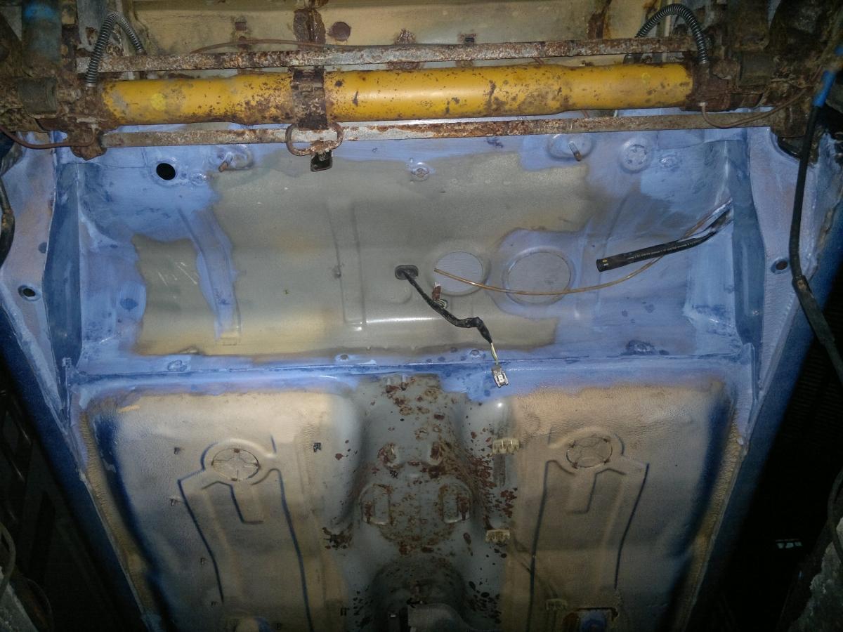

Iā€™ve scraped and wire brushed (wire brush head on the electric drill) the area above and around the fuel tank. Although a bit scabby, there were no holed areas so Iā€™m pleased enough about that. I find this sort of work very slow and frustrating, :angry: so trying to ease the frustration a bit by tackling one section at a time. Once the tanks back in Iā€™ll tidy up the exhaust tunnel area and any other bitā€™s where rust has started behind the underseal. I found that an old wood chisel (sharp, but with the corners worn back a slightly) brought the few small areas of underseal off a treat.
Ā
I had some Hydrate 80 (a rust converter by Bilt Hamber) left over from when I done the underside of the Mondeo a while back. Iā€™m not sure how effective any of these products are as Iā€™ve no long term experience, but there seemed to be good opinions out there so Iā€™ll give it a go.
It goes on a bit like thick milk, and you can notice a colour change on any rusty patches so something is reacting somewhere I guess.
Ā
Ā
In the pictures it may look like the panel webs that run into a point at either side of the tank are in bad shape, but thatā€™s only me gently bending / parting them to get rust cleaned out and treated. I might put some seam sealer between them before squeezing them back together and priming and painting the whole area. I might also spray clear (well, semi-clear) wax on the underside too so need to make my mind up before the tank goes in!

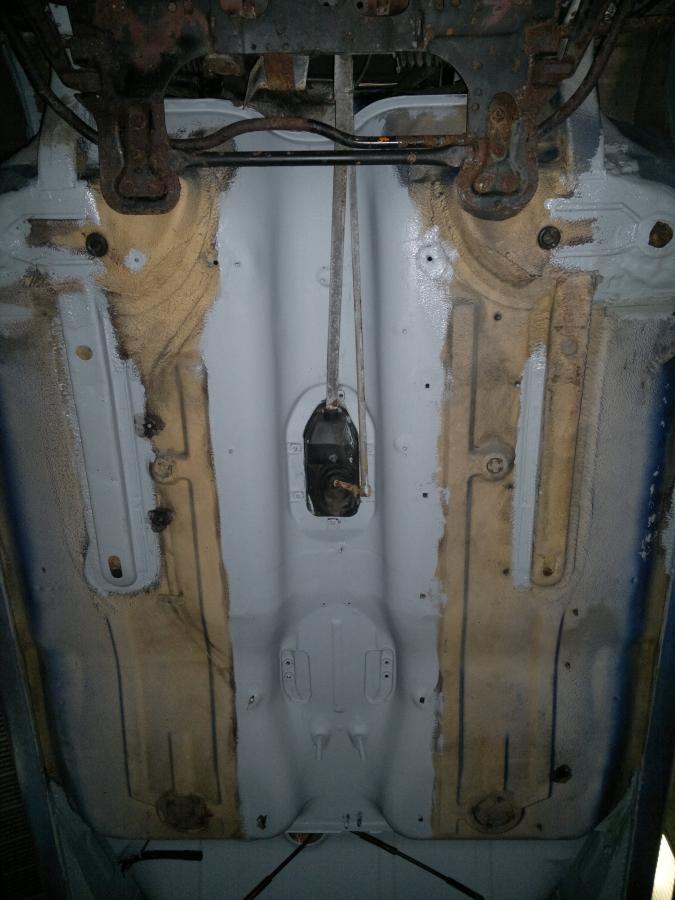

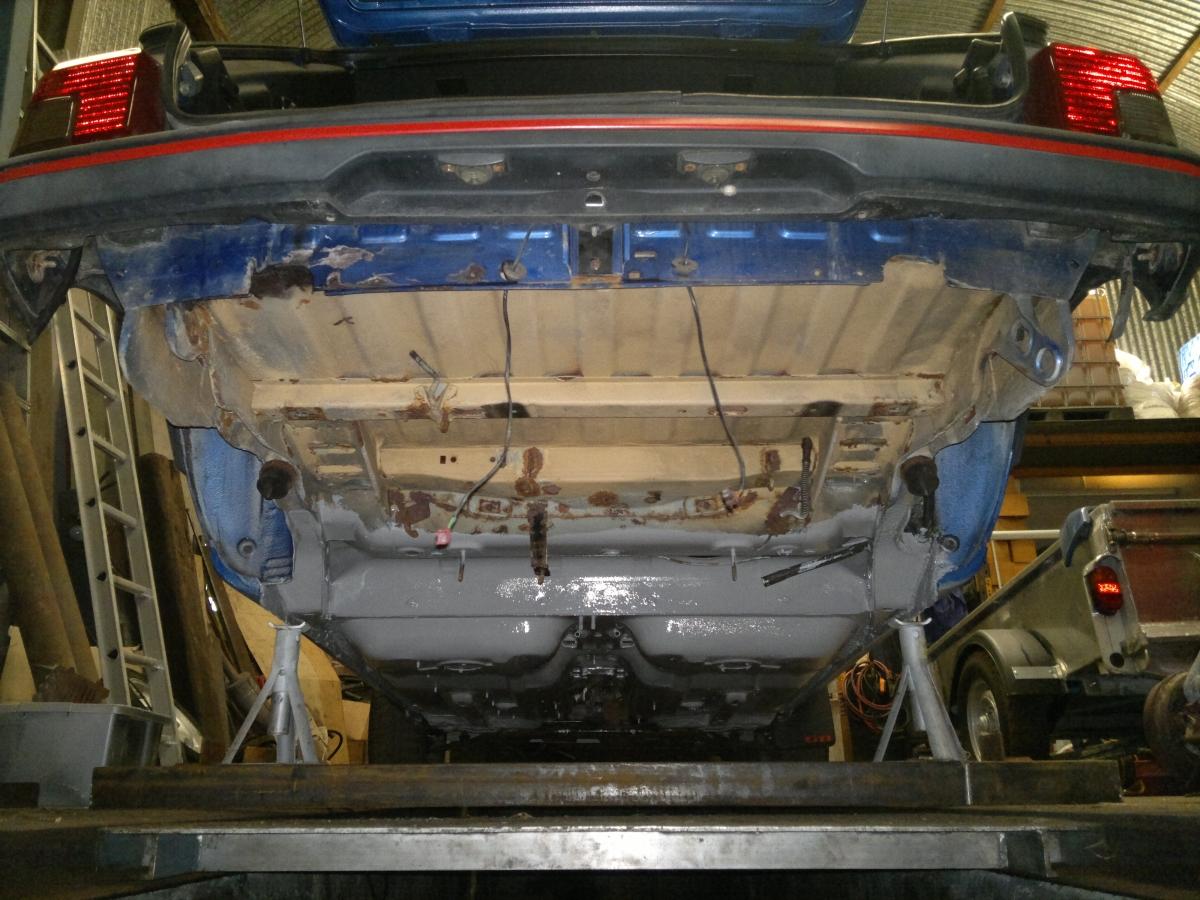

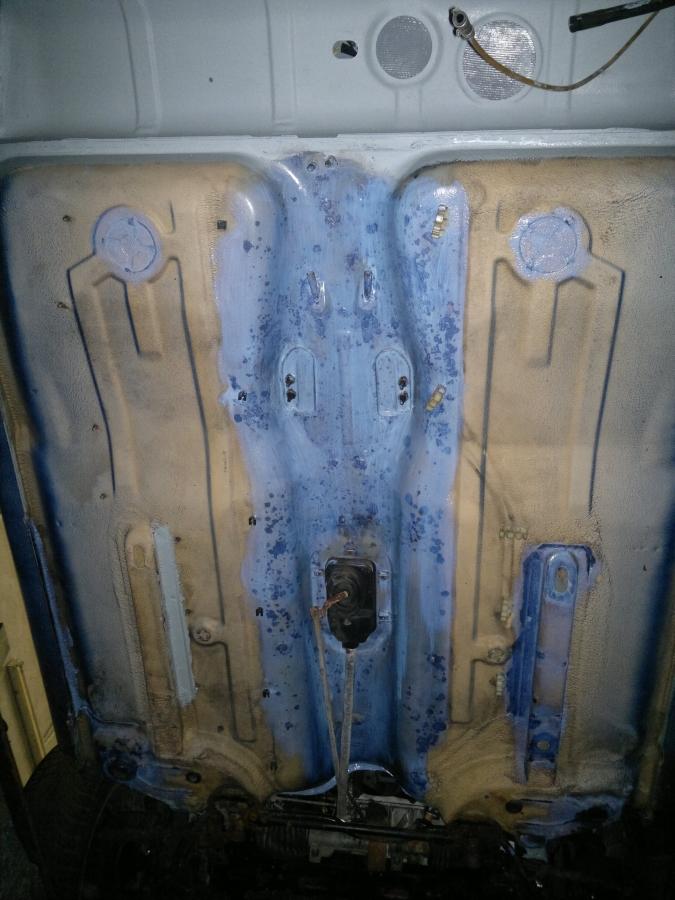

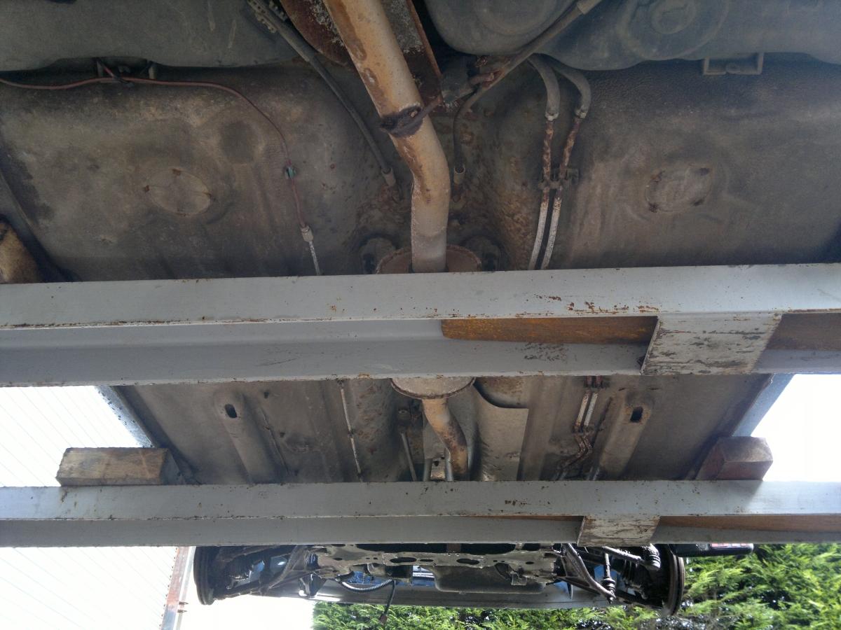

So, a few warm hours spent hiding in the pit and a small amount of progress made. I know this may sound nuts, but I cannot describe the relief of being able to crawl into a cold, dark hole on a sunny day, only having to brave the surface for food or a toilet break!.. The heat was unreal!..
Excuse making / complaining aside we now have a decent attempt at rust proofing the underside (from the rear beam forward anyway). So, following on from last time...
Ā
Bilt Hamber 'Hydrate 80' fully dried colour and ready for primer.
Ā
Area above and around fuel tank primed.
Ā
Repeated the poke, scrape, wire brush cycle for the foot well and exhaust tunnel areas before putting more Hydrate 80 on rusted areas.
It's surprising just how many little areas where the underseal can be hiding the dreaded rust. Basiclally anywhere thats been chipped or scraped (we'll not get started about monkeys with trolley jacks!) or anywhere there's a hole in the body work for a pipe clip etc will be hiding somthing, so really needs going over with a fine tooth comb.
Ā
Back with the brush coat of primer.
Ā
I had originally intended to only paint the exhaust tunnel area and the areas where the damaged underseal had been removed and leave as much of the original underseal as possible. This left it looking a bit patchy, so, as I was grey primered to the arm pit and my hand and paint brush had 'become one' by now anyway, I just continued on and filled in the rest!.. and then came back the next day for more up side down painting fun with some grey gloss.
Ā
Our 'old paint shelf' surprisingly didnt have any miami blue among it, so it was narrowed down to light grey (somthing similar to the shade the exhaust tunnel and fuel tank areas originally were). It's not original looking anymore, but it's a lot tidier and should look ok once the bits and pieces are screwed back in place.
Ā
The hawk eyes among you will have noticed the pipe clips vanishing between the Hydrate 80 and primer coats. This was after the rust paranoia went up a gear and I surfaced from the cool pit, up into 'the oven' to strip the seats and carpet and remove them... To be honest I had concerns that the underlay may have gotten damp anyway, so there was already an excuse for lifting the carpet, but we'll cover that next time...

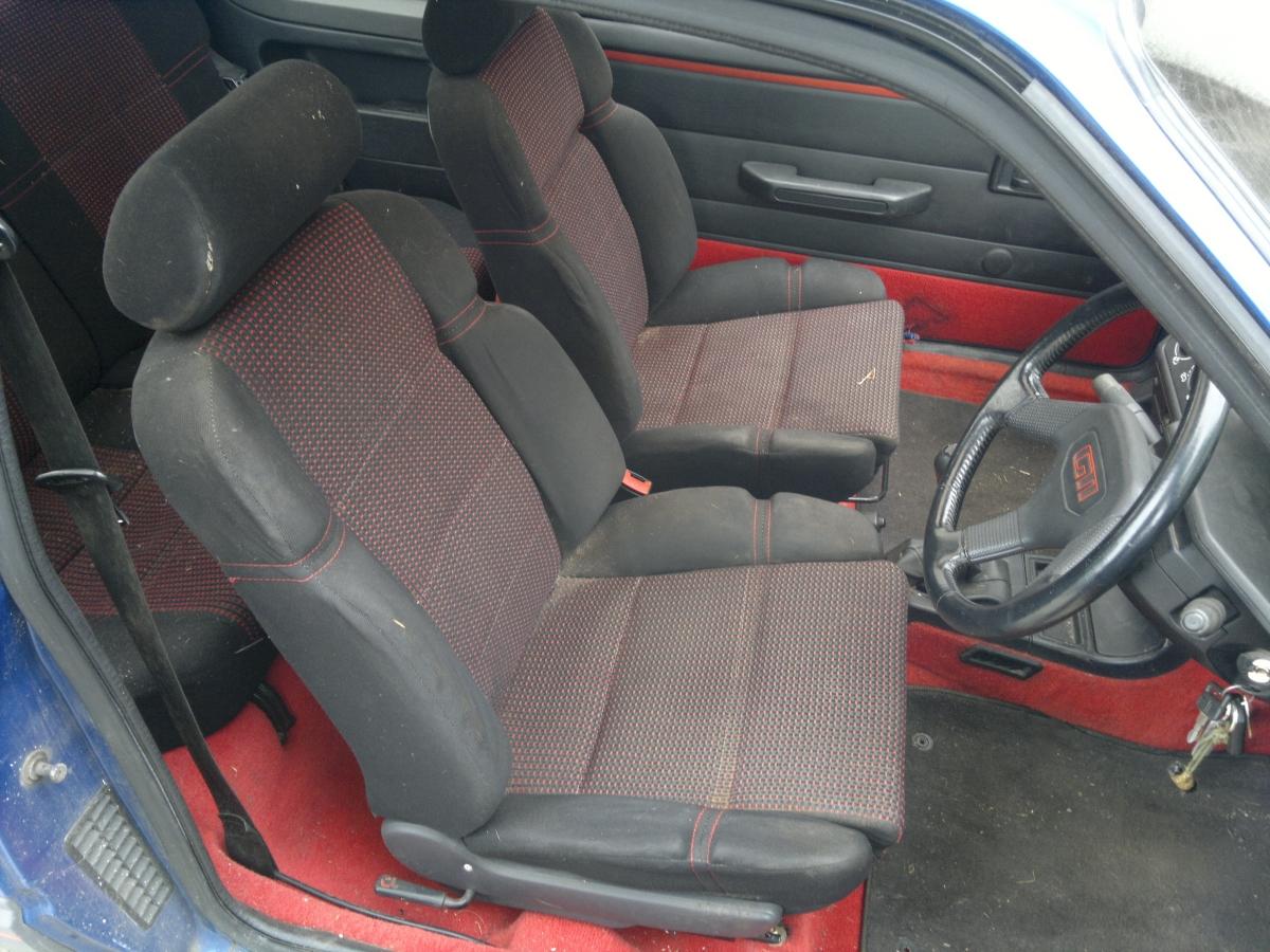

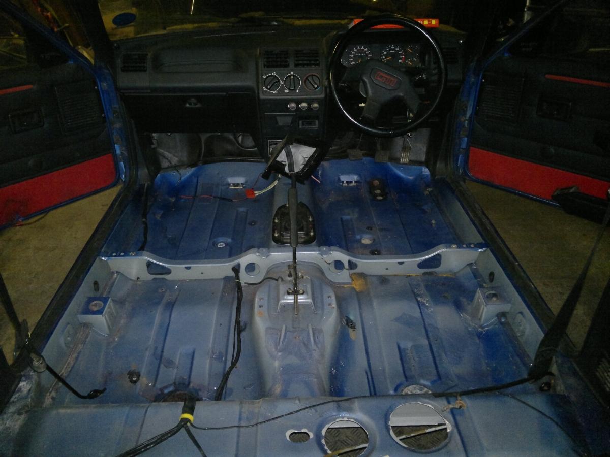

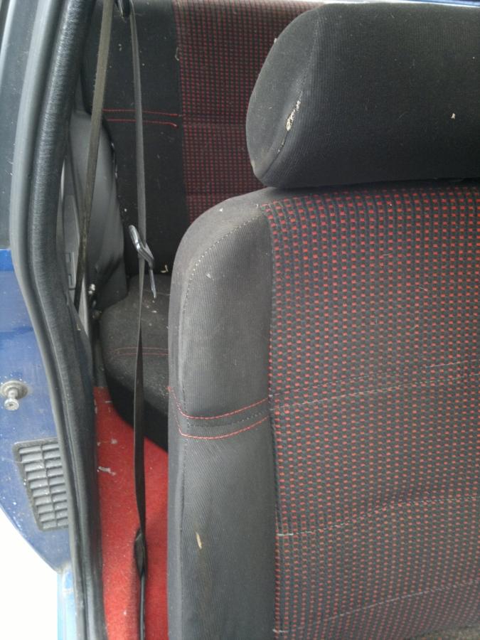

Seats and carpet out!..
Ā
Ā

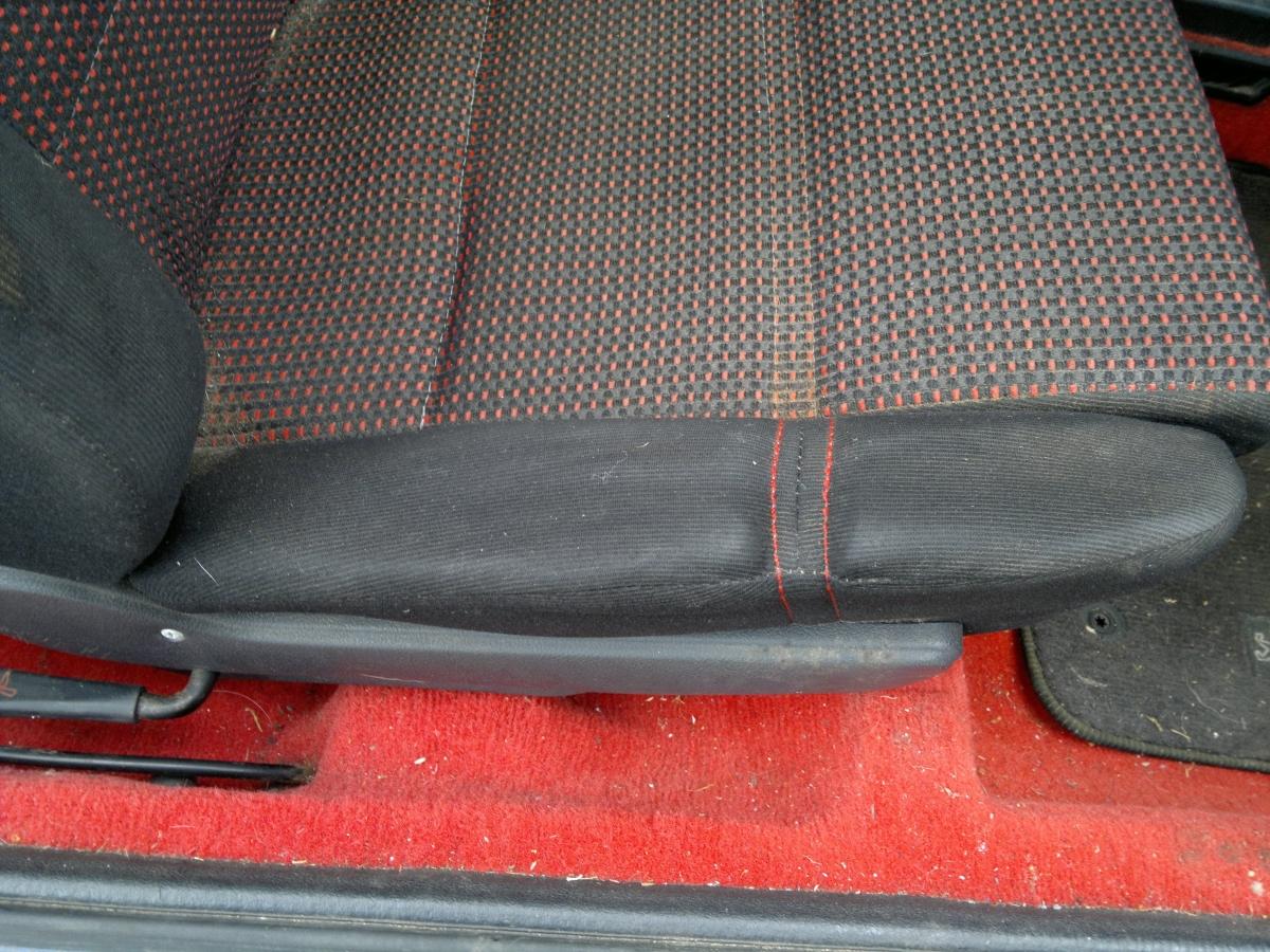

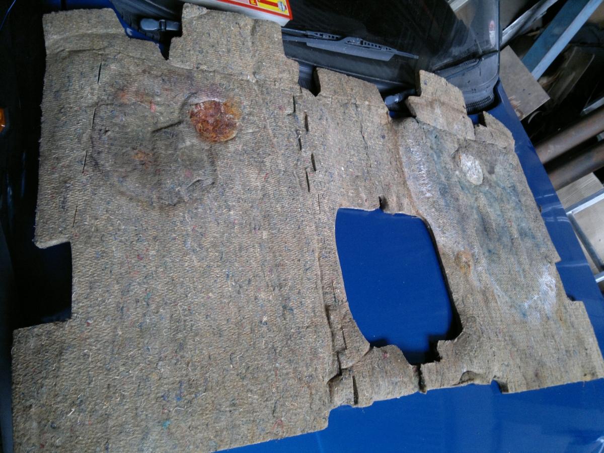

I had been contemplating lifting the carpet since I'd got the car as there were some tell tale water marks on the rear side panels at the back of the rear quarter windows, and also a neatly folded towel laying in the rear drivers foot well. Also the metal bung below the rear passengers seat was missing (possibly removed at a time to let water out?!)
Although the car had been inside for so long, it did get one heavy shower of rain before I managed to get it undercover, plus after the good heavy powerwashing, I noticed I'd managed to blast the steering column grommet inwards off the bulkhead, so was worried how much water had went in there.
As it turned out, it wasnt that bad at all. I propped the bulk head insulation back on small wooden blocks and dried it with a hair drier, and the couple of damp patches on the floor underlay were bone dry again after a weekend in the recent sunshine.
The underlay definately shows signs of past water leak issues tho!... And I now wonder if this was a factor in why it had been mysteriously SORN'd just after having so much work done and being serviced (the engine oil was still clear and golden!) :huh:
Ā
Ā
..Anyway, hopefully the water will stay out now with the work done around the rear window seals etc. Before I put anything back in, I'll get it pushed outside and give it a drowning with the hose for some peace of mind!..

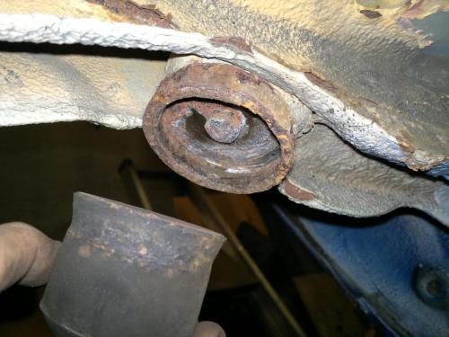

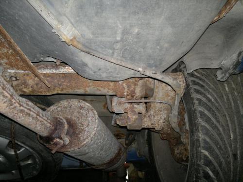

..There was absolutely no play in the trailing arms before and they moved up and down freely with no creaks or groans. I know this doesnt mean that all's in perfect condition in there, but I was adiment that I'd get it on the road for a few months and worry about a beam check over the winter... but as the tank and brake lines were all out by now, and the rest of the floor was looking so good all painted, I thaught it was daft not to slacken six nuts and drop the beam!
This allowed me to remove the two flexi brake pipe brackets and fuel tank strap support bracket as well. As one of the three studs had been stripped and the bracket tacked back the the body, and with the other two looking like they'd be no better, I decided I'd drill them out from inside the car and weld in three 6mm bolts...(no pic of new studs tho!)
Ā
Ā
Also removed the rear bump stops.
Was dreading removing the bolts, but with some gentle working, and a little fluid, they came out ok. They will definately be going back in with new and well greased bolts tho!
Ā
Ā

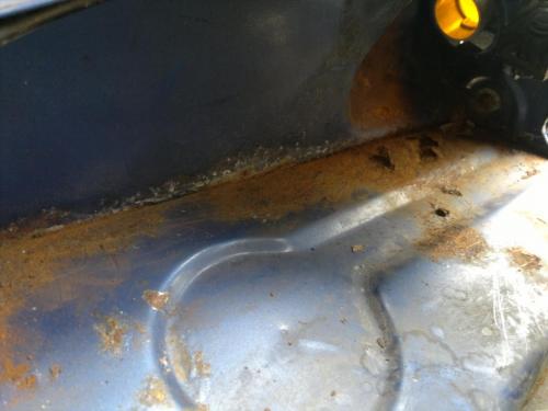

So!.. onto the poke, scrape, poke, scrape, wire brush cycle!... This was frustrating as hell and with all the nooks and crannies the boot floor easliy took twice as long as the foot wells etc. Again, everywhere there was a hole or an edge or a chip, or where two panels came together, then there would be rust behind the underseal!... and... to top it all off, there was just enough in one back corner to rot through and require a patch. I initially thaught I was going to be able to be smug, and boast about my lovely, solid boot floor, but it wasnt to be!... Room for one more in the holey floor club?!
Ā
Section needed.
Ā
..and I'll skip the ugly welding and go straight to the 'buffed and painted' pic. The welding was sound enough,but I find with very thin panels, you have to 'dap' with the welder to stop it melting through, and this never looks as nice as a good continous run. The new section is attached to the underside of the existing floor so still allows for buffing of welds up top and a quick smoothing of filler to tidy it up.

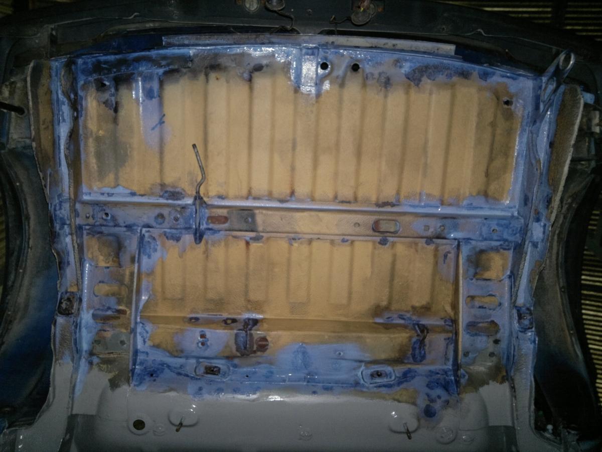

Boot floor has been primed and glossed.
Ā
http://www.flickr.com/photos/100222540@N03/9539112016/
Ā
But there's only so many places you can reach with a brush, so the cavity wax came out. It's Bilt Hamber's S-50 I had left from a previous time. It may be wonderful stuff, but I'm not sure how well the nozels work for spraying a 360 degree mist inside a cavity. I first tried inserting the 1/2 metre lance fully into the cavity then spraying while slowly retracting it, but the lance just seemed to lie in one corner of the cavity and flooding that corner, while other areas would be missed.
I found it better to fully insert the lance, start spraying, and wiggle the can about a bit while slowly retracting it. Then repeat this, but after rotating the can / lance roughly 45 degrees to try to ensure decent coverage.
I used one and a half 750ml cans to do all under floor cavities, including up into the front chassis legs and inside the sills from access holes at the front wheels, rear wheels, and inside the car.

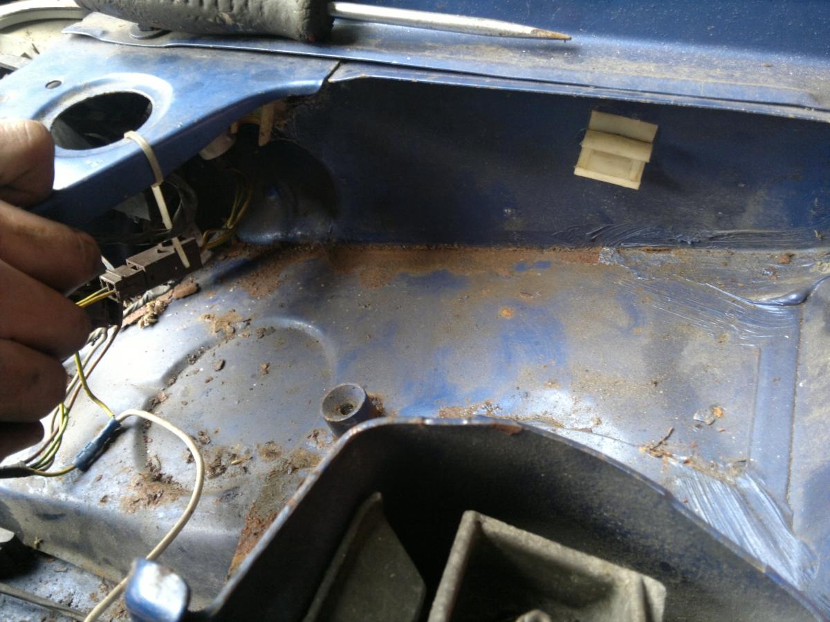

I thought it would then be time to get the rear beam put back in, but this wasnā€™t to be. While there was a bit of space in the wheel arches to work, I decided Iā€™d quickly clean and paint the wheel arch to quarter panel seams, but while cleaning I discovered the seam had let go a little on the passengers side!.. ā€˜ugh sh1t!ā€™ :angry:
Ā
http://www.flickr.com/photos/100222540@N03/9539119600/
Ā
So, inner quarter panel trims off andā€¦
Drivers side was fine
Ā
http://www.flickr.com/photos/100222540@N03/9539122616/
Ā
But sure enough, the passengers side had been letting water and muck through and needed fixing. For the seam to only have been parted for about 3ā€, it was surprising just how much crap had gathered inside the rear quarter panel.
Ā
http://www.flickr.com/photos/100222540@N03/9539122006/
Ā
So, after a good wire brushing and wipe with some thinners on a rag, it was ready to be re-glued. There were a few packs of two pack plastic repair to hand so used that. Weā€™d discovered in the past that despite being aimed at plastic repair, it was generally very good at sticking anything toā€¦ anything! (including metals).

I wanted to stay focused on finishing underneath so tackled the new fuel pipes next.
The old pipes had gotten a bit of a twist on the way out, but were good enough to use as a basic pattern, so done most of the shaping on the floor before offering the new pipes up to the car and gently bending here and there to get them looking half tidy. I found it far trickier than expected to bend two pipes so that theyā€™re a constant offset from each other. But they turned out ok in the end.
Ā
While it was satisfying to get the new pipes made and fitted, it wasnā€™t without a bit of frustration!.. The lack of a small pipe bender, along with the stubborn determination to recreate the tight bends in the pipes has resulted in what feels like two broken thumbs!.. I then nearly freaked when I went to slide the compression fitting nut (which had slid back down the feed pipe during shaping) and discovered that with it being such a neat fit on the pipe, and with a couple of bends having ā€˜ovelledā€™ the pipe ever so slightly, then it was the ultimate b?*tard to get slid back to the end!.... :angry: In reality it probably didnā€™t require much effort to ā€˜twist and slideā€™ the nut back up the pipe, but you have to consider the ā€˜thumb situationā€™ I was dealing with!
Ā
So, with a fresh taste of fuel in the tank it was time to test the new pipe work and connections!... So hooked up the battery, and after a few turns of the key (still with a sore thumb!) sheā€™d filled the filter, threw back a shot of the good stuff and ā€˜roaredā€™ into life once more!... (As it turns out, an exhaust manifold exiting downwards into a pit makes quite a noise! :o ... and scared the swallows out of their nests for an hour or two!)..
..oh, and just to note: I did have a small fire extingwisher to hand... not that I was doubting my connections or anything!

Quarter panel to wheel arch seam fixed, primed and glossed. (drivers side was also done for good measure)
Ā
Ā
New brake pipes, fuel pipes and exhaust wire brushed and painted. I wasnā€™t going to bother touching the exhaust as I view it as kind of a consumable item that will rust no matter what I do with it. In the end I gave in and went over it with the wire brush head in the drill, followed by two aerosols worth of VHT silver. Iā€™m amazed at how well it came up although Iā€™ve no experience of these high temp paints so weā€™ll see how it lasts. Just for reference, itā€™s a bosal centre pipe (without the split) mated to an Arvin back box via the olive type joint.
Ā
Ā
Ā
One from the rearā€¦ Iā€™m a bit ashamed of this pic to be honest :blush: as the beam just degrades the whole thing, and I can sense the more experienced among us tutting and shaking their heads. Be rest assured tho, the beam will be back out in the not too distant future for a strip down and shot blasting etc.

Next it was time to push a slightly less ā€˜GTi lookingā€™ 205 outside for leak testingā€¦
Ā
Comical looking little things with the rear bumper removed! :lol: (note the 'go faster' dent in the bootlid!)

So onto the sound deadening.
I hadnā€™t intended to try any extra sound proofing on this car before getting it on the road as I would have liked to have driven it for a while, then applied sound deadening and have been able to properly appreciate any improvement. But, as the majority of the interior had already been made ā€˜exteriorā€™ by now, I thought I might as well just go ahead do it.. (sure, Iā€™ll maybe get to sit in a non sound deadened 205 for comparison some time).
Ā
Iā€™d already looked into the sound deadening options with the other project 205, Miss Sorrento (whoā€™s taken a bit of a back seat for now). Back then I read about people using bitumen type flashing tape as a much cheaper alternative to likes of Silent Coat and Dynamat sheets. So, after trawling through different websites and forums trying to gauge the proā€™s and cons and effectiveness etc, eventually just went for the cheap flashing tape!..
I started with the floor on Miss Sorrento, and quickly noticed that the bitumen on the flashing tape softened really easily with a hair dryer. This raised a few concerns when I thought about putting it on the insides of doors and quarter panels, especially since sorrento green is such a dark colour and would ā€˜hold the heatā€™!.. I had all sorts of visions of warm sunshine softening flashing tape, and it sliding down and blocking drain holes etc etc etc, so decided I wouldnā€™t take the risk and would try some ā€˜properā€™ sound deadening insteadā€¦.
So!.. Back to the ICE orientated websites for more trawling, and I decided I would try some 2mm thick Silent Coat, so went for the Volume Pack consisting of 20 37cm x 26cm sheets (total 2m2) for Ā£40. When it arrived the first thing I noticed was how heavy it seemed (far heavier than the Ā£25, 225mm x 10m rolls of flashing tape!).. So I got the bathroom scales out andā€¦.
Ā
..Ā£25 worth of flashing tape.
Ā
Ā
Ā
..vs Ā£40 worth of Silent Coat. (thats Kg by the way)
Ā
Ā
Ā
I donā€™t know what anyone else thinks, but I took that as ā€˜false economyā€™ going for flashing tapeā€¦Leason learned!
Ā
It turns out that the silent coat was also so much nicer to work with, and with a bit of hair dryer heat, was really sticky too! The funky looking creased pattern on the foil actually serves a purpose as it allows the sheets to stretch a little and form much better into any pockets or grooves, unlike the flashing tape which would be wrinkle-tastic by the time youā€™d shaped it.
Ā
So, back to Miss Miami, and another 20 sheets of silent coat.
Trying to prioritize places to be deadened and choosing a sensible ā€˜percentage coverageā€™ was the next task. Iā€™ll not cover my whole train of thought or decision making (weā€™d be here all day and itā€™s really a whole other topic in itself!).. so hereā€™s a few picsā€¦

..Foot wells, rear seat well, lower quarter panel and wheel arch coverage.. (may look a bit scant on the front foot wells but I found, with the body / floor reinforcing, these areas werenā€™t as ā€˜tinnyā€™ as other areas)
Ā
Ā
Ā

Distrubutor and Vacuum Advance:
Theres an Autofive receipt for the new vac unit just before the car went off the road and all seems fine with the suck test. While searching on here Iā€™d read stories of 1.9 distributors being fitted to 1.6ā€™s (and vise versa), but from what I gather, this one (Bosch Number ending in 086) is correct for the later 1.6ā€™s.
There was an oil leak that seemed to be coming from between distributor and head so replaced the O-ring seal in there. Before the distributor was removed I marked the position with two dimples. Iā€™ll have to find a quiet spot with a decent hill to set the ignition timing (as per the ā€˜until pinking occurs, then back a bitā€™ method), but the two dimples will let me get it back together now and then I can also measure the stagger between dimples if the timing does need adjusted.
Ā
Ā
Ā

So, getting back to getting other stuff done so that it can actually go on a road test, attentions were turned back to the interior.
Ā
Carpet how it was removedā€¦
Ā
Ā
Carpet vacuum cleaned (after beating a load dirt out first!)..
Ā
Ā
I had originally just intended to give it a good vacuuming, and then clean any spots of grime with a decent cleaner on a cloth as it really didnā€™t look overly dirty, but since it was out, and the sun was shining, I decided Iā€™d try washing it!...
Ā
Ā
The results were amazing, and the photoā€™s genuinely donā€™t do it justice! Iā€™m now glad I didnā€™t just throw it back in all the for the sake of a little warm water, washing powder, a gentle scrub and a rinse...

Before the door trims went back on I wanted to close the cut outs on the inner skin with the foam door liners Iā€™d stripped from the old daily driver (Mk2 Mondeo). The foam was only about Ā¼ā€ thick but it seemed to put a fair bit of pressure on the back of the door trim once they were fitted so I ditched that, hunted about some more, and found some much thinner, white foam. I donā€™t know if itā€™ll make any difference to sound etc, but thought it was worth doing while I was there.
Ā
Ā
Ā

Next the back seats got a vacuuming and went in. They came up really well and look like theyā€™ve never been sat in.
Ā
The front seats got a vacuuming and I was so close to putting them back in until I decided to strip and repair the drivers seat bolster and slight material wear!.. It didnā€™t look bad at all by the usual 205 standards, but given how fragile the 1.6 cloth interior feels (I swear thereā€™s tougher bog roll out there!) I decided to try to fix it now before it got any worse.
Ā

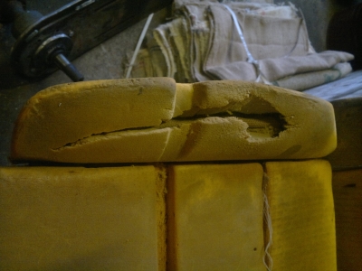

Iā€™d stripped the seat last time, and there hasnā€™t been much progress there.
Rather than bin the split bolster, I thought there was nothing to lose by trying a bit of expanding foam sprayed in. (May seem a bit crude, but just wanted to see what would happen!)
Ā
Ā
It bonded to the existing foam well, and was quite easily trimmed with a sharp kitchen knife but you could still feel the repair through the thin fabric.
Ā
Picture of roughly trimmed foam (no pic of final trimming! :( )

The fog and reverse lights hadnā€™t been working, and it was little wonder going by the state of the connectors and terminals. Itā€™s a bit of a pathetic set up really with the open back type connections positioned so low and being exposed to the elements like that, so as I sat and cleaned and scraped at what was left of the terminals, I knew that even if they did work, it wasnā€™t really going to be much of a job and would probably let me down again at some point (most likely at the MOT centre...). Even after cleaning the connections and getting them to work, I discovered the bulbs could still wobble about a bit and lose connection within the holder from time to time!... Patience was running out by now, but rather than trail them out and turn them into missles, I managed to keep calm enough to study and figure out a fix.
Ā
When cleaning the terminals, and thinking about how to seal them from the elements, Iā€™d remembered that there should be some old Rubbolite marker lights somewhere that had been stripped off a scrap lorry trailer. I thought the rubber could be used to cover the exposed connectorā€¦ then I thought ā€œwhy not try to fit the sturdy, metal bulb holder as well!ā€ā€¦
Ā
So, terminals removed and diameter filed out very slightly to accept the bulb holder.
Ā
Ā
..(note: reflector was cleaned after testing the mod was going to work!)
Ā
I had to open a new box just to swap the rubber for one with the tail still on (these are normally always cut off to suit heavier, two core cable)
Ā
Finished mod. (shame the French wiring wasnā€™t a little heavier to be tight in the rubber.. hence the small cable tie)

Also set about bleeding the brakes.
With the work done on front and rear brakes, and new brakes pipes all round, the only part not checked was the master cylinder. So for the sake of two nuts and a circlip, it was taken it off and opened it up to check the bore and seals.
Ā
All seemed ok, so put it back together and refitted it. With Dad at the pedal and me underneath opening and closing bleed screws, we got the rears bled easily, but something wasnā€™t working with the fronts. No sign of fluid and not even any slight pulses with the finger over the bleed screw. We thought it could be due to the rears being bled and not being able to get a decent pump of the pedal, so we got an old home made bleed kit out to try pumping fluid upwards from bleed screws to reservoir.
Ā
Simple fluid pump using an old window washer pump.
Ā
We still couldnā€™t get any fluid through, so, master cylinder off again and this time we noticed that sometimes when pushed in, it wouldnā€™t return fully out, so stripped it again and despite everything looking good, we reckoned perhaps the seals had hardened / swollen over time and this could be causing the front piston to stick forwards.
I priced new seals, but for a few extra pounds ended up getting a new cylinder. Thereā€™s a lovely pedal now and braking on all four wheels.

Back to the seat, and although it hasnā€™t turned out perfect, thereā€™s been a fair attempt at fixing it. I reckon thereā€™s only so much we couldā€™ve done with the bolster fabric as it had worn a bit thin and seems to have lost the slight elasticity it would have had.
We did manage to stitch the two small holes up, and then reinforce the material with some ā€˜iron onā€™ self adhesive material.
Ā
Ā
There were other issues too that needed sorted..
Ā
The velcro and the material webs that pull the cheque material into the sponge were all detached, so new webs were made and sewed on and the velcro reglued to the sponge..
Ā
Ā
Ā
Ā
The piece of fabric that holds the base cheque material backwards wasnā€™t ripped but seemed very brittle and fragile so found something sturdier to reinforce that withā€¦(I'm not really the sporting type anyway! ^_^ )
Ā
Ā
..the 'sports bag' material was firmly stitched to the chequed material and is taking all the strain, so the old fragile material is only there to cover the new material.
Ā
Seats back in..
Ā
cloth reinforced and hole stitched up, but still a bit wrinkley!
Ā
Ā
Base bolster came up well with only slight thinning visable..
Ā
Taking time to make new webs and re-glue velcro helped create nice definition in the base and back sections..
Ā
Ā
Ā
Like I said, itā€™s not concours (and the photos make them look really bad!), but at least Iā€™m confident enough to sit in it without it disintegrating beneath me!... I had cringe worthy images of proudly parking it in public only to get out and walk away with shreds of seat material hanging of the arse of my jeans!

..After the test drive, it was a case of trying to guess the mixture setting and set the tick over accordingly. Iā€™ve no access to a CO meter so I searched through different threads to see if there was a base / common setting on different cars that might work. Two things I read were that ā€˜huntingā€™ at idle was a sign of mixture set far too rich, and there was a mention somewhere else of eight turns out from fully closed (+/- a couple of turns) being a sensible base setting.
I set it at ā€˜8 turns outā€™ and set the tick over to 900 rpm.
With being away from petrol engines for so long, and with the rich, ā€˜fumeyā€™ smell still lingering at tick over, I was still paranoid emissions were up the left. Thereā€™s also a ā€˜ticky / tappinessā€™ to the engine (almost like the old push rod engined fiestas! ), and again Iā€™m not experienced enough to know whatā€™s normal / acceptable with these XUā€™s. It sounded like it could either be tappets or injectors, so with the theory that dirty injectors, or badly a worn cam would mess with emissions, I decided to try to check both.
Ā
The injectors came out eventually with some carefull working (Iā€™ve been lucky enough to have been following ā€˜skyquakesā€™ cherry red restoration and learned from his injector removal experience!..Thanks Mike! ;) )
Ā
Ā
Once out tho, there wasnā€™t really that much I could do with them. I tried to remove the tiny filters but abandoned that for fear of deforming the o-ring seal area (3.0 bar petrol leak over hot spark plugs anyone?! :huh: )ā€¦ In the end I left them soaking in injector cleaner overnight, then rigged each one up to a battery for a quick blow out. This could all have been a wasted effort, but it didnā€™t take long to do. The one thing it showed tho, is that injectors do ā€˜tickā€™ quite loudly (I guess itā€™s to be expected from a solenoid thatā€™s opening and closing quickly?)
Ā
Ā
The cam cover came off next to check valve clearances.
Ā
Ā
All the inlets were near upper limit of 0.010ā€ while the exhausts were all near their lower limit of 0.014ā€. Despite the cam looking to be in really good shape, I still contemplated getting the height gauge out to measure the ā€˜liftā€™ on each lobeā€¦ However, it was at this point caught myself on and realized I was spending time checking things looking for problems that probably werenā€™t even there!... I thought ā€œsod it!.. If it fails then itā€™s only pride and a few quid lost, and at least Iā€™ll see how far out the emissions are!ā€

..so the next morning (Friday) I bit the bullet, and managed to get a cancellation for 2.50pm Saturdayā€¦ (no turning back now!). For those that donā€™t know, weā€™ve a different set up for MOTā€™s over here. Our test centres are part of the DVLNI and are solely for testing vehicles (no work done or adjustments made). You arrive, and you / the tester takes your car through the different tests / inspections and you come out the other end with either a ā€˜certificate + smileā€™ or ā€˜fail sheet + damaged prideā€™.
Ā
So!..
Ā
ā€¦3.15pm Saturday...
Ā
Ā
I was relieved to say the least. The only gutting thing was, in my nervousness, I forgot to ask what the feckin CO reading was!... IDIOT!..
Ā
Still, an excellent feeling that one hurdle had been cleared the tester seemed pleased with the work done underneath!.. next up, insurance and tax.

Seat tilt mechanism removed
Ā
Ā
Tilt mechanism adds about 1 1/4" to seat height.
Ā
This really improved the sitting position (for me anyway). Iā€™m not the ā€˜sitting on the floor, seat tilted back typeā€™ but just didnā€™t like the feeling of being jacked up in the air with the head skimming the roof trim!
When refitting the sliders to the seat I put about Ā¼ā€ spacer between runner and seat frame at the front bolts. This helped tilt the base backwards slightly into what feels a more comfortable position, but it also really helped when screwing the seat into the car again as the access to the front screws is tight.
Ā
Also had to bend the seat belt clasp bracket 90 degrees and sandwich it between seat base and runner.
Ā

Took a few minutes to rustle up two small brackets to relocate fuse box and to steady the repositioned air flow meter. (Also, the K&N intake pipe was sourced 2nd hand so had to make up a shortened air filter mount.)
