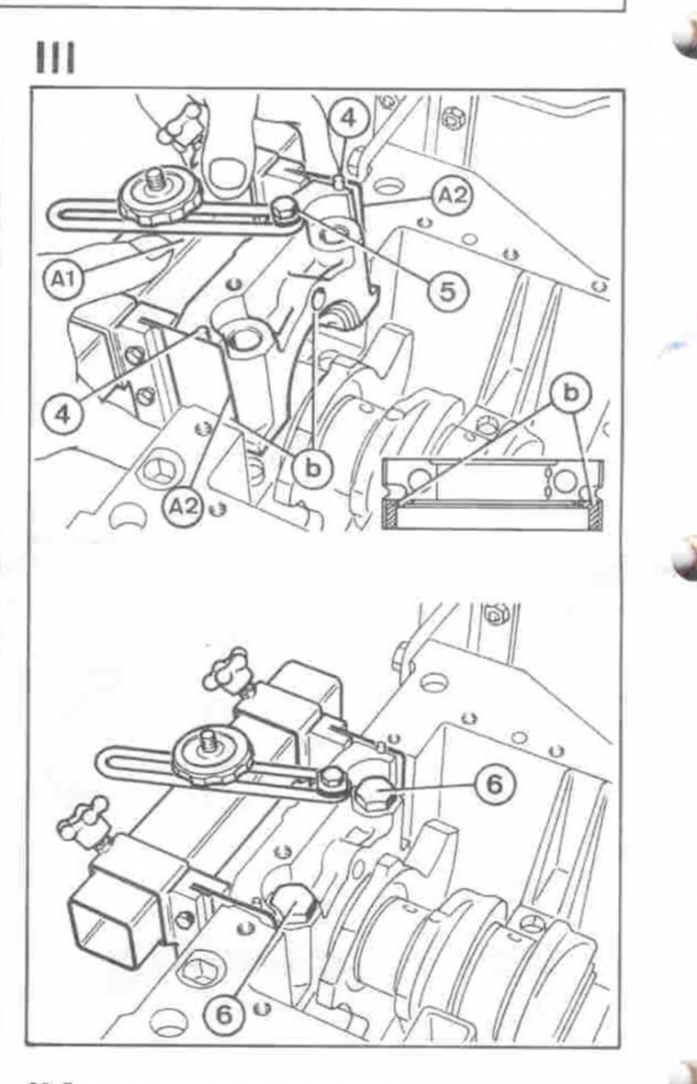

Are you entering the rear cap at an angle of 45º and then standing it up? If trying to slide them all the weigh down vertically, they'll tear, unless you use some thin, stiff plastic as shims, which you then remove (as in the pic).
colti
Wow,thats a contraption!

That's a page from the XU9J4 rebuild manual. Must be a factory tool.
