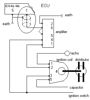

Are the pin numbers correct for these two? Pin 1 of the coil should be the tacho output (green wire iirc) and not connected to anything else.

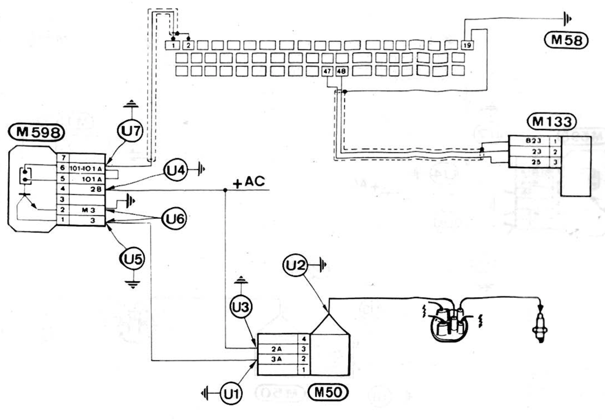

This is the wiring diagram I have:
Factory diagram (3 row ECU).

The loose yellow wire needs to be fed switched 12V, as this is the input to the ecu (pin 27) and the coil.
The loose brown wire needs to be earthed.
The blue spade connector in the middle of the loom is the tacho feed (as it's on the negative side of the coil)
Small connector near the coil plug will not be connected (it's been a long time since the car had a radio in it!)
