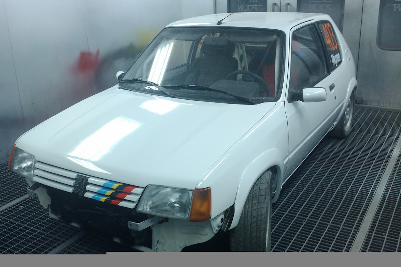

Before rebuilding the engine I decided that If I'm going to try and find some sponsors this year the car needs to look a bit better, so I stripped it, cleaned the rust, rust proofed it and resprayed it.
Posted Image
Posted Image
And bought some T16 decals from John Goodhand on here.

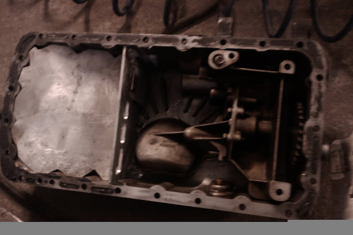

I'm not allowed to have a cage, I need to have the full interior, all seat belts, can't move the battery... Let's just say tomorrow is a day when I'm glad there is corruption in Romania... :ph34r: I just hope to get some races this year so that I'll have the log book and I can register it as a race car.
The car will get absolutely NO abuse until I make my sump baffle, lost two engines to surge, won't let it happen again.
