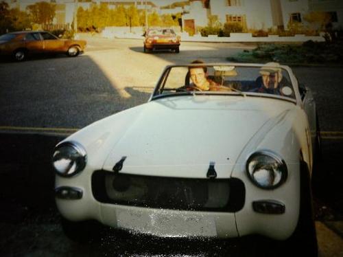

The car when we bought it! Note the dreadful carpet (I think it was office carpet someone had badly stuck in all over the place) and the parcel shelf was held together with sellotape..
