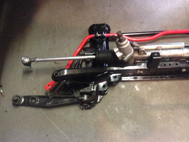

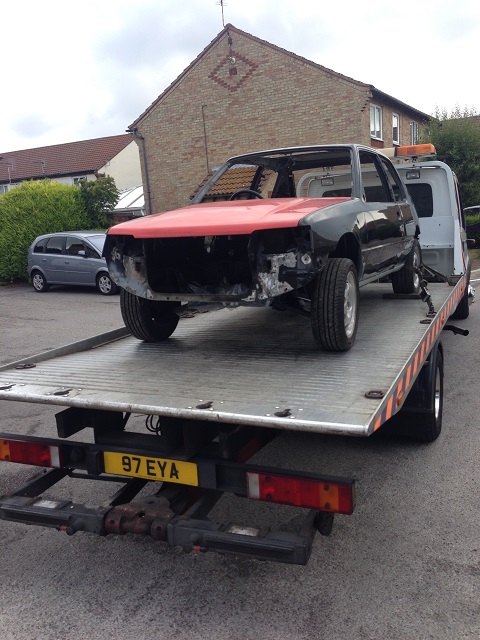

It's taken me a few weeks to summon up the energy to continue with the underseal removal so I've been doing a few other jobs. Bloody garage is tiny (I know I'm "lucky" to have one) but I've been tidying up and using various family members sheds etc and now I finally have some space to work in.
I thought I'd take a look at the wiring loom that came with the aforementioned GTI-6 engine and see what state it was in. Turns out it wasn't that good (as far as I'm concerned). All the unused wires were just cut and not covered so I fixed that! Whilst checking all the unused wires back to the ECU plug I came across the K light so hooked that up to the 6 way brown plug, there's already a Wire 74 going up to the instruments... pukka :-) Also had to swap the shell of the 6 way under-dash plug as it was a white 8 way (from a 309).. I got one from a scrappy a few weeks ago so no problem there.
The final spare wire turned out to be the +ve feed for the Lambda sensor? it's a four wire lambda and the other three were connected properly, but for some reason whoever did the loom conversion never connected the +12v to it? any ideas why they'd do that? I'm guessing this may have contributed to the engine not being 100% perfect when in "speno's" Goodwood. (he didn't do the original conversion by the way so don't blame him!). Anyway.. I've connected it to Wire 2 on the 6 way brown plug with an inline fuse so I'm hoping that'll be better when I eventually fire it up.
I'd like to say a big thanks to all the people who have contributed to the "GTI-6 engine loom guide" topic.. there's a really good colour diagram I found for the Marelli ECU too and it was excellent.
Other bits I've done recently....
Taken the cam covers off and given them a spruce up (still need sealing back up)
Got back to work on the wheel arches.. just a bit more to do on the rear one then i'll move along the car.
Drilled all the rivets out that were holding the sunroof in and also removed the headlining.. Both jobs I was ABSOLUTELY dreading..
Took the dash out to remove the original engine loom.
Here's some pics....

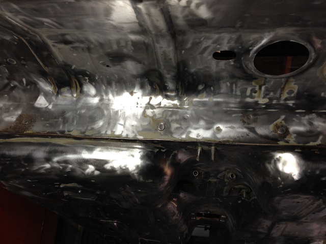

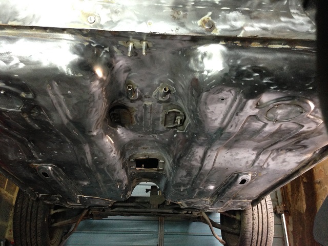

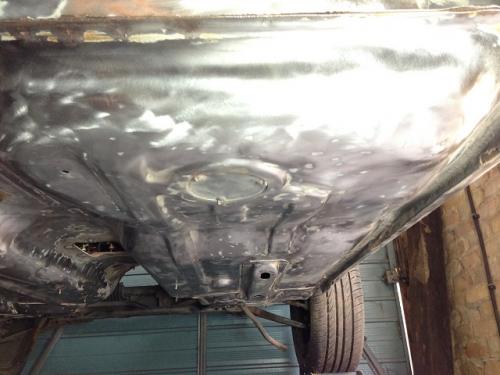

I've finally (pretty much) finished getting rid of all the original underseal!! What an awful job! I must have used 20 polywheels and 15 wire cup wheels on the angle grinder! Just a couple of awkward sections to tidy up with a wire brush on the electric drill and it'll be fully sorted. It won't be more than an hours work now.
I'm pleased to report that all that grinding has only revealed a handful of areas that need welding. The drivers side headlamp panel has "gone" just along it's edge, There's one patch on the boot floor about 3cm diameter that needs cutting out and a small section where the jack goes under the bonnet. All in all I think I got away lightly!
There's a pretty hefty dent on one of the sills and both of the area's commonly mistaken for jacking points are caved in. I'll have a go at pulling them out I think.
