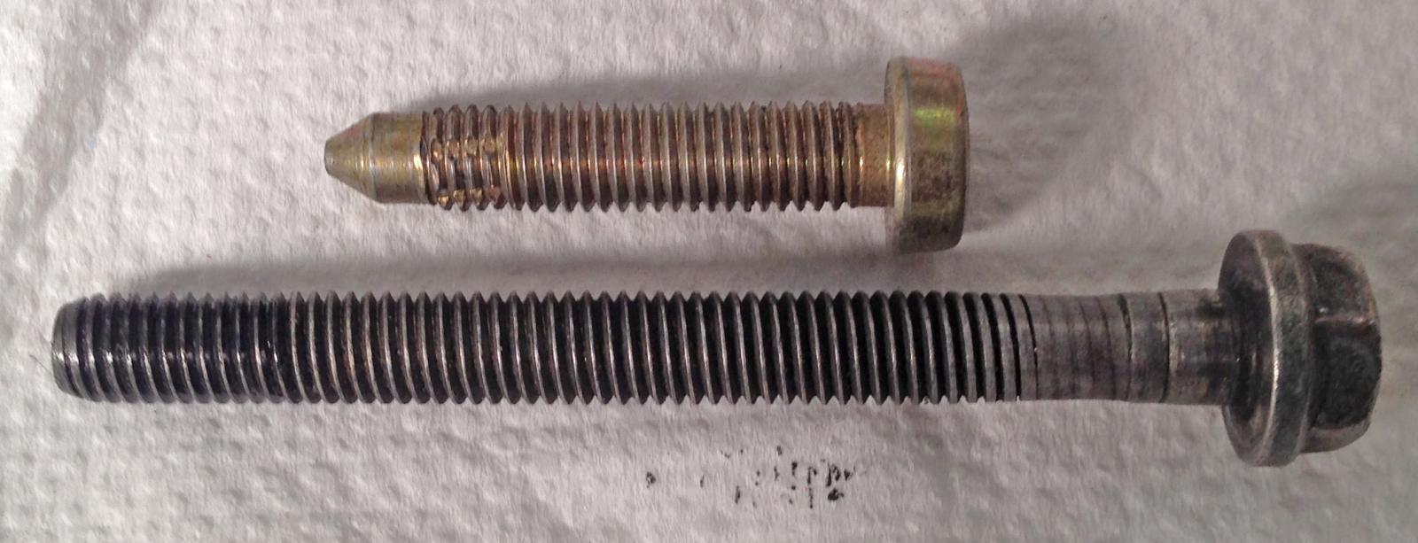

I'm trying to properly sort out the alternator tensioner on my Mi16 engine, for a while it has just had a normal bolt so I've had to lever the alternator manually then tighten the bolt while holding the alternator in position which is getting boring now.

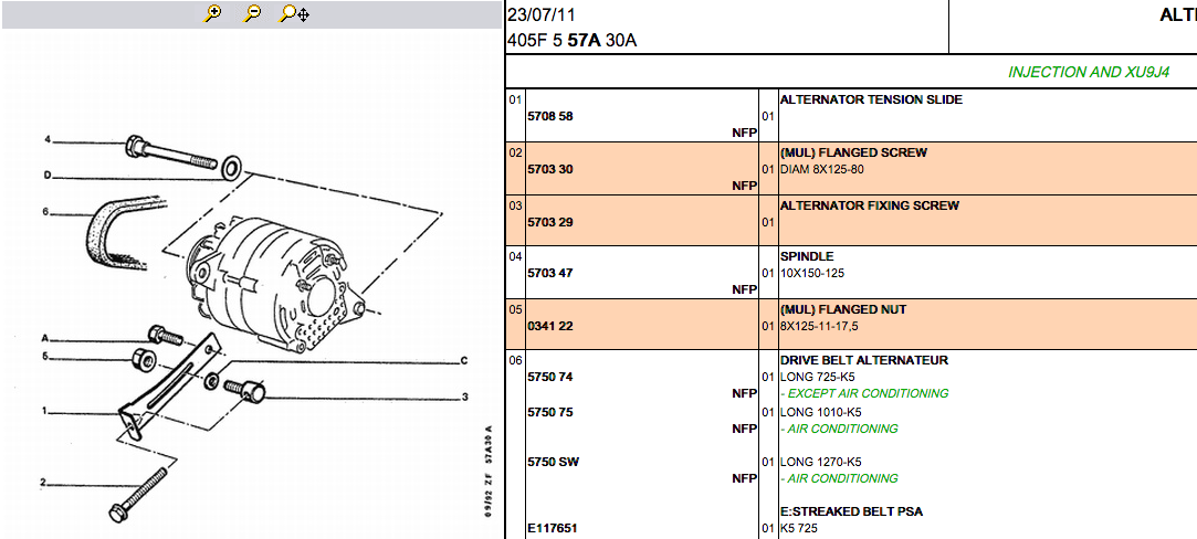

Number 3 is still available from Peugeot so I bought a new one, the long screw (number 2) is NFP but according to Service Box it is just an M8x1.25 screw.
However the thread in the tensioner (number 3) that I have here (that was in a sealed Peugeot bag) is definitely NOT M8x1.25. If anything it looks coarser but M8x1.5 seems to be extremely obscure so I don't think it is that.

I agree but it definitely isn't!
I can wind an M8x1.25 nut onto the male part of the tensioner and I have plenty of M8 x 1.25 screws that also wind into the same M8x1.25 nut but none of them will go into the female part of the tensioner.

Definitely 8 x 1.25 pitch. It's the angle of the threads which differs from a standard M8 x 1.25 bolt.
Edited by JeffR
Interesting one, I've noticed before that its a strange looking thread but never investigated further. Is it a twin-start thread so it screws in and out "faster" for the pitch?
Aye. Lead = pitch x number of starts
Thanks for that, very interesting indeed. I've seen twin start self tappers for steel sheet and wood before but I wouldn't have even thought of it in this context.

I've now remembered having this problem in the past, on one occasion I just assumed the threads were damaged so I drilled them out and fitted an M8 helicoil which worked fine so it raises the question why did Peugeot use such an obscure screw thread for something as simple as an alternator tensioner?
I wouldn't hold much (read: any) hope of buying a twin start m8 off a shelf. You could have one made but to be honest if it was me I'd do as you describe and fit a standard m8 helicoil and a suitable standard m8 set screw.
