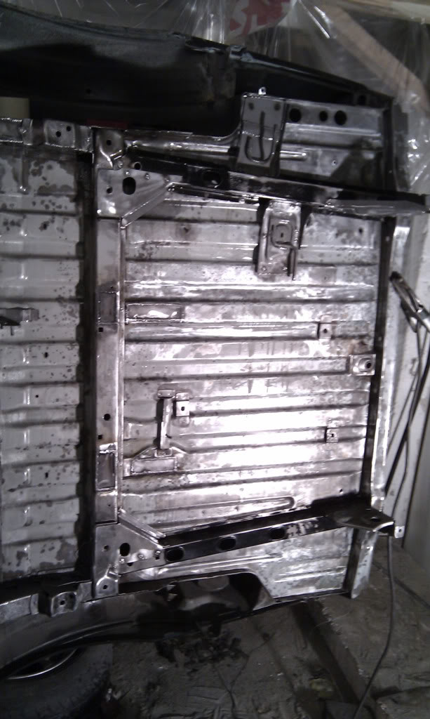

I have found some more rust inside the boot, will try just to sandblast it and oil treatment..

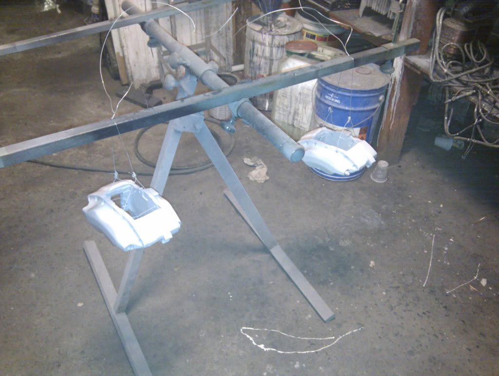

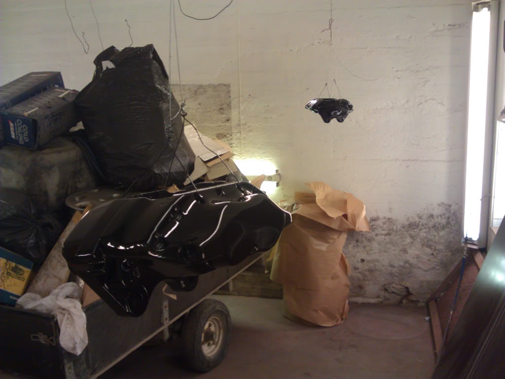

Prepped the ffront calipers a bit.
Ideally should have blasted them both, but it took a bit of time so didn't bother on the second one, just sanded.
Gave them both a layer of 2k Epoxy primer today.
Wonder if I shall have some nerdy text on them or just let them be plain.
Was thinking of "XU12J4TE STOPPERS", but guess it's not worth the hassle :)

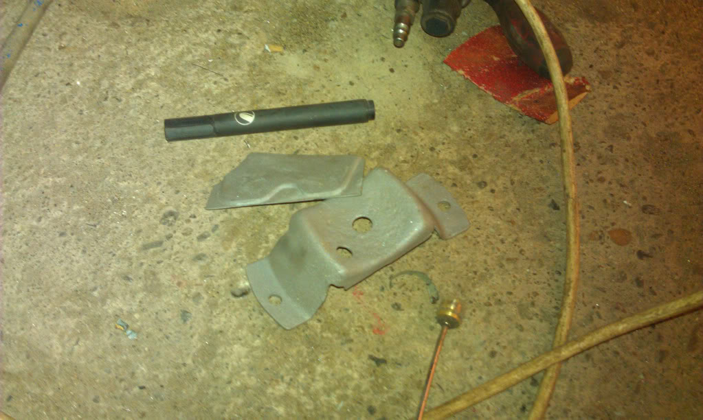

B1ack_Mi16

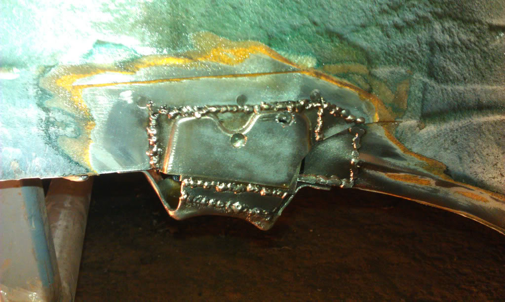

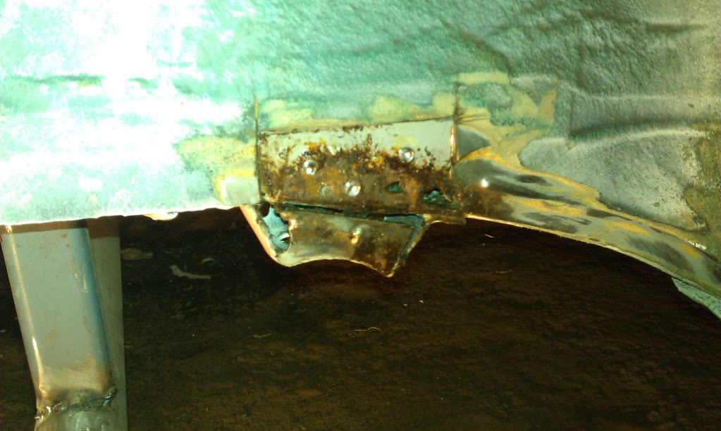

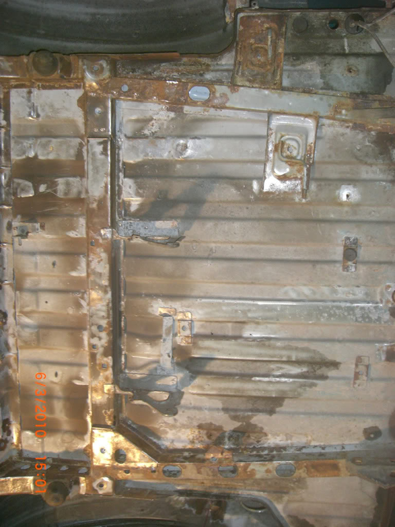

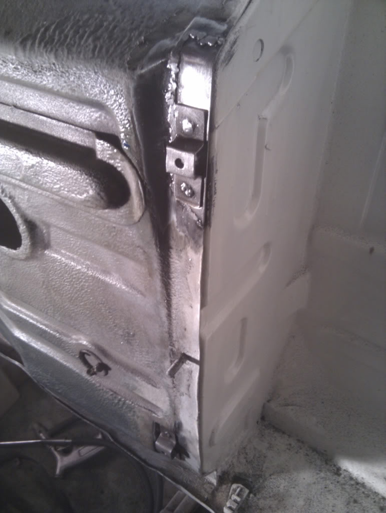

Welded up the area around fuel tank where the small brackets was not 100% good.
Notice it's rusty also under the good looking seam sealer inside the car, not good.
Brackets back in place

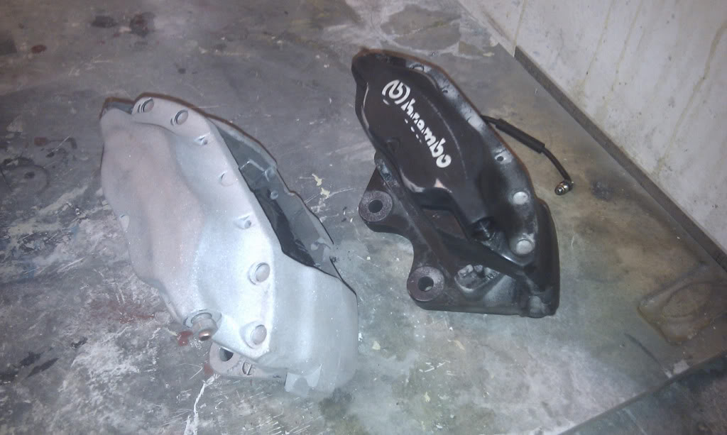

Now I have got my ass around and primed one set of T16 wheels with 2pac epoxy surfacer.
Also painted the calipers in black metallic, didn't bother to make any writings on them.. :)

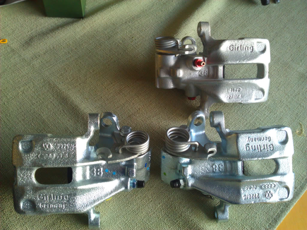

I also bought some Audi/VW calipers on eBay, it said it was for 405 4x4 also.
Picture of them and a regular FWD 405 rear caliper.
Can anyone confirm if I have got the correct rear calipers?

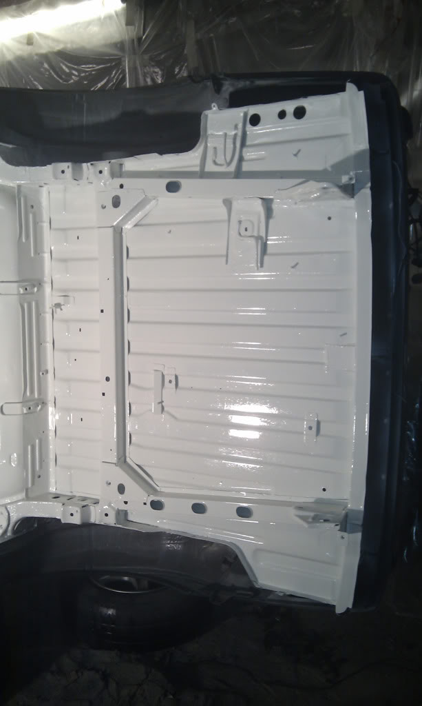

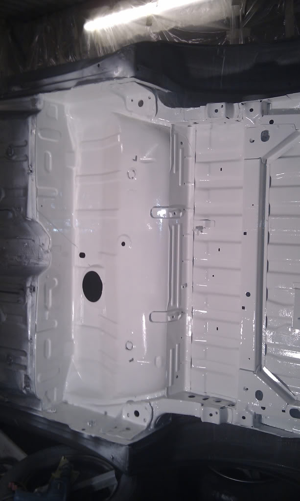

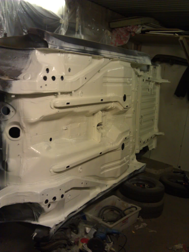

B1ack_Mi16

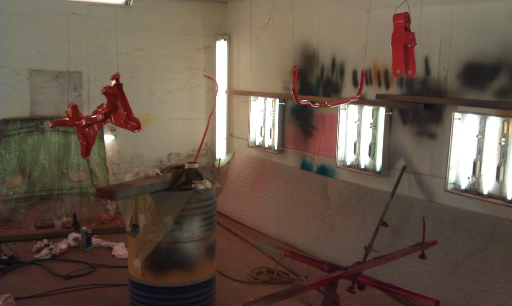

Finally completely painted the underbody.
Will probably do some seam-sealing and put on some thick anti rust protection at some spots where I have painted on top of bare metal. Then paint again and finish :)
Will be nice to turn the car back down on it's normal position again in not too long time!

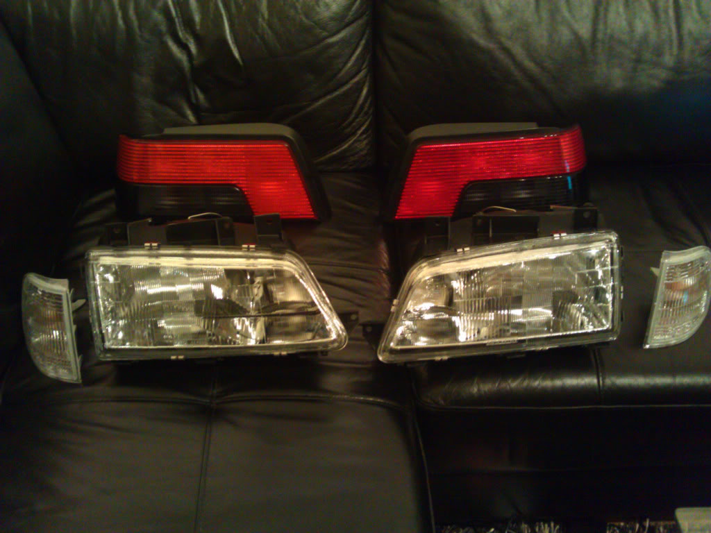

Just some more parts arriving.
This time, new lights all front and rear :)

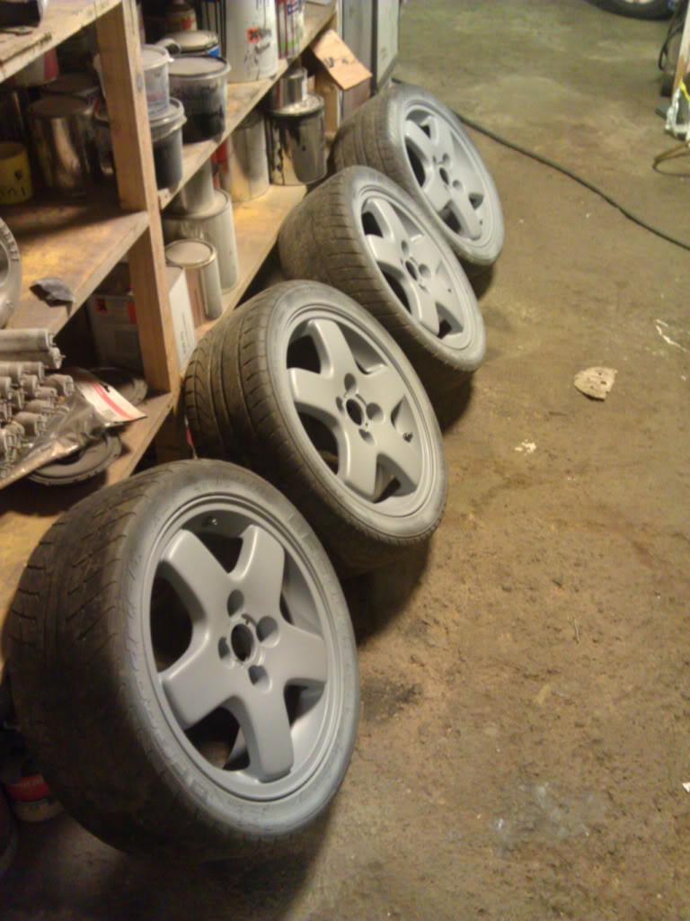

Some small update.
I have now painted the T16 wheels so they look nice and shiny :)

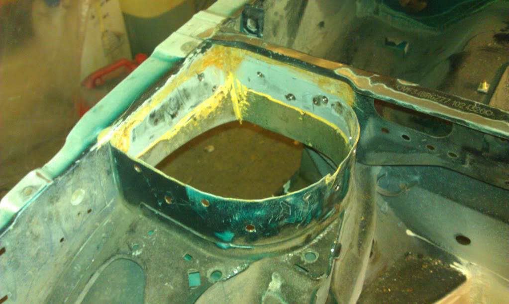

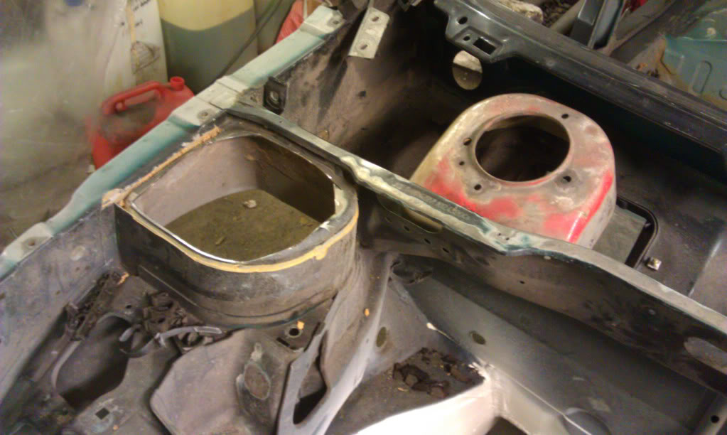

Today I started the work of getting changed the right side strut tower that had rusted through at one point. Luckily the left side tower is not that bad so that will stay.
Finally got it out after some drilling and grinding of spot welds.
It seem to me that it is not ment to be changed though, as I was thinking I could put the "new" one in from underneath, but that is not possible. So I need to insert it from the top... seem like I have to do some more cutting and welding to make that happen.. Silly engineers at peugeot designing it like this.

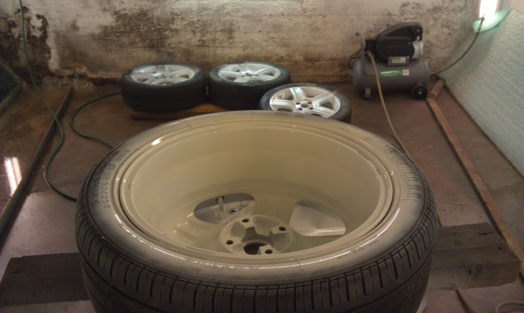

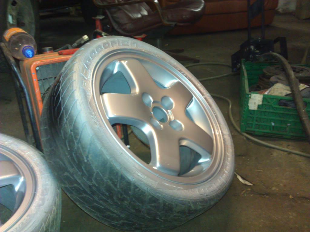

I also did finish painting the SL434 wheels I have been working on lately.
They turned out stunning and no runs :)
IIRC VW calipers will fit ok but the bleed nipple is in the wrong place.

Fantastic thread this. Thats what my boot floor looks like underneath now too. Nice to get jobs like that done and finished.
Those SL434's are fantastic looking. One of my favourite wheels ever. What are you putting them onto?
It might prove to be in the correct place really? As the hand-brake lever/mechanism is supposed to point down, then the nipple will be at top I guess.
At least it seem so to me :)
It has been a really time-consuming job. I found out I've spent like 2 years on all the rust removal that was done. (not effective hours of course, but.. :))
You get kinda tired of the rust work so good to have some other tasks to do in parallel :)
The SL434's was a lot of work to prepare due to lots of dings and bad old paintwork.
So hard to sand them, especially at the end of the spoke towards outer edge :)
The wheels might be used on the T16 also, as they do allow for the 305x28mm discs and brembos with a 5-10mm spacer.

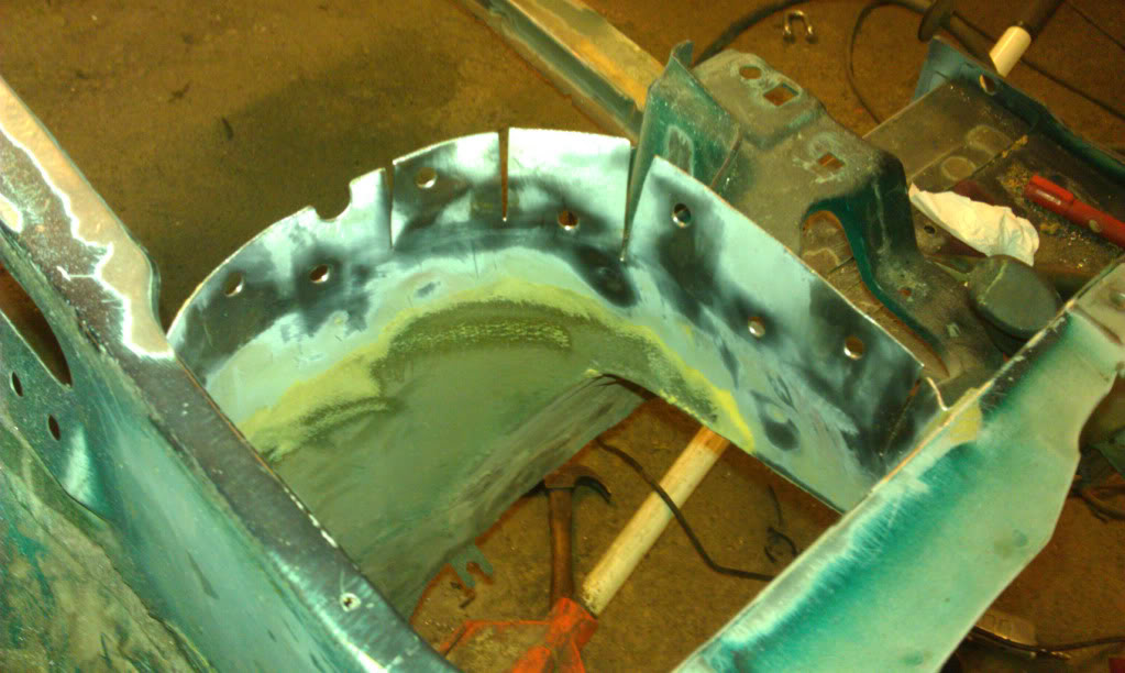

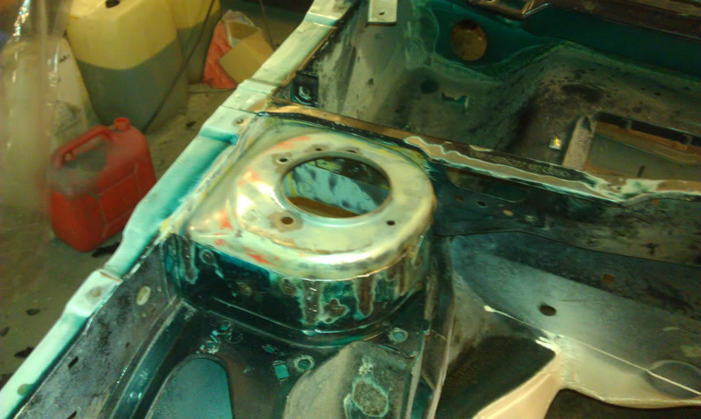

Finally some more progress this evening.
Had to do some extra cuts to be able to get the new strut tower in place.
Then put in place and weld it on.
Added a lot of owatrol oil on both top and underneath. Hopefully a few more coats of this, and some paint and seam sealer will keep the rust away for a while.
So then one less thing to do :)

Also started working on some Challenger 2 wheels I have, might be the ones used on the T16.
Just started painting the inside of them, need to take of tires before I do the outside.

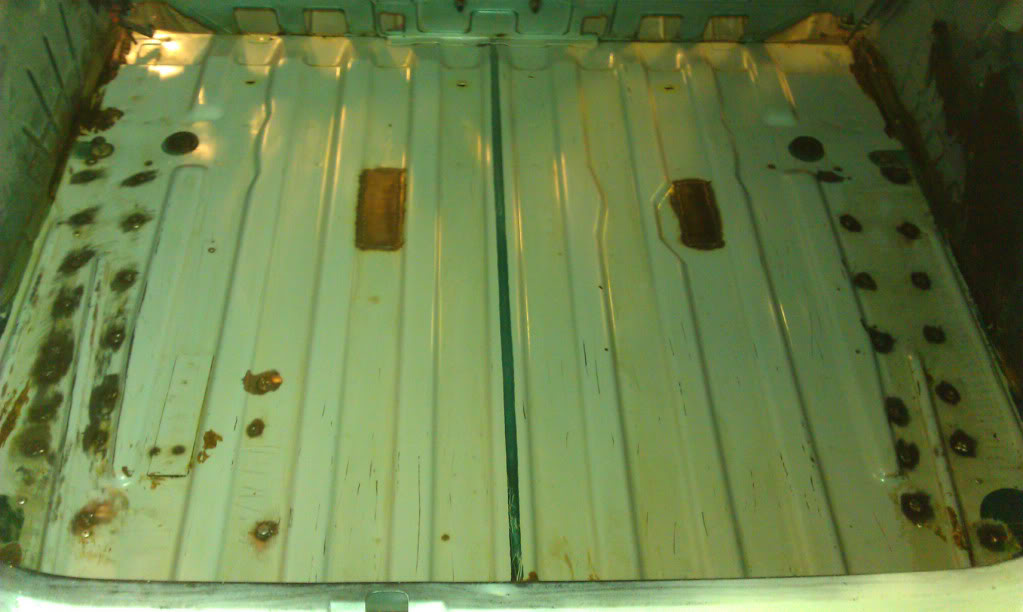

Some small progress. Cleaned the bootfloor from glue and asphalt-mat remains.
Really crappy job, but good to have it clean now.

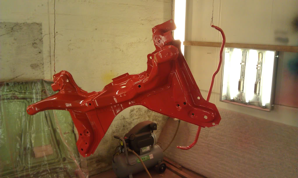

B1ack_Mi16
Some more progress.
Painted the spare subframe, ARB's and some other random parts.

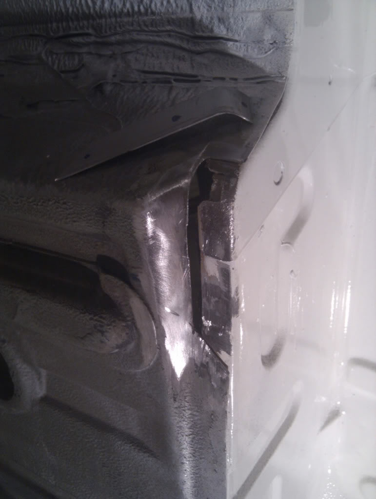

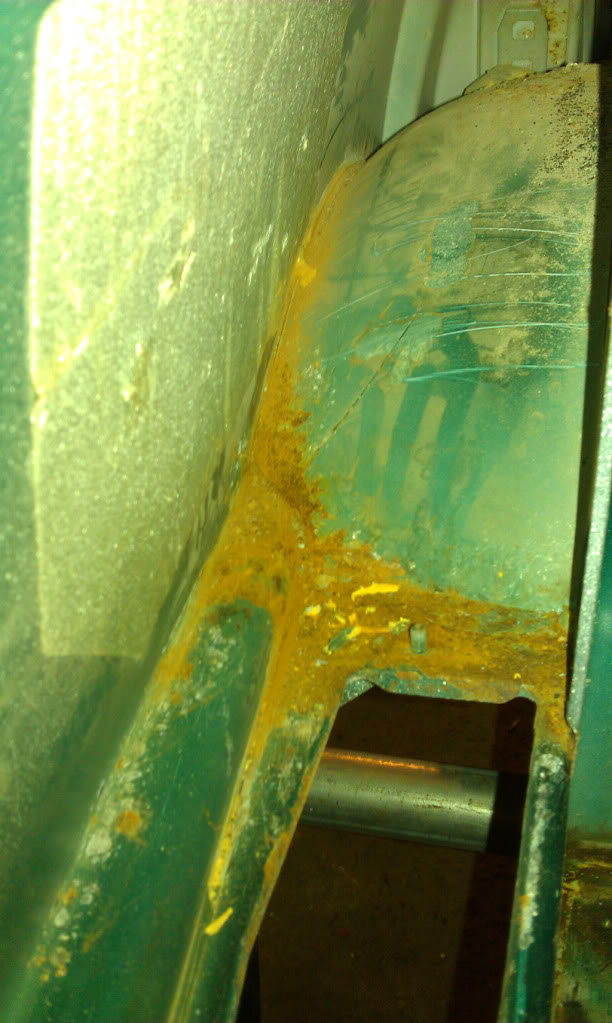

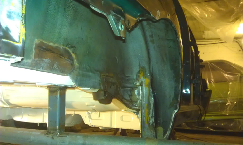

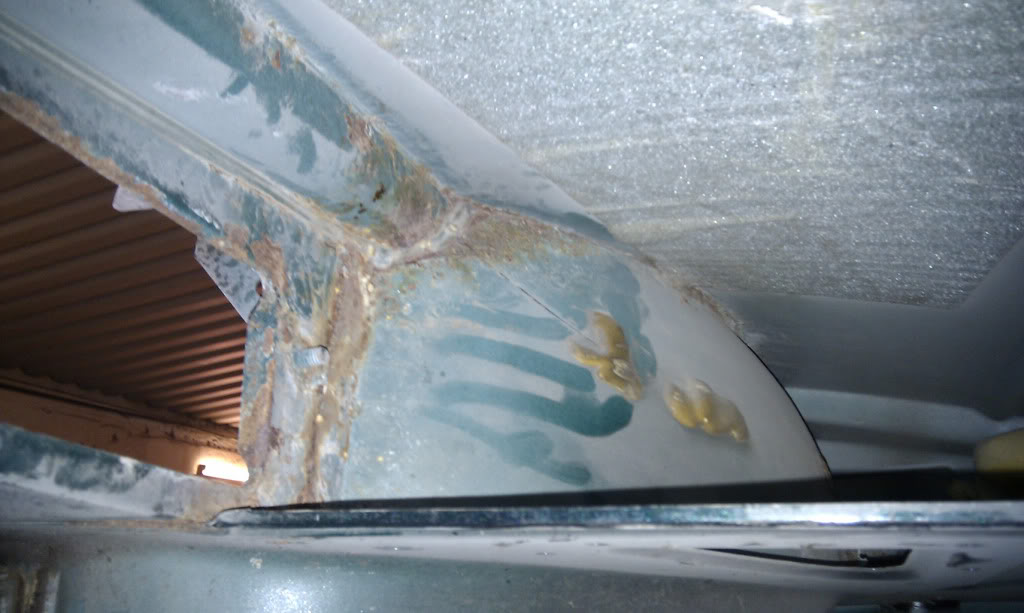

I started to look more closely into some rust I had observed from the trunk area, inside of the rear left inner wheel arch.
Sadly it seem to be quite bad rusted and the plates are getting thin...
Wondering what to do, if I shall start cutting and welding, or if I just shall try to treat it with some anti corrosion stuff.. not too tempted of more rust welding now, but agian if it's really thin it's not too good just leaving it as is either -_-

Yesterday I found even more rust when I removed some more of the factory seam-sealer inside the left rear wheelarch.
It seem to me there is literally rust all over the car if you start looking under the seam sealer. So a "rust-free" 405 is never really free of rust :)
Also cleaned up the area inside trunk etc. and at the left rear in general.
Will apply some oil and paint later when I'm done with the other side too.

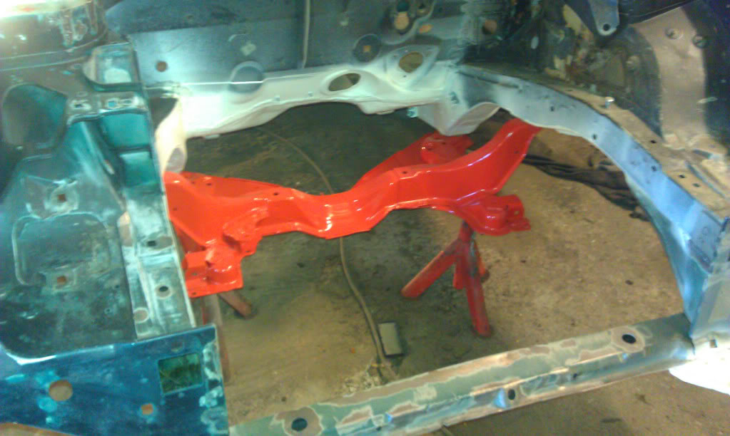

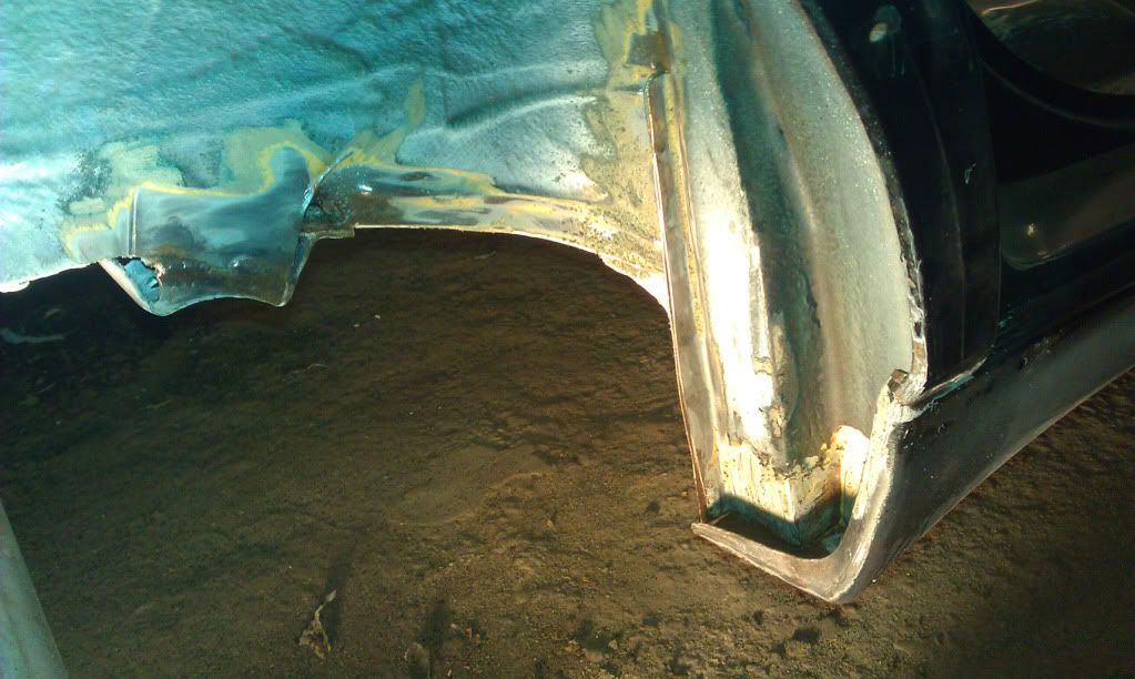

B1ack_Mi16
Slightly more progress now.
Bolted the spare subframe to the car, need to get some front suspension in place to be able to get a rolling shell, but that'll be later after more paint and such in the inner arches.
I did also put the screwdriver through the metal in the rear member on the rear right inner arch.
Very nice :)
Also quite some rust starting in the rear right sill, the orginal glue/bodyprotection mass was getting loose, so I decided to remove all of it.
Need to treat it somehow :)

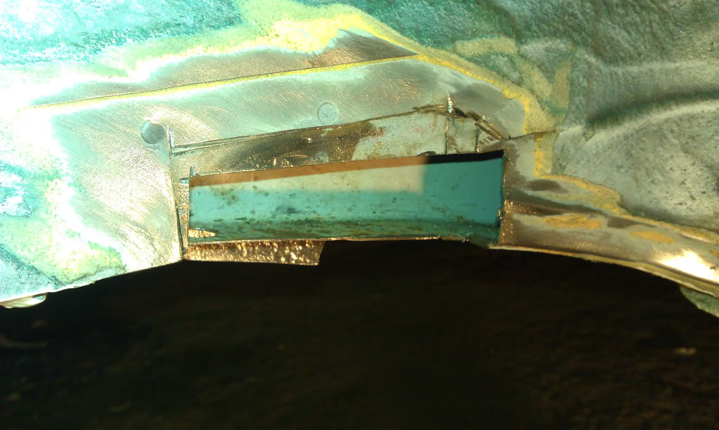

B1ack_Mi16

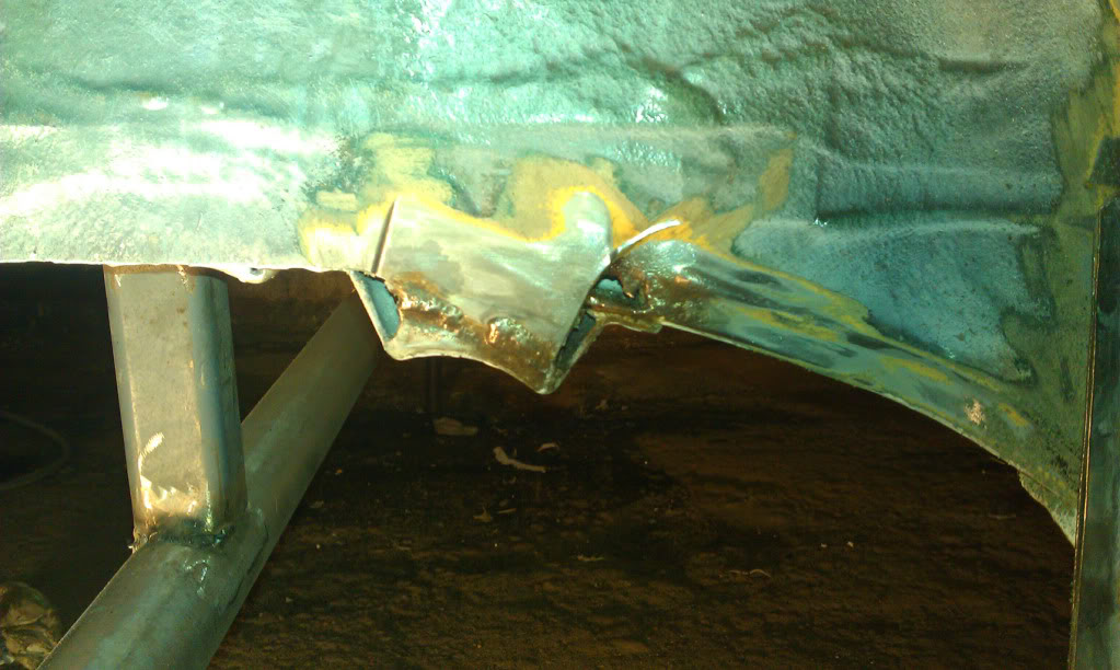

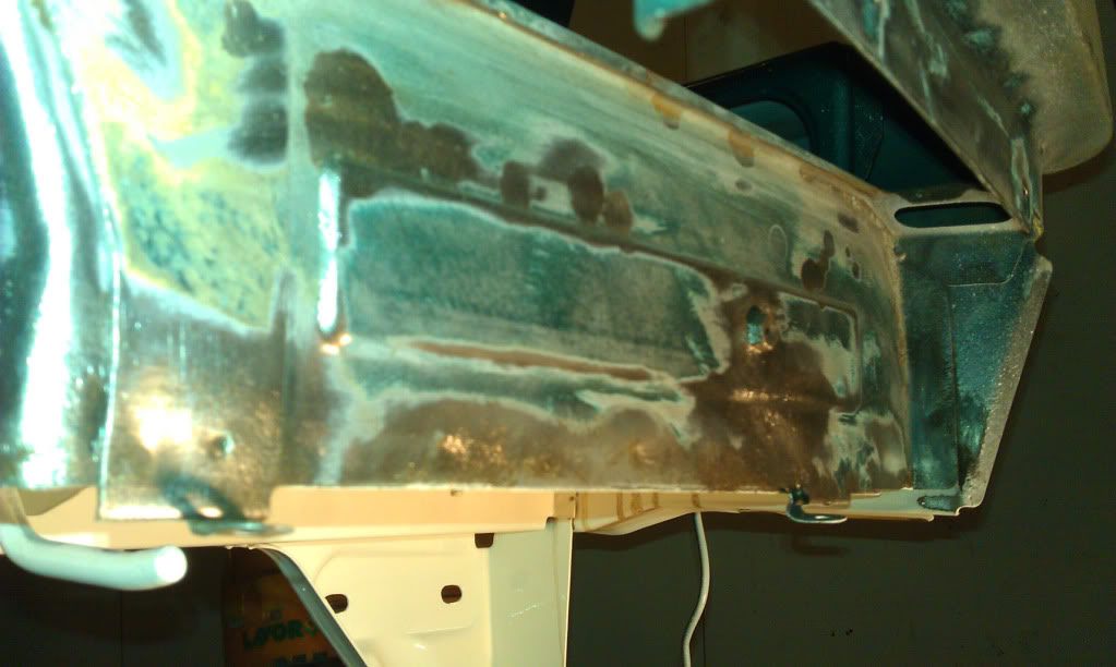

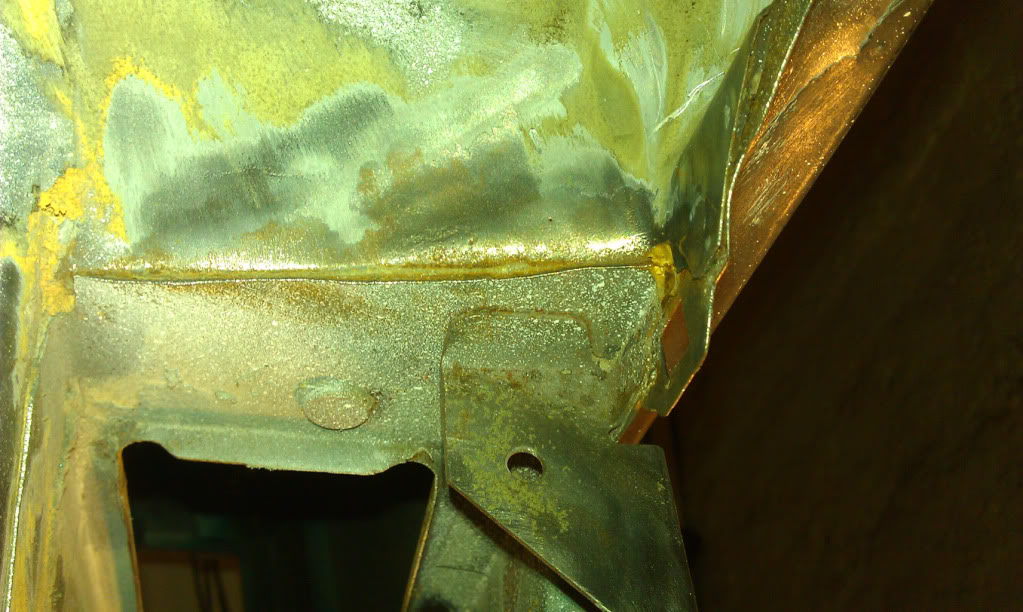

Started to cut away some metal to investigate how much rust there was.
The positive thing is that this is probably the last welding I will need to do :)

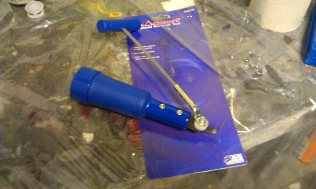

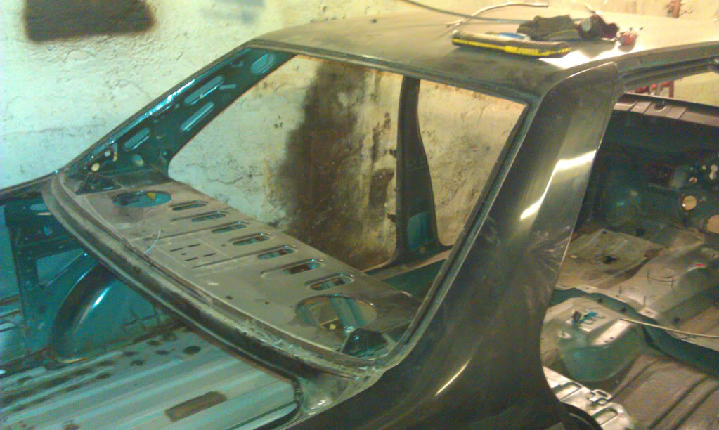

Bought a rather cheap windscreen removal knife from eBay, not the best quality, but it actually worked quite ok, managed to remove the rear screen without destroying it :)
Also finished up the welding of the rear member.
Not the nicest work I've done,, but it'll last for some time. Drilled two holes in the end and hi-pressured them with penetrating oil :)

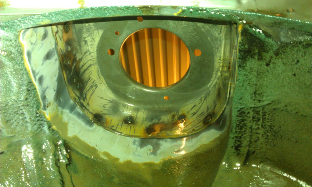

B1ack_Mi16

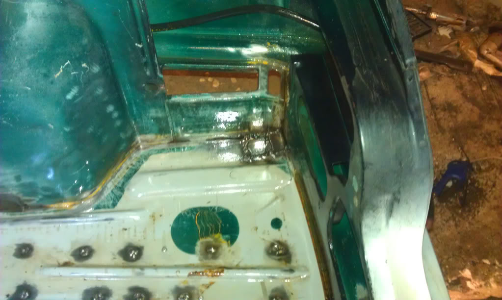

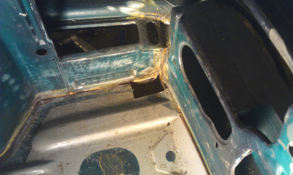

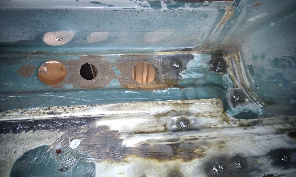

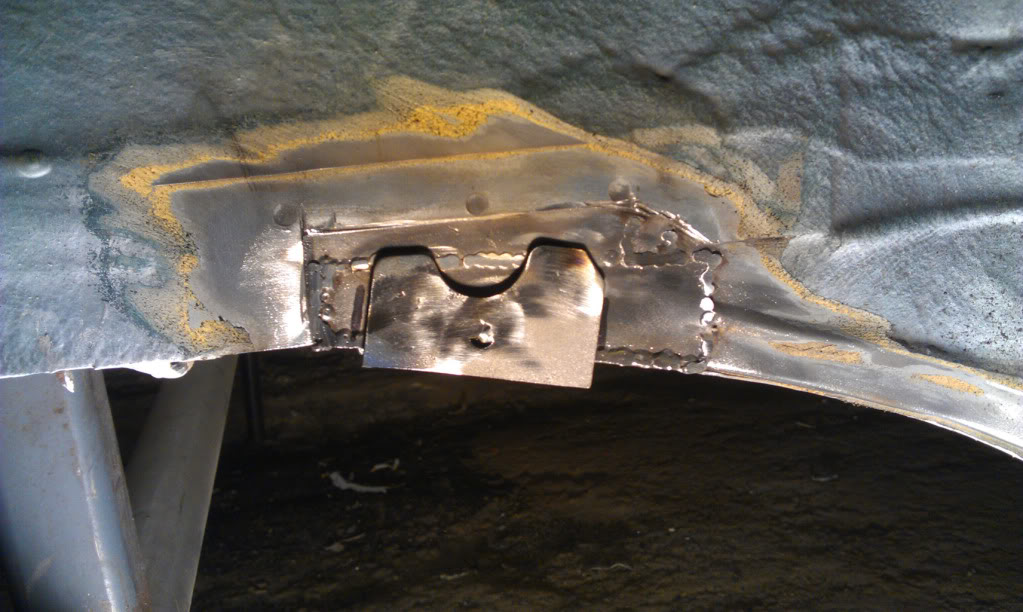

Finished up all metal-work in the rear arches and boot today.
Found a small hole in metal under the seam sealer in the very corner of the boot floor.
Cut out a small piece and welded in new metal. Horrible welding though as I didn't clean the plate good enough before, so lots of sparking.
High spressure sprayed both the boot and inside arches both sides at rear with penetrating Owatrol oil before I left today. I will add one more layer of oil tomorrow, and a third layer towards end of week. Then dry for 1 week and ready to paint afterwards :)

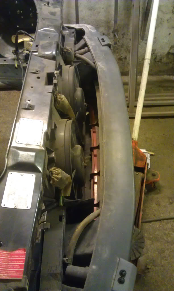

Also testfitted slam panel/fan cowling and front bumper to investigate space for intercooler.
It seem to be too tight for a front mounted IC using the standard fans with radiator in orginal position.
