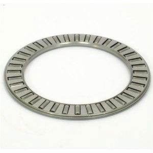

will remove the main beam seal and use a thrust bearing instead & grease it up. Cornering forces will be very like those without rear traction - mainly down to the force vectors given by the G-forces from cornering vs. friction from the tires. power through the rear wheels is still a forward motion no matter the car is cornering or not.

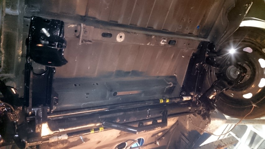

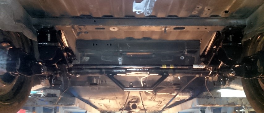

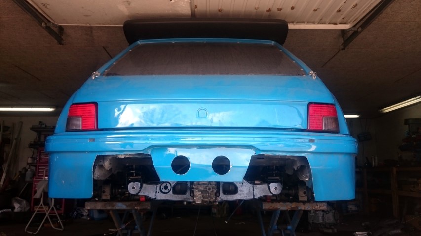

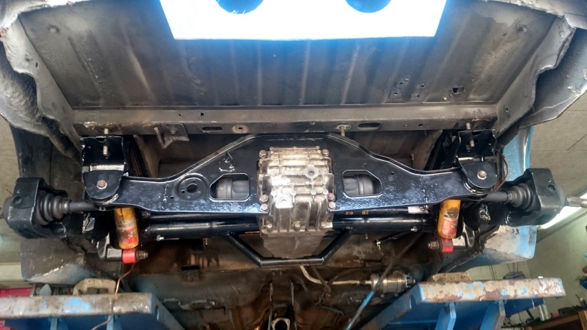

After painting final assembly of the rear beam. is commensing slowly. Rideheight is now 10-15mm higher than before - so its stance is better.Fittment of the partner torsion bars is ok,but not perfect, as they are 10mm to long.

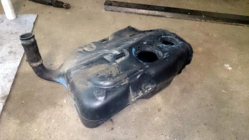

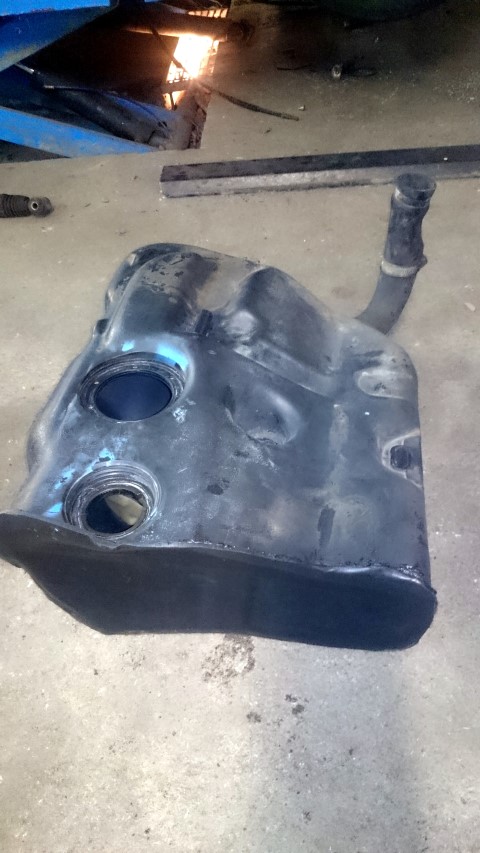

Also cut and welded the fueltank to use the left over Space for locating the rear exhaust muffler and have even better clearancenow I will be using the larger flanges for the propshaft from the BMW e39
lybker

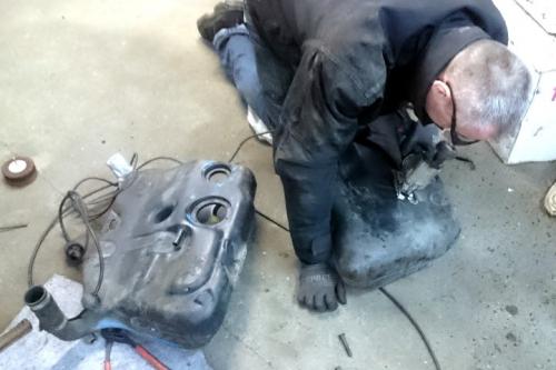

Cut the fueltank to leave room for the exhaust back end

Finalized and fitted modified rear beam and differential - check! :-)

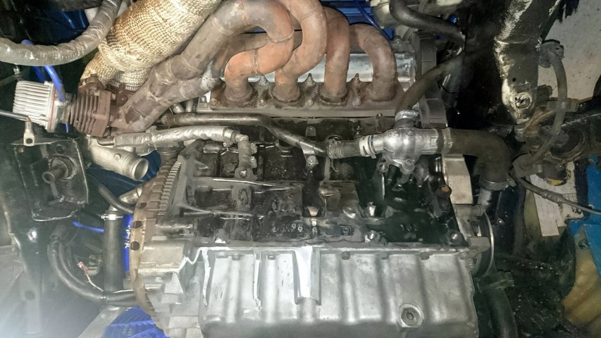

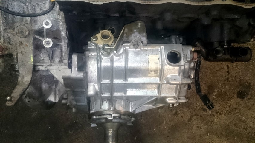

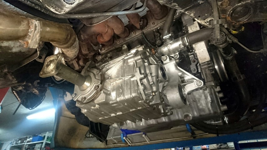

In preparation to fit the center gearbox to the xu10j4rs engine,I did a trial fitment to evaluate clearance. Basicly it will be a very tight fit!
Conclusion is 2 mounting studs and a square stump protruding from the face towards the sump had to be removed.
Another point crossed on my long to-do list, Phew! :-)

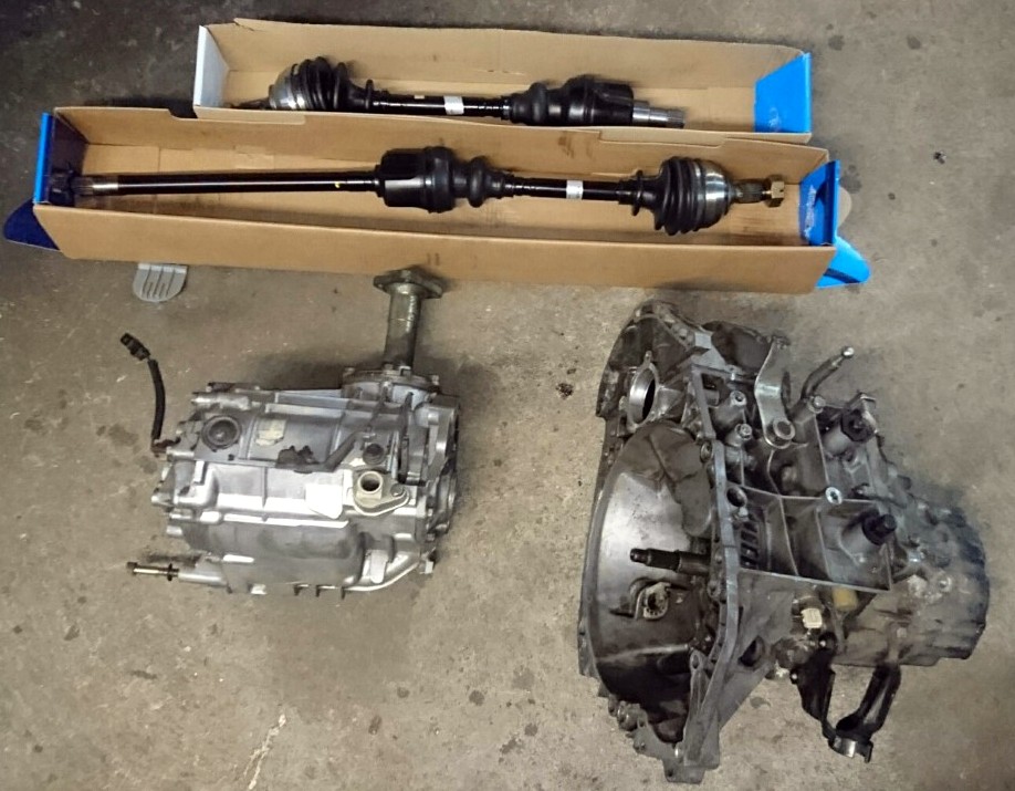

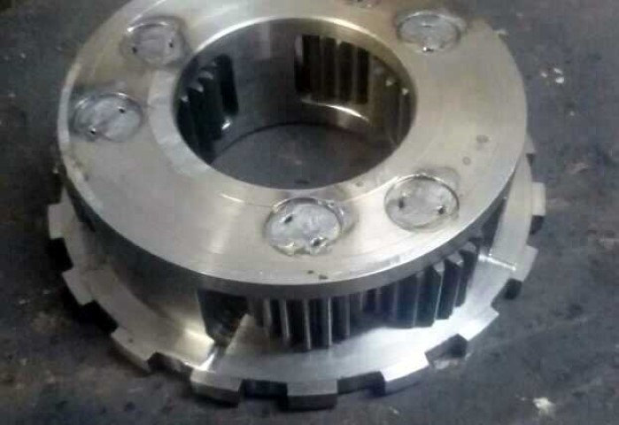

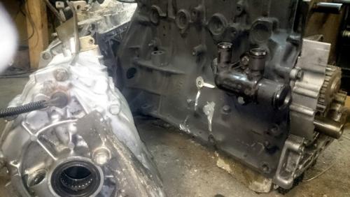

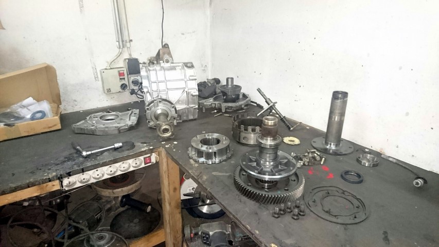

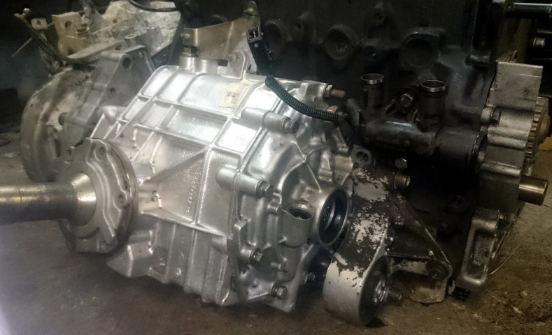

Finally I recieved my reinforced parts and got around to assemblig the center diff.

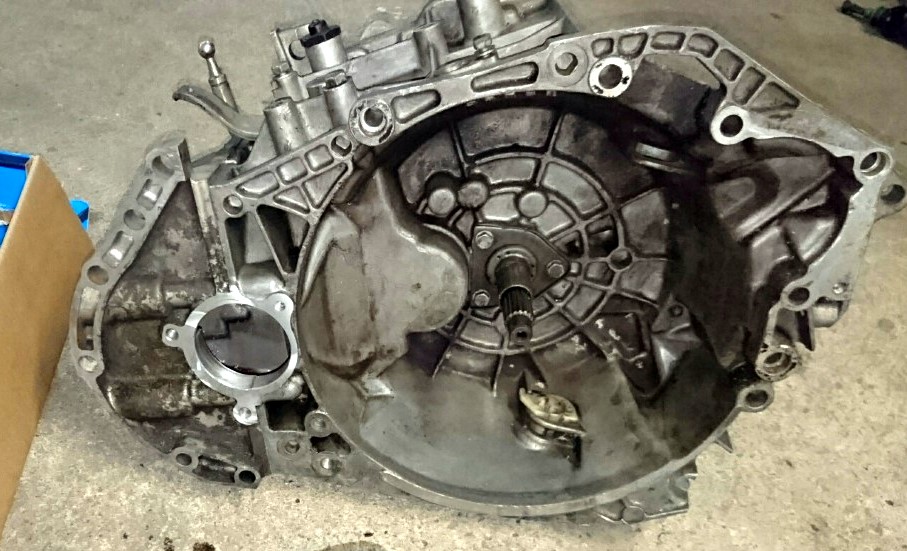

so i took apart the subframe to gain better access and removed current gti6 box. This has now been sent of to the machine shop for them to adapt it to the rear diff housing of the center gearbox. Not sure if it has been tried before - gti6 with 4x4 box? Lets see how it Works out :-)
Had to trim/shave off some reinforcements on the rear of the engineblok and cut the oilpan as the center diff is a tight fit...
I did manage to do a trial fit though:-)
...good to be back in action, hoping progress and updates will flow steadily from now on and till it runs...fingers crossed :-)

lybker
I got the overhaul kit and reinforced diff housing from atdperformance.com Unfortunatly I could not affort his reinforced shafts, and all my efforts finding alternatives failed, even I had a hold of 5-6 people mainly from Finland :-(
so now the plan is to reuse the original shafts, but when assembling the splines to fill them with Locktite 660 spline repair glue. Secondary efforts isincluding downgrading power to the 300bhp range and no slicks. :-(
I want to get it up and running, even I could not cash out the +2000 euro for the stronger shafts....

Nice build. How did you cut fuel tank and add a part to side?
lybker
...I marked and cut the tank leaving 15mm next to the fuel level senser to ensure sufficient material to weld without influencing the flange and threading for the sensor. cutting was done usng a normal jigsaw
Then I took the half-part I would like to keep and positioned it 90 degree to the most flat surface best fitting a closing plateI I could find on the discarded part and drewthe outline + 10mm. cut it using same jigsaw
then I grinded the surface that will be welded to ensure "fresh" material. Welding is tidius and needs some feel to ensure a strong bond without igniting the plastic. I used a temperature adjustable hot air gun with a 90 degree tip that is closed at the end but holes on both sides ensuring material is melted uniformly when it is sandwiched between the 2 surfaces. once it was smoking alot and very soft, I had a friend assist me, squeezing the material together untill iit was below meltingpoint. speeding this up by blowing cold compressed air.
Its actually a bit hard, but I am sure Companies offer this service, maybe it is not that expensive..?
...hope it helps - good luck

Thank you for detailed information. Actually I want to ask how you weld it ? But your instructions very detailed. I need this type fuel tank for my 106. I will try to make one. I hope it will not leak.

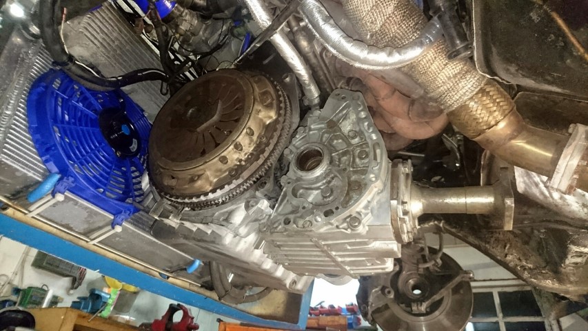

....after what seems like endless waiting, my gearbox is back. The coverplate of the 4x4 diff housing has been adapted to fit my BE3R6 box, so now there is nothing stopping the assembly process, as my bx 4x4 driveshafts have also arrived. yah! :-)
Modified is the alignment of the diff cover and the surface has ben machined so they are aligned, new pinolscrews are installed and bearing now fits the larger 67mm from the old be1 4x4 box.
Hopefully updates from now on will follow with less delay
