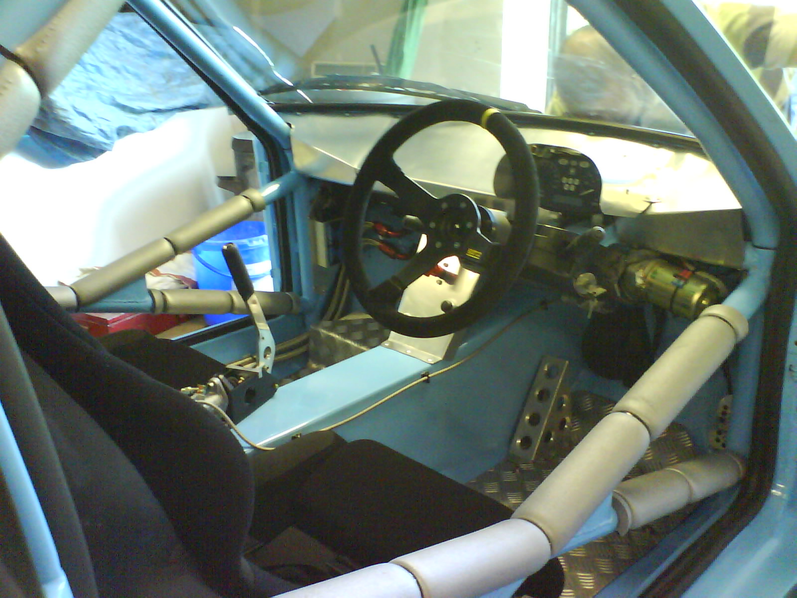

here`s my attemp of making an alloy dash , idont know weather to paint it matt black, as i`m worried about the sun shining off it and blinding me.
you`ll prob notice i haven`t yet made the gear sellector rod and fixed it in yet.

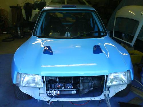

i`ve just added another pic of the car nearly finished, as the one i added the other day is a bit on the small side.
http://i492.photobucket.com/albums/rr282/dicko2008/067.jpg
http://i492.photobucket.com/albums/rr282/dicko2008/058.jpg

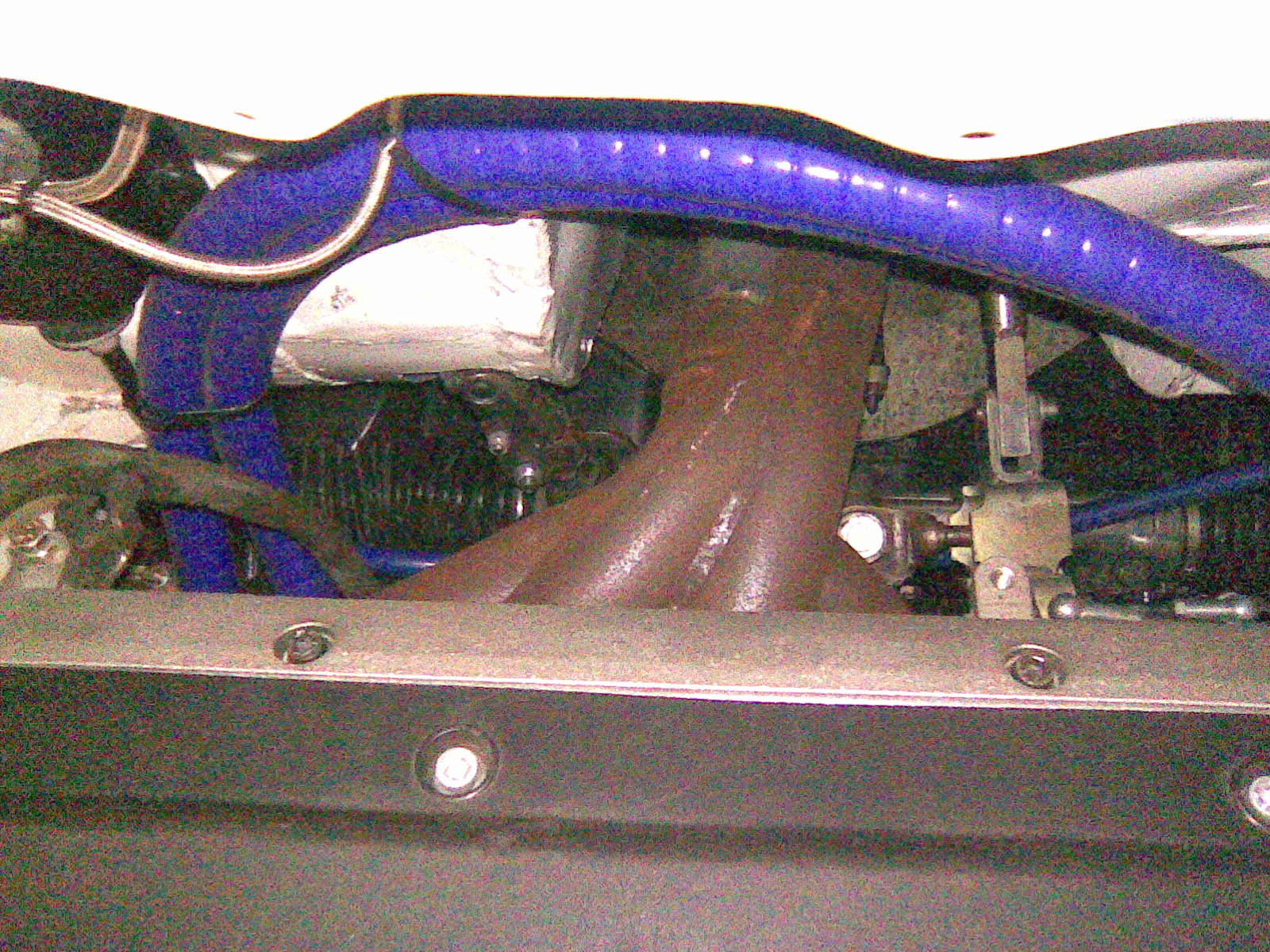

think i have worked out how to put pics on now so watch this space,heres another little taster of the under side of the car.

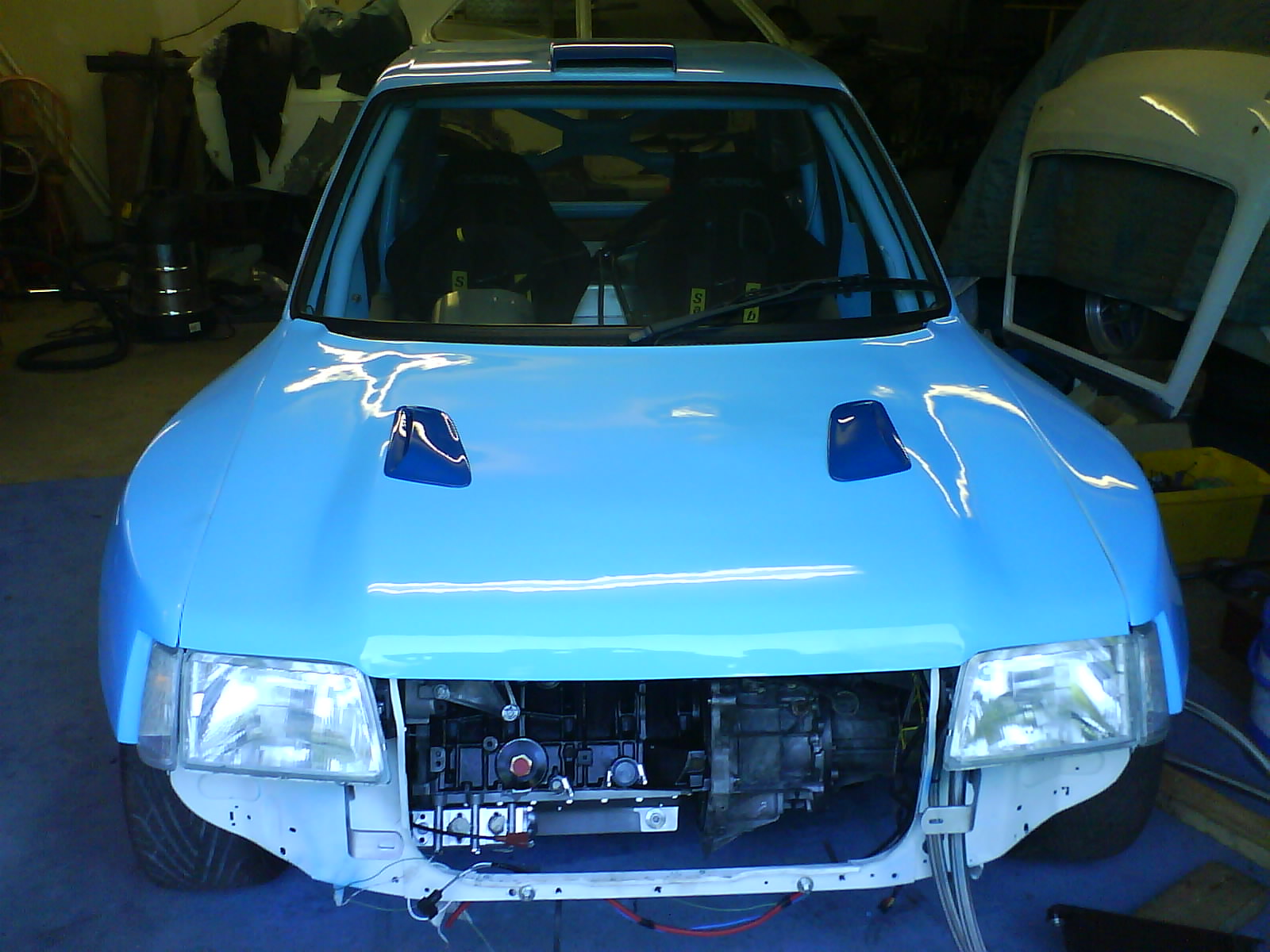

the roof vent came off a 205 shell i bought off ebay, which i also got my dimma body kit off.
The roof vent is a carbon fibre one, which i had to spray as it was damaged by the time i had got it off the shell.
You can buy these at demon tweeks at around a cost of £250, or keep looking on ebay for one to come up for sale.

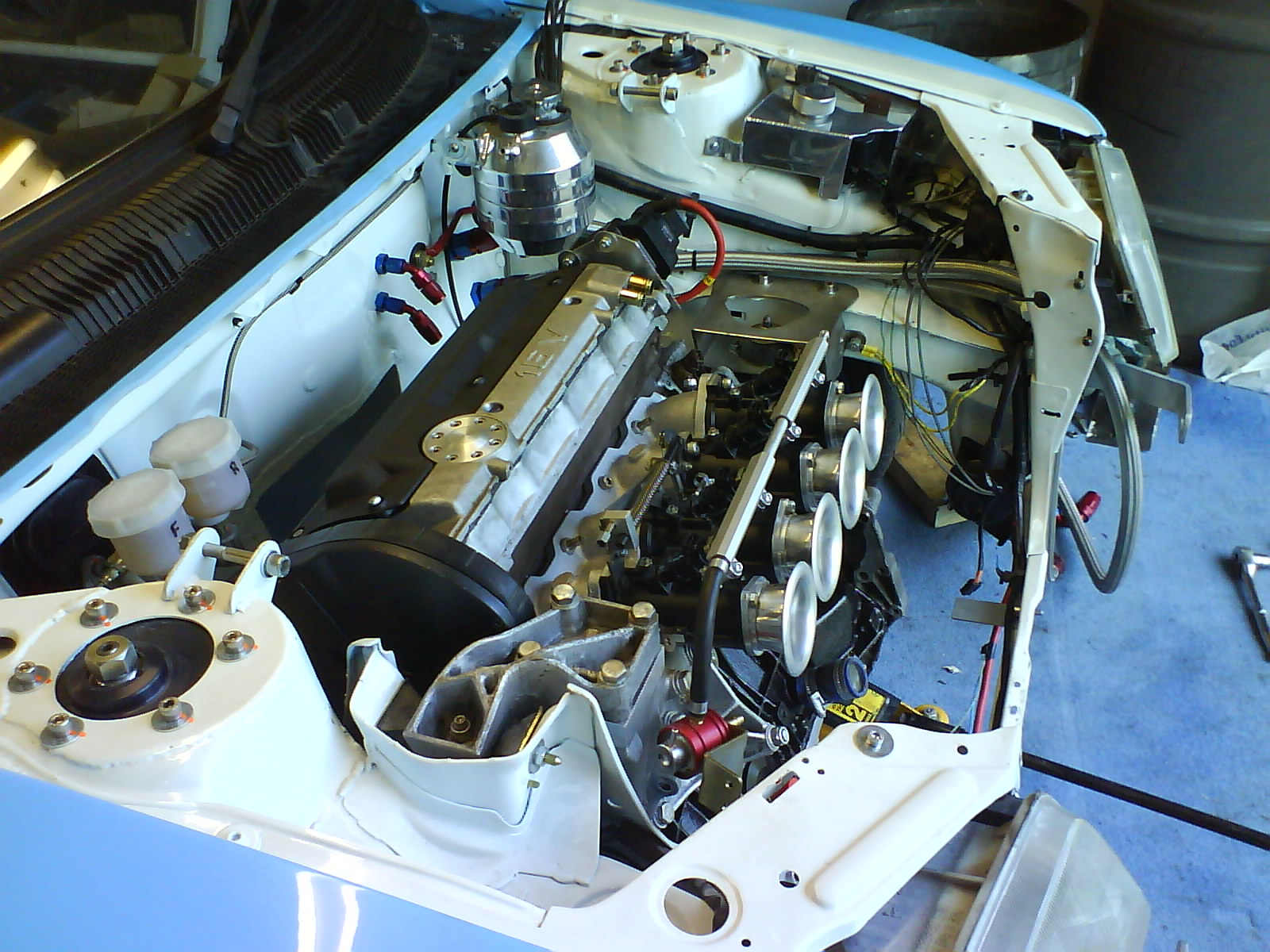

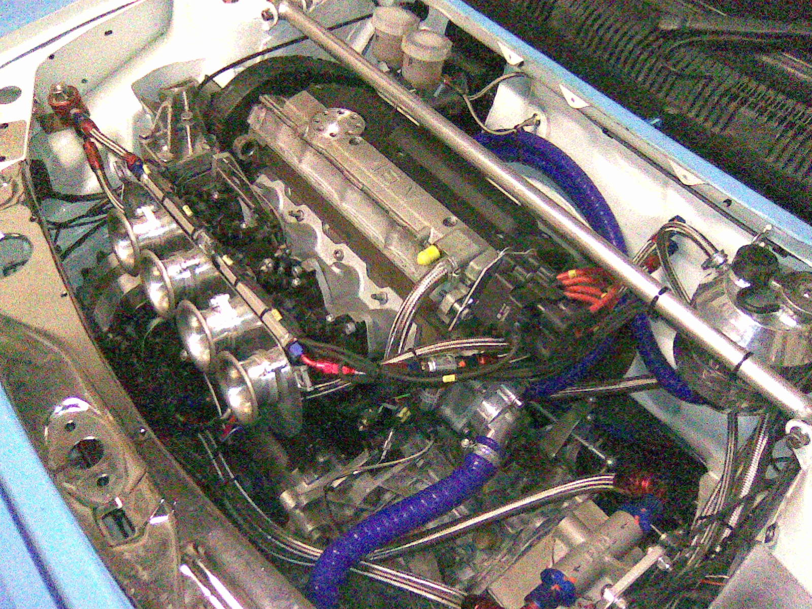

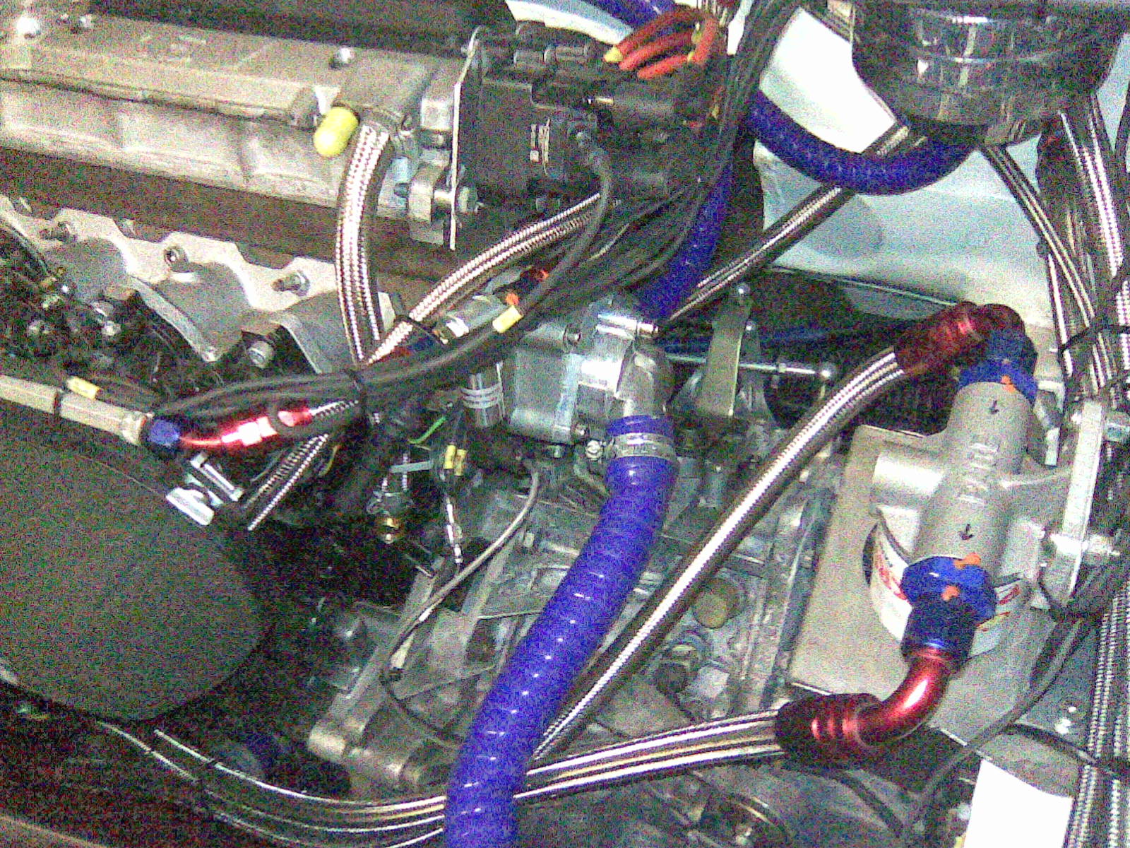

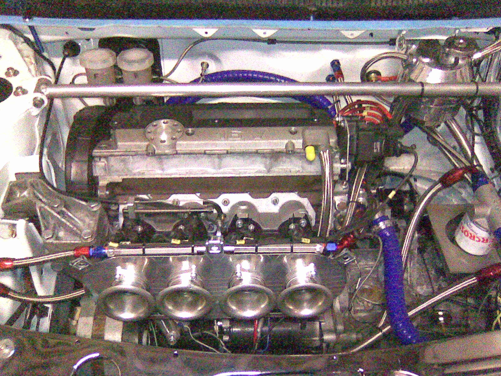

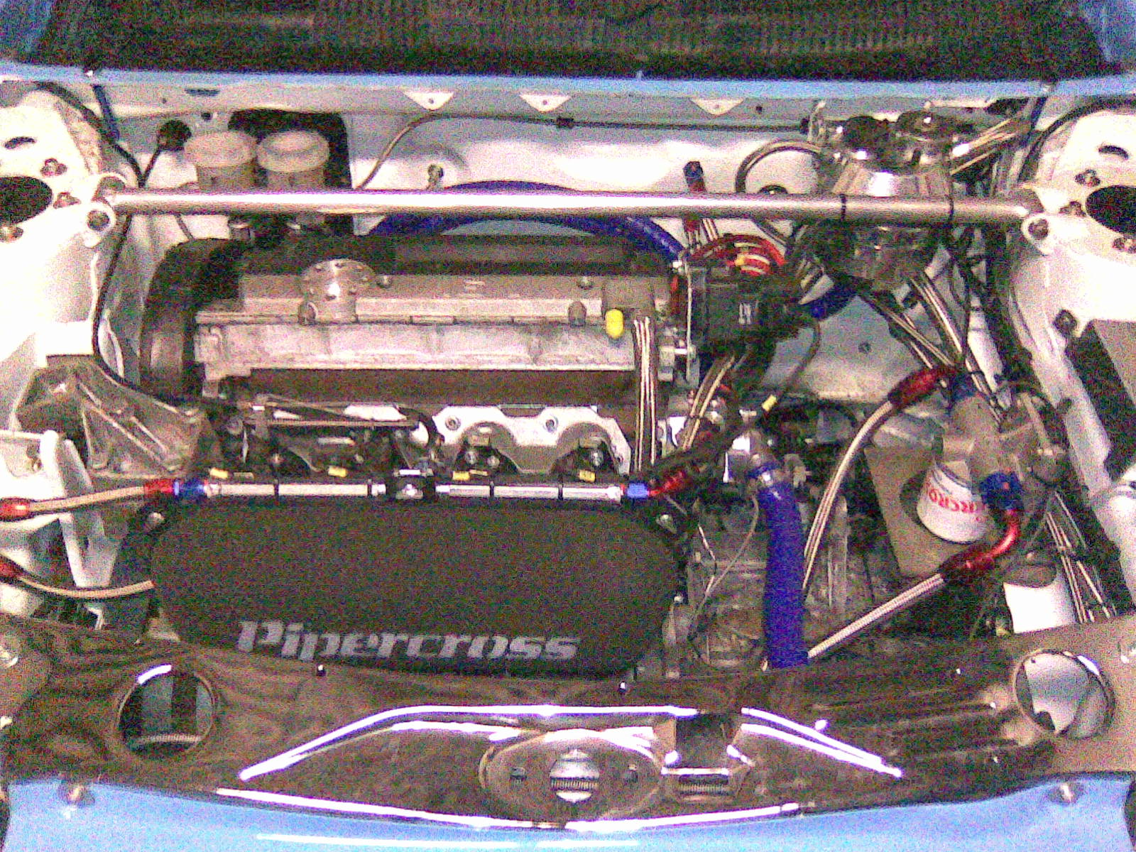

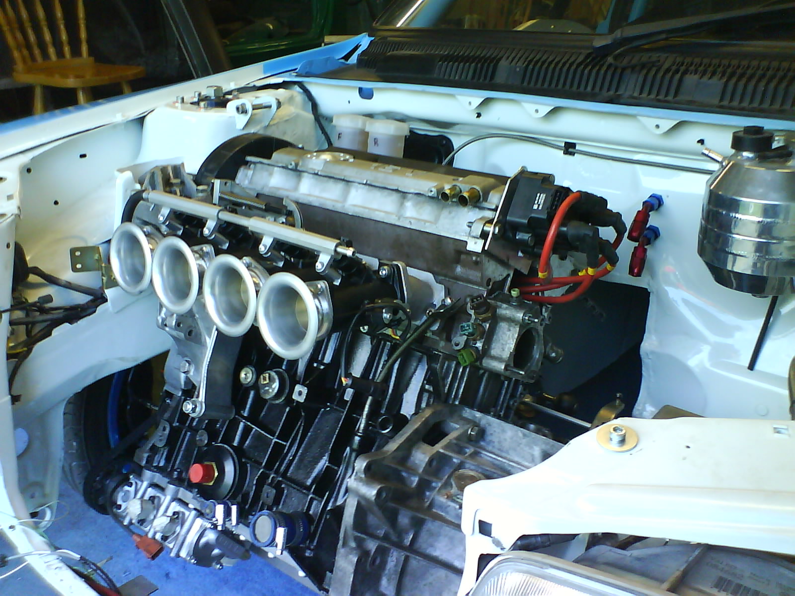

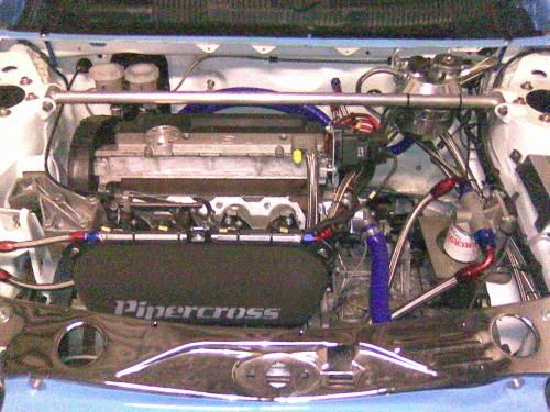

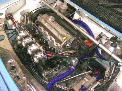

Here`s the engine spec and some pic`s of the finished engine bay.
MI16 1.9 16V ALLOY BLOCK
PEUGEOT MOTORSPORT 405 BTCC STAGE 3 PACE DRY SUMP SYSTEM+DRY SUMP TANK,REMOTE OIL FILTER AND BREATHER SYSTEM.
SETRAB 16 ROW 235MM OIL COOLER
IAPEL 88MM FORGED STEEL CRANK
IAPEL 83.5MM FORED PISTON`S,PISTON RING`S AND RINGED LINERS
COPPER HEAD GASKET
COMPRESSION RATIOOF 12.1
CATCAMS FORGED STEEL ROD`S
CSL RACE BEARING`S AND SHELL`S
FIDANZA 3.4KG ALLOY FLYWHEEL
RADTEC ALLOY RADIATOR
HELIX COMPETITION 4 PADDLE CLUTCH+COVER ASSEMBLY AND RELEASE BEARING
NEW STANDARD STARTER MOTOR AND ALTERNATOR
NEW WATER PUMP
306 GTI-6 STANDARD HEAD(FOR NOW)WITH NEW VALVE GUIDES
CUSTOM BLANKED OFF OIL FILLER CAP
CATCAMS RACE CAMS INLET 293/285 DURATION 13.75MM MAXIMUM LIFT, OUTLET 260/252 DURATION 13.25 MAXIMUM LIFT.
CATCAMS VERNIER PULLEY`S
CATCAMS SOLID LIFTER`S
CATCAMS DOUBLE VALVE SPRING`S AND RETAINERS
MODIFYED OIL SPRAY BARS FOR CAMS TO CLEAR.
OMEX 600 ECU
JENVEY 48MM THROTTLE BODIES
PIPERCROSS AIR FILTER
BOSCH 375CC FUEL INJECTOR`S
SYTEC MOTORSPORT FUEL PUMP
SYTEC HI-FLOW FUEL FILTER
SINGLE GM COIL PACK
MAGNECORE 8.5MM RACE HT LEADS
MODIFYED LONGMAN 4-2-1 EXHAUST MANIFOLD
CUSTOM 2.5INCH STRAIGHT THROUGH EXHAUST SYSTEM WITH TWO ESCORT TURBO DEISEL SILENSER`S AND SINGLE SIDE EXIT PIPE
MODIFYED WATER HOUSING
SILICONE WATER HOSES
ALL THE OIL LINES AND FUEL LINES ARE GOODRIGED -12,-6 STEEL HOSE`S WITH ALLOY AEROQUIP FITTING`S
THIS ENGINE SPEC SHOULD PRODUCE BETWEEN 250-270 BHP AT 9200RPM REV LIMIT.
IT IS STILL WAITING FOR IT`S FINAL MAPING SESSION WITH NEAL WHO BUILT THE ENGINE FOR ME AT DES DEVELOPEMENTS.

calvinhorse
excellent project its gonna be a real monster!

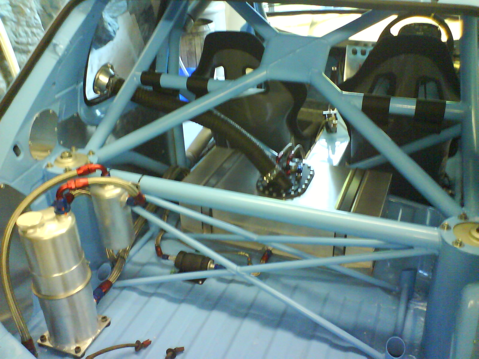

do you have any pictures of the drysump setup?
Batfink
Going on the filter its the one made by Pace :D
