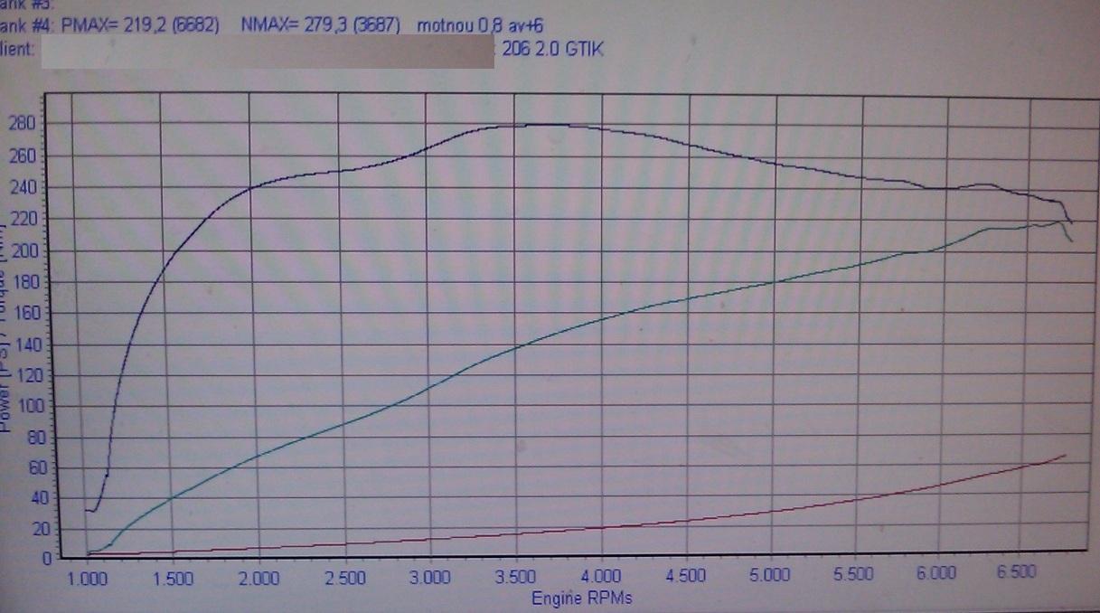

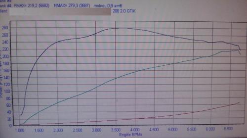

Guys, that's it. Clean 220HP and 280Nm at 0.8 bar peak pressure. No intercooling.
I don't want any more from it, maneuvrability now is an issue and will invest my money in handling rather than engine.
Maybe I will add an intercooler in the summer plus longer heads inlet manifold and probably will go for more HP but right now the car pulls like a beast. It's more than enough for me for city driving, much above that will become dangerous for traffic safety.

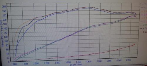

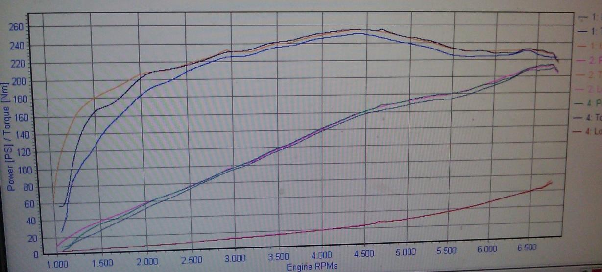

Ok installed an intercooler, IAT is now around 20-25 celsius (80 celsius lower), no power gain even with 6 degrees spark advance. Wtf?:(
Water merg spray is now after supercharger, right before manifold. Using 3gph nozzle, no gain but 10 hp loss. Something must be really really wrong.
