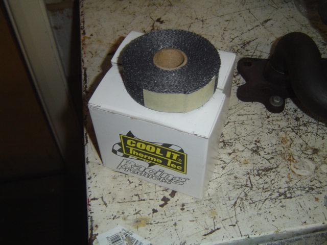

The exhaust manifold has now been wrapped and I await the new nuts from pug to fit this.

How much manifold wrap did you need to use?
I used 4 of these,
I bought 2 to begin with but It wasn't enough. Bought the inch wide wrap from here. . .

Cheers Ed, do you know if the rolls you got were 15, 25 or 50 feet as they do 1" in all of those sizes?
No worries, it was these ones.
http://www.agriemach.com/product_info.php?...products_id=695
It worked out perfectly with no scraps cut off. I used Cv Boot metal ties to hold them in place but metal zip ties would work too i'm sure.

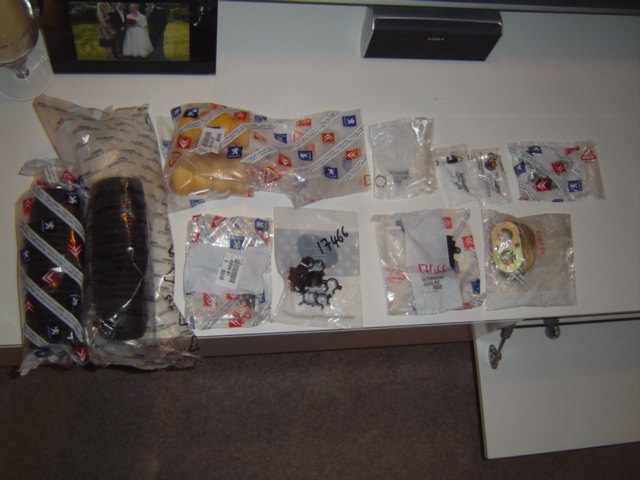

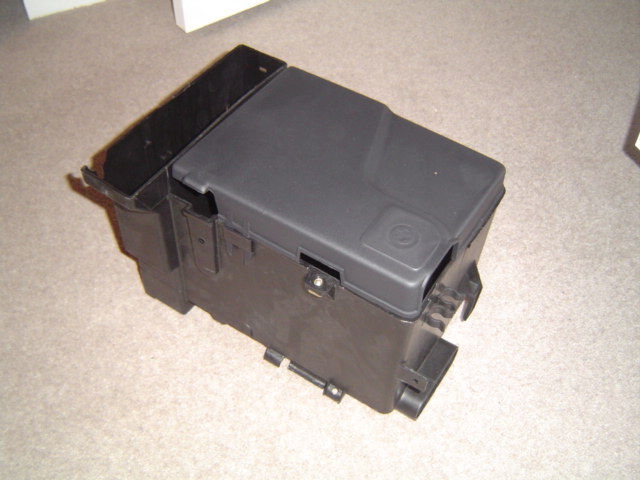

Picked up some more bits from Peugeot, cheers Matt! ;) new battery box/lid, rebound stops for the front shocks and various brake/ fuel pipe clips etc etc
