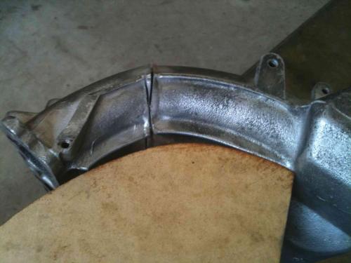

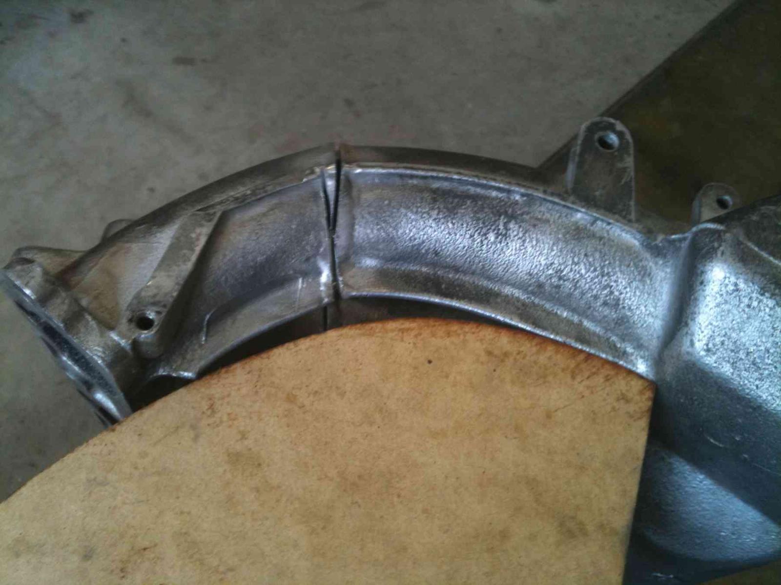

I can tell you that the shortened inlet manifold is very poorly done. Notice how it kinks at the weld? I've done many shortened inlets. I have a template/jig that maintains the original radius of the runners. I recently repaired an inlet that was bought from Spoox by a guy here in Sydney. It was so bad, that the inlet manifold and alternator couldn't be fitted at the same time! Inside, where it really matters, was appalling. There were big penetration dags inside which would have severely affected port flow. Goodness knows why these weren't even attempted to be cleaned up. The big fat welds on the outside of yours also tells me the TIG operator was a novice. A good manifold has nice flat welds, which are very difficult to detect after grit blasting. Only properly vee'd welding preparation can achieve that. Sorry, it's a crap job and probably why shortened inlet manifolds get bad press in the UK.

This is the Spoox manifold I had to repair. You can see from the template how far out it was.
eep! :blink:

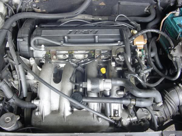

Also. the breather/ICV pipes are incorrect. Notice how they should cross over. The ports in the rubber duct are different.
I have tightend up the alternator this week and i found that it wasnt difficult to get to and i am shocked to hear about the inlet manifold being s*it the tutors at college were total loving the welds on it hahahaha. I wasnt too keen on how packed it does make the engine and i am going to get the breather pipes sorted asap as well. How would i be able to to sort the inlet manifold thing just now? just until i can afford to get the throttle bodies in. I am going to give the breather pipes a going over today
@ Pitcrew How easy was it to get the inlet manifold out? Your picture is the spitting image of my engine bay ( bar s*itty welding and breather pipe placement) and also do you get the mayo as well ? Being in a roasting hot climate and what my tutor said about it happening with cold air passing over. First time i have heard of pugs in Austrailia , that is awesome as f*** like.
Also would like to know if anyone has had the throttle problems that i have been getting from start up or is that part of the quirks?
I didnt know different as this is my first swaree into pug ownership but i am going to have it fixed as i am quite attached to my little car i want the throttle bodies onto it and also wanted to have the engine out and cleaned up also going to redo the ignition system and the brakes too as i think a seal may have popped on the master cylinder soft as s*it pedal even after bleeding #

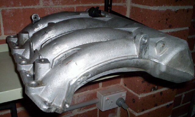

Here is one of my early ones.
