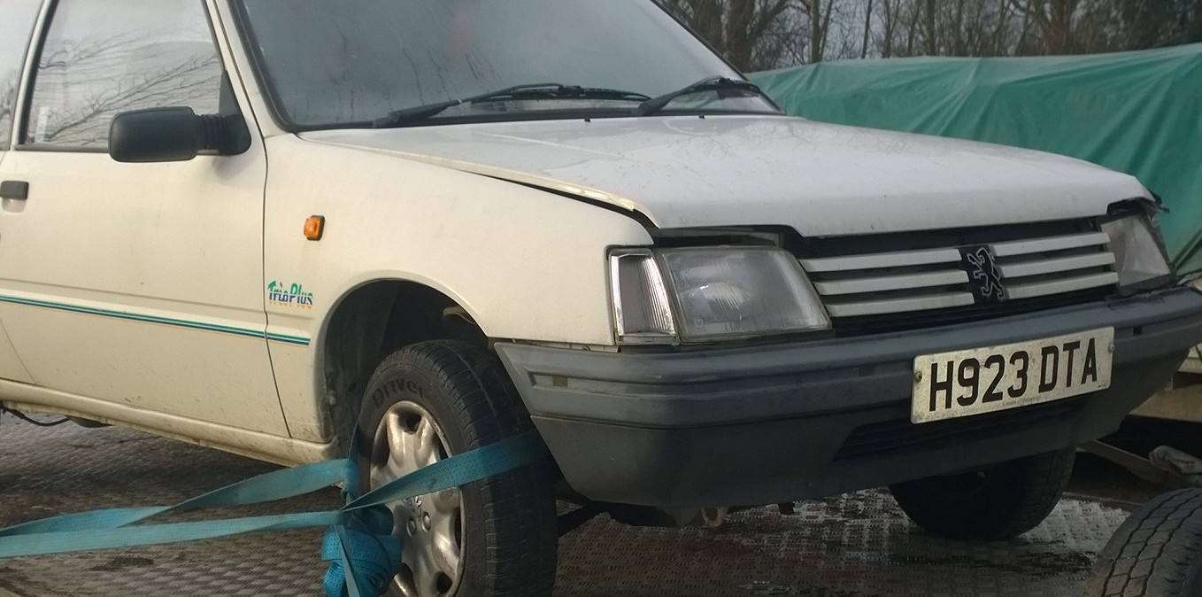

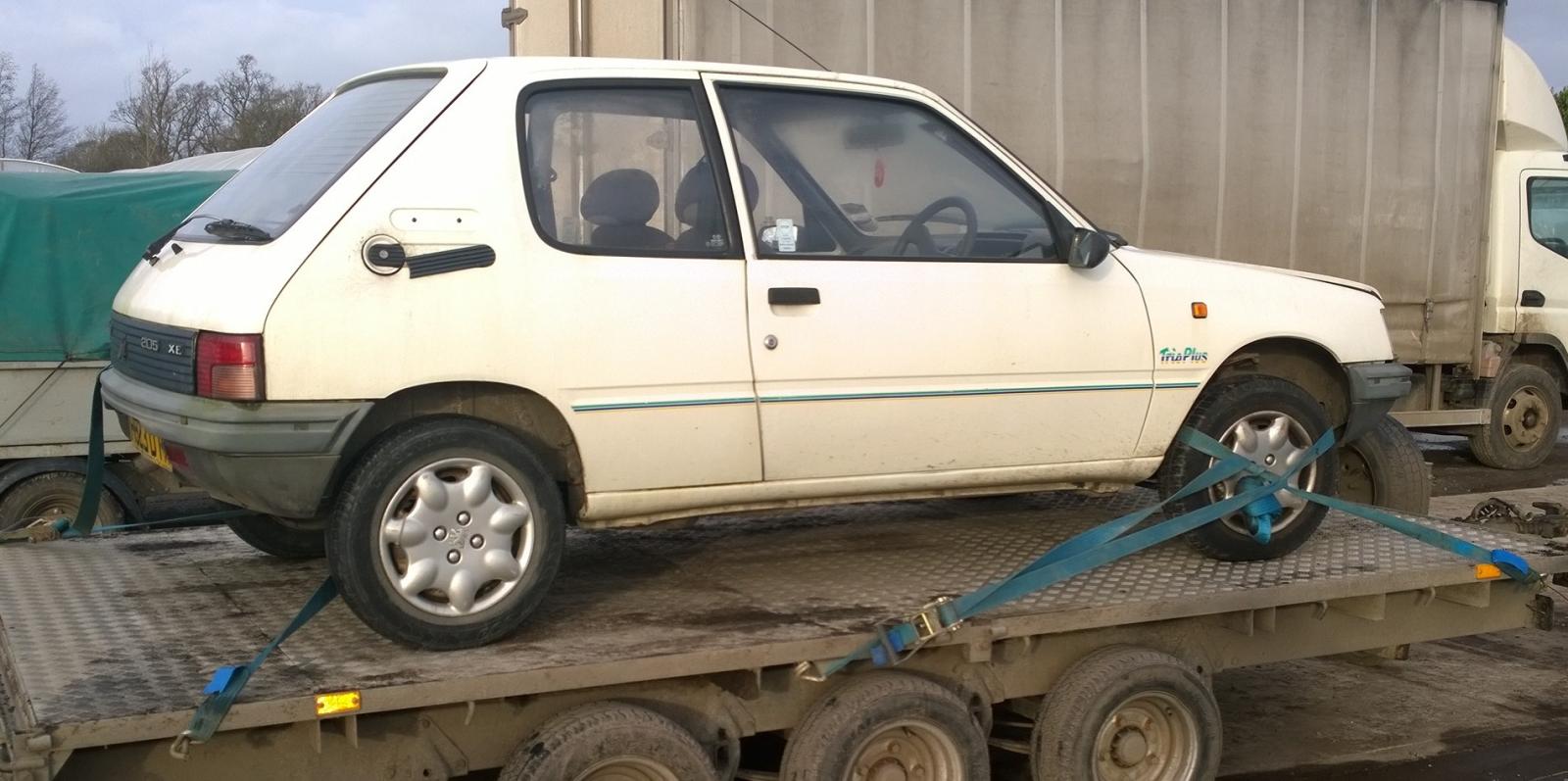

so last week I put an add out on here after a 3 door base model, and last night I went and picked it up. After 6 hours of a drive down country to north Devon, and 5 hours back to Shropshire I can say I am a proud owner of a 1.0l 205 xe!
first job is to sort out the bodywork. It needs a n/ wing, headlamp, indicator and possibly a bonnet if I cant straighten it.

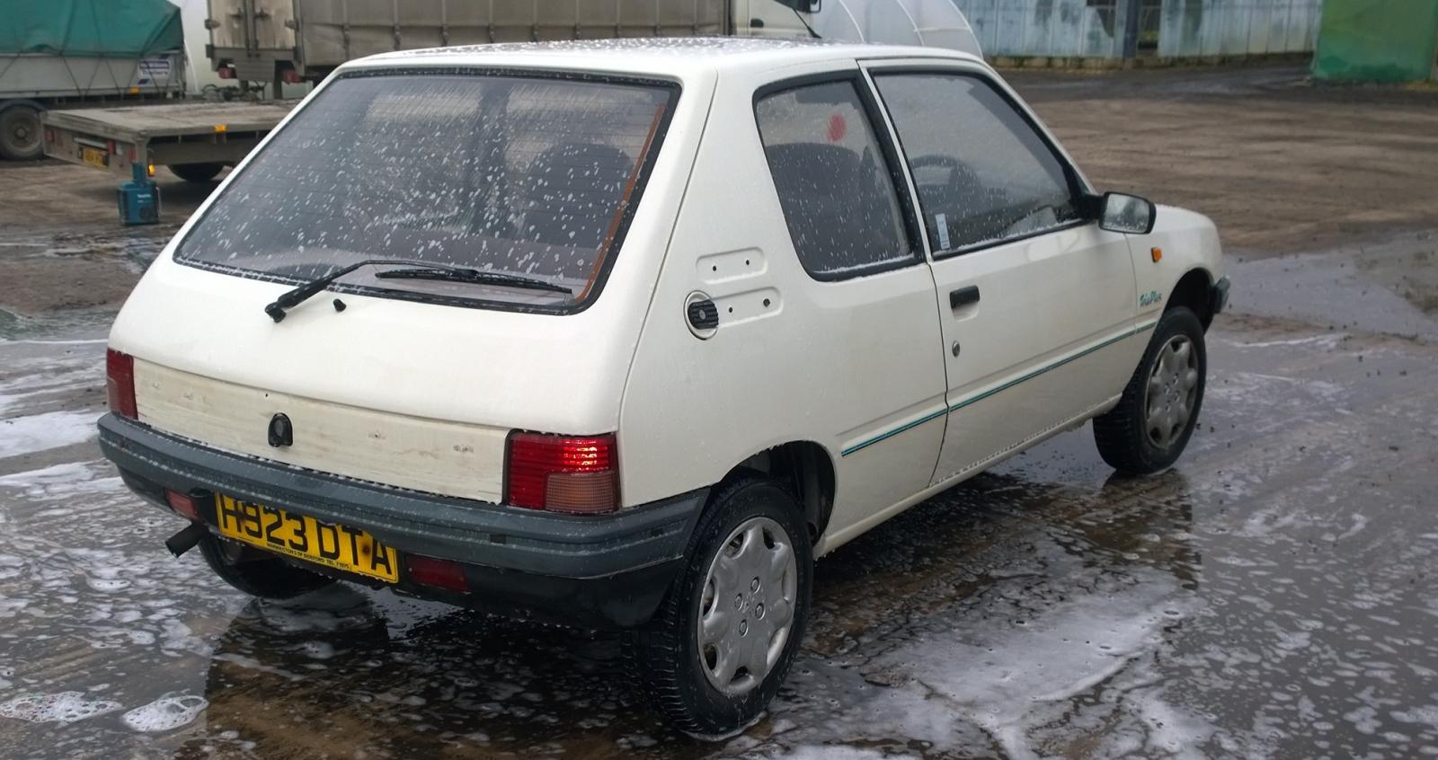

this morning I went into work and washed it off and removed the boot trim. Rest of bodywork is nice and tidy. Will need some t-cutting as some areas have started to go off white.

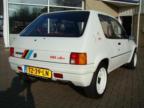

next stage is to remove the gti vanances from the cti, prep and paint them ready to go on after I source a wing. Rallye grille, boot and wing decals are ordered. I am also looking out for some rallye arches to complete the exterior. Also looking for a thick black stripe decal to go in the recess between front and rear arches.

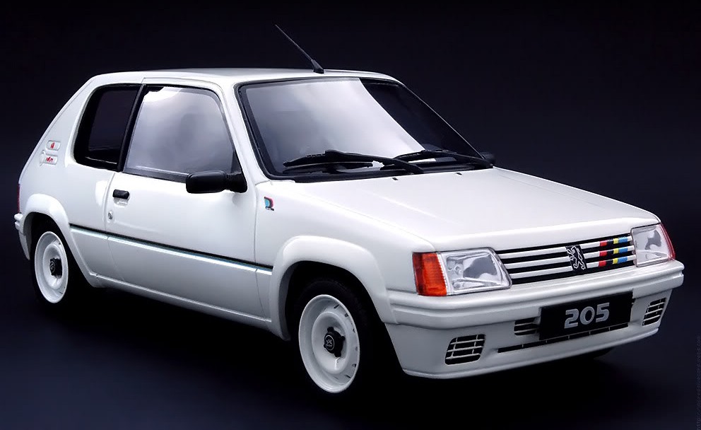

if the finished product looks half as good as this ill be a happy man!

It isn't a thick black stripe but the PTS colours in the examples you have in your photos. If you want a thick black stripe, an XS has a rubber moulding on there. Personally I think they look best with nothing as the front bumpers have nothing either.
tomcolinjones
never seen one in the flesh, I just thought it was a black stripe! I'll look into getting something made at some point.

I am with Henry on the side decal being PTS colours. The complete set of Euro Rallye decals are for sale on Ebay France. Check the link out below.

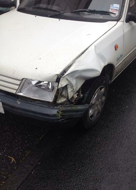

here's a couple of pictures of the damage. Shouldn't be too much of a problem. Inner wing / slam panel / headlamp mounting will need a bit of re shaping, Nd I don't think ill get the creases out of the bonnet.

got the bent wing off and did a bit of body beating getting the inner wing back to a good shape, needs a little welding and it will be good as new.
ive pulled the headlamp brackets / adjusters of the cti as these where all cracked from the bump .
bumpers and valances are off the cti, and the wing was surprisingly easy to remove, i just tapped a sharp chisel through the seam sealer and slowly pulled it away.
