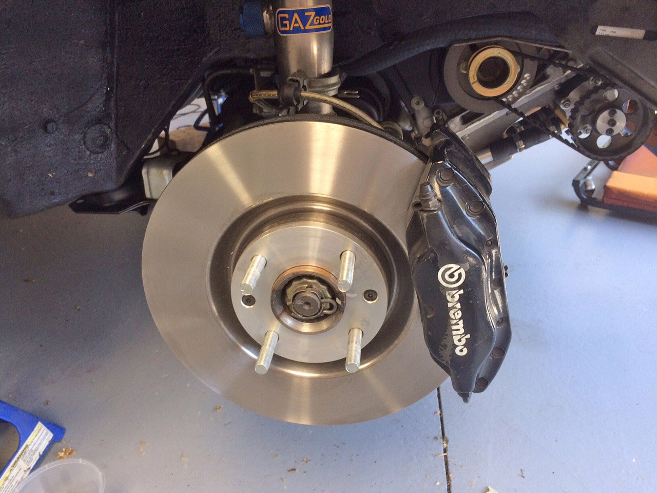

Took the car to Phillip Island last Sat for Rnd 7 of the MSCA SuperSprint series.
I was hoping that the new lca balljoints would have solved my vibration under brakes. Frustratingly no!
For the price of some tie rod ends that'll be the next 'fix'. I can't think of anything in the rack itself that could be the culprit.
