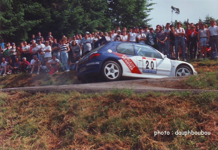

JamesLumley
Do you reckon I can get them to fit then?
This is a very rare set of speedline corse wheels (set of 6) They came off a 306 kit car they should fit any peugeot 106 205 309 206 citroen xsara saxo etc or even ford with a 4 x 108 pcd. I am not sure if they are a set of aluminium or magnesium but they are very light and came with a ref GAI Si Mg SL1440 i assume the mg signifies that they are magnesium wheel but please check Speedline is the leading performance wheels for the WRC and other motorsport see details below. They are made in Italy with the width 7 JJ x 17 ET15 The other markings are PCD 108/P1 4211D T6 . They will be ideal for motorsport rally or track car and will give any car an aggressive look and better performance . They cost a fortune and are retailed at more than 250 pounds each. The only reason i am selling them is that i am moving house and space is a real problem i am very reluctant to sell them and will not let them go for less than 400 hence i reserve the right to end the auction at any time. They need some cleaning as were kept in the shed They came off a group A maxi kit car i have clean one in the picture
Dj_mini
17's are going to need some big arches arnt they?
naah just smaller tyres, they'll go straight on with 40 profile tyres, very nice, and certainly in keeping with the Maxi widetrack build :P
Dj_mini
I doubt your get rally tyres in 40 profile? ooh maxi rep we need more details :P
seen a Saxo kit car on 40's :P not that it matters really as speedo accuracy doesn't come into it in a race car, affecting the final drive does though.
not wheels to use on bumpy stages I guess! do you need big rims for your brakes James?
JamesLumley
Brakes were part of the reason, tyres are much wider choice when you get to 17s. Hoping also to improve high speed stability.
I will probably run 220/640/17 or 190/650/17 as these are the dunlop sizes. Michelin do a 200/615/17 as a backup if the dunlops won't fit.
My 15" tyres are £150 each but the 17s are only £88 each - just the saving on 6 tyres will nearly cover the rim purchase!
It will certainly be a squeeze to make them fit - lets hope the arches I have will be wide enough - otherwise it's out with the grinder...again!
If all else fails, they can always be sold on...they retail at £400 each so I should be ok on price I paid.
Ahh, was watching these, i think a friend was bidding on them for his 306 Maxi. (rep) Pretty few and far between i should imagine!!
