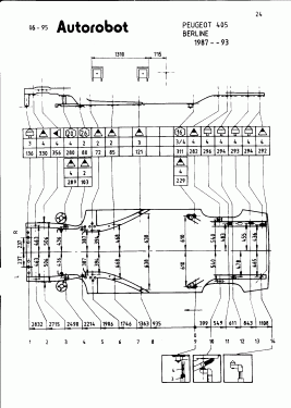

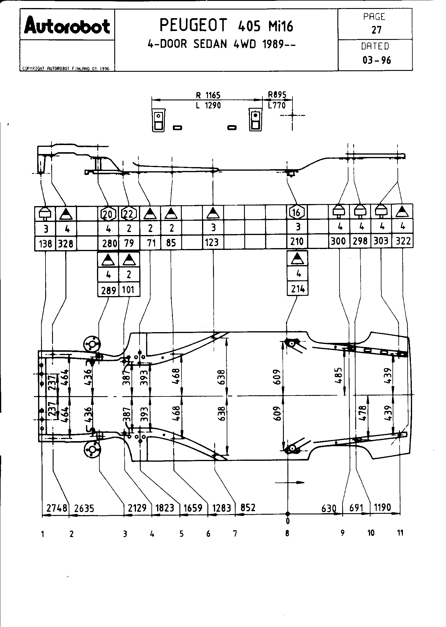

Front mount of the rear subframe is different design between 2wd and 4wd. Also the mounting points are not the same. Check from attachments.
The diff and the driveshafts are not needed. Just use outside part from the outer CV-joints to keep wheelbearing compressed.
