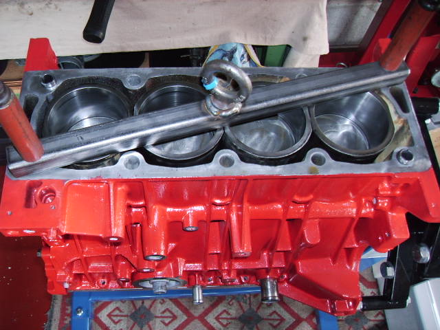

Main progress has been cleaning up the block, the head and manifold are still away waiting for the porting and grinding to be done. I've made some simple liner clamps to make sure the wet liners can't move, so i can now crank the engine over by hand.

looks like you used the same tubing as me :lol:
Bit of steam pipe, FOC from work! :lol:
