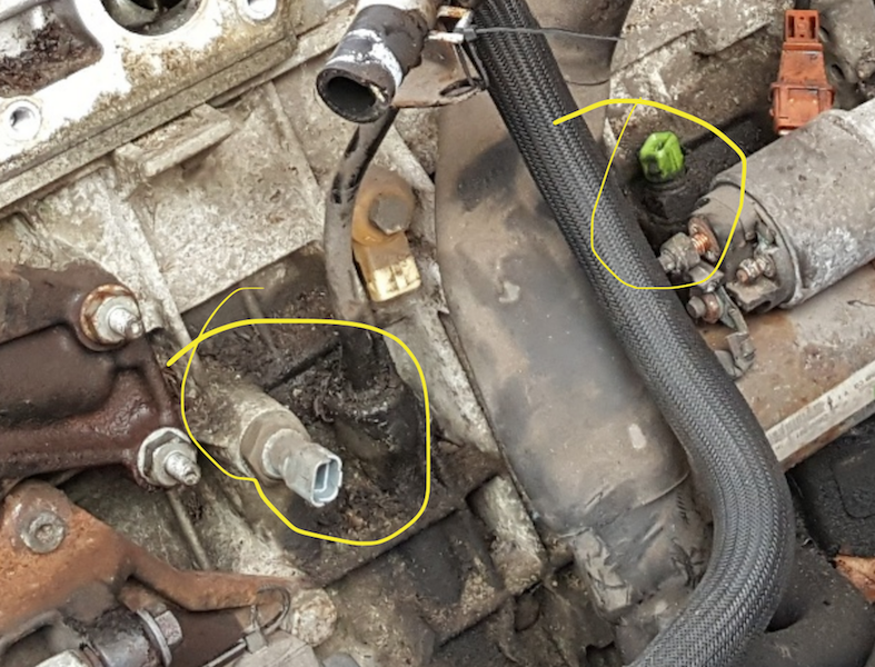

From your picture, the XU7 looks identical to the XU10, with two oil pressure sensors tapping directly into the oil gallery.
DrSarty
Thought so. The RH (green connector) I'm sure is a level sender/low level switch, so I agree wouldn't be pressured; but it could be a good turbo oil drain.
The LH (grey) one is the factory OP warning light switch, which I'm going to take to a new funky dash gauge per Andy's suggestion - including scaled reading and low pressure warning light - and then I'll still need a pressured feed tapped in for the turbo, ideally at the rear or end above the flywheel.
Both are pressure. One is oil pressure light, the other is oil pressure gauge. Neither can be drain. Either can be feed.
Edited by petert
Is there an oil level sensor (or bung) on the rear of the block which could be used as a drain?
there's only one pressurised port on the xu7 block which is where the pressure switch is fitted iirc.
Andy
The green connector is an oil level sensor so drops to the sump. Might make a good turbo oil drain if it is a large enough diameter. In JIC hose speak, I reckon you need -10 hose at least for the drain , so do check that the hole vacated by said green sensor is large enough. If not, hole in front face of sump above the oil level should do the trick.
Andy
I've got to admit that's what I thought too from the XU7JP4 block I had a few years back. I replied saying that this morning, then deleted it as I doubted myself given the elapsed time and didn't want to give bum info.
Servicebox shows an M10x1 threaded bung in the front of the block behind the starter and the level sensor probe on the rear, which only further confused me as that doesn't look like an M10 threaded part in the photo! Wondering if that's another SB error, perhaps using the XU7JP 8v block (which does have an M10x1 thread into the oil gallery same as the XU5/XU9 block).
I just assumed the green sensor was a regular M16x1.5 gizmo. Unscrew it Sarty.
Edited by petert
wicked
