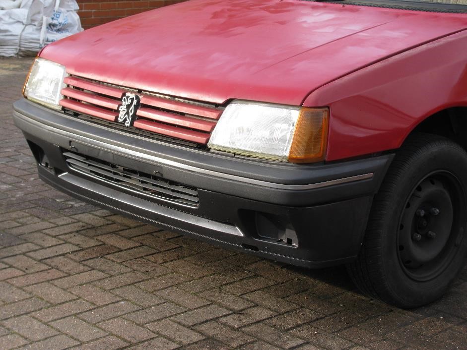

Fitted the bumpers today- GT front valance with silver strip and a matching rear. I think it looks pretty good

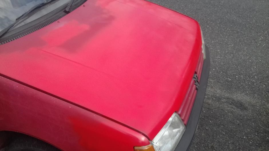

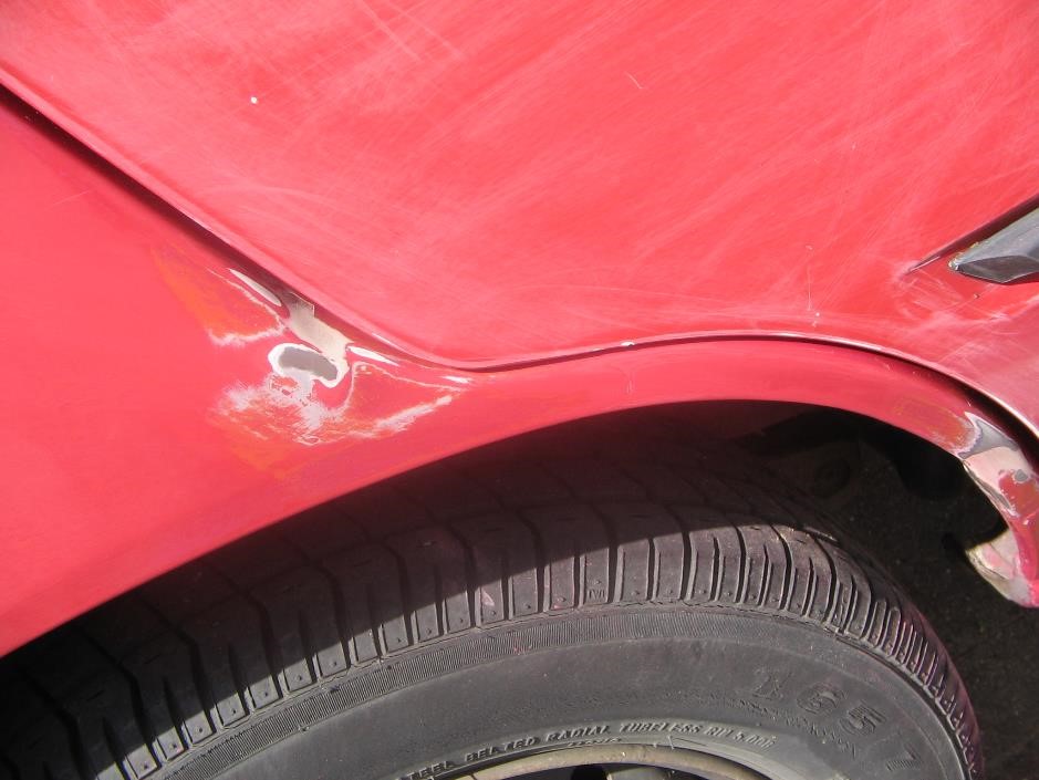

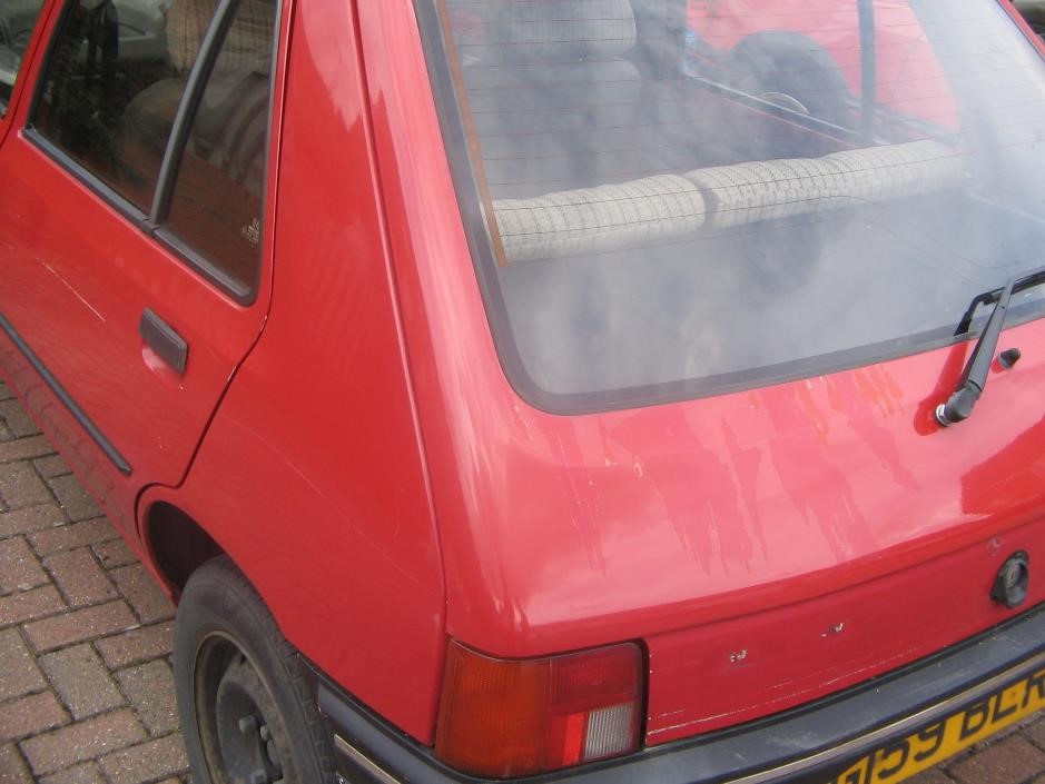

As you can see from the pics the paint is in a fairly bad way:
The plan is to use the old paint as a primer surface for the new by keying the paint with sandpaper and thoroughly degeasing it.
We spent about 3 hours rubbing the paint work down. The worst part is smoothing off the peeled laquer areas
So now the car doesn't have a shiny panel left and is parked back out the front of the house - with a real rat car look about it - bringing the house prices down!

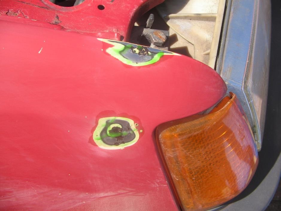

derust, and prep of various areas ...

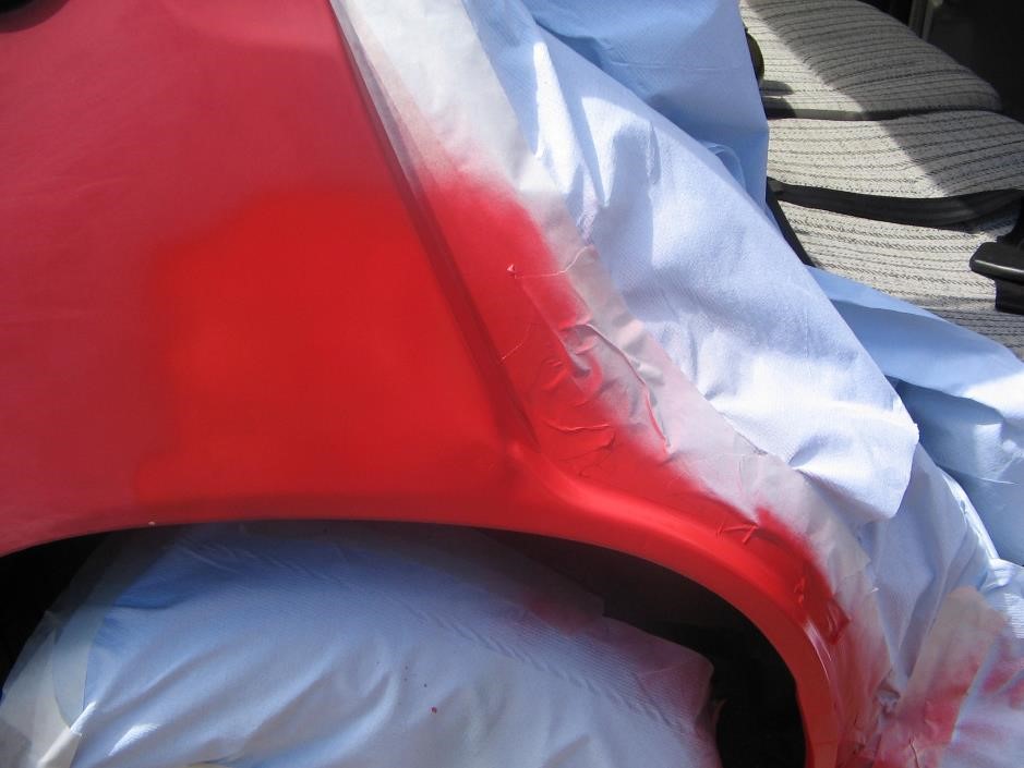

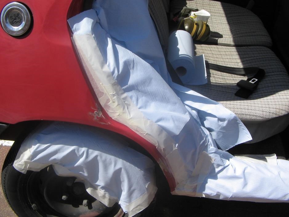

there isn't much real rust on the car- but 2 main areas are the rear 1/4 panel and the front wing.
So the boy set about rubbing down and treating both areas

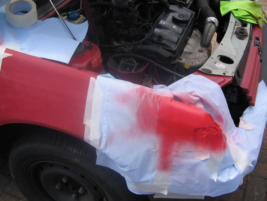

we then masked it all off and used a rattle can primer and some GTI cherry red to seal the area until we spray it up properly.
This was an ideal opportunity for the lad to have a go at spraying for the first time....
Many lessons learnt!! :D

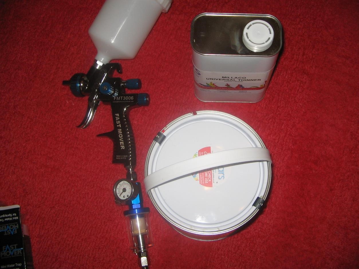

Today we bought the paint and a spray gun with a pressure regulator and water trap attached.
I knew nothing about any of this but now I'm a bit more educated!
Total for the paint, thinner and gun £120, added to the masks and a few other bits - £170 so far which is pretty good really!

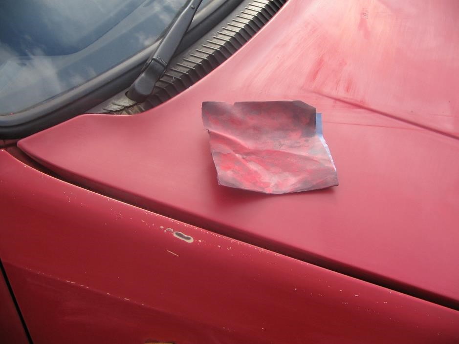

SO today I thought we could derust the bonnet. All done and as the car isn't being sprayed for a week I let the boy loose with a rattle can of cherry red so he could see the pitfalls of spraying.....
The result
I like the cherry red but he insists on it remaining the original burgundy red
Edited by Telf
I reckon that will take a good hour to rekey for the actual spray job. Many additional lessons learnt. I dare say it will be a bit easier with a proper gun.
