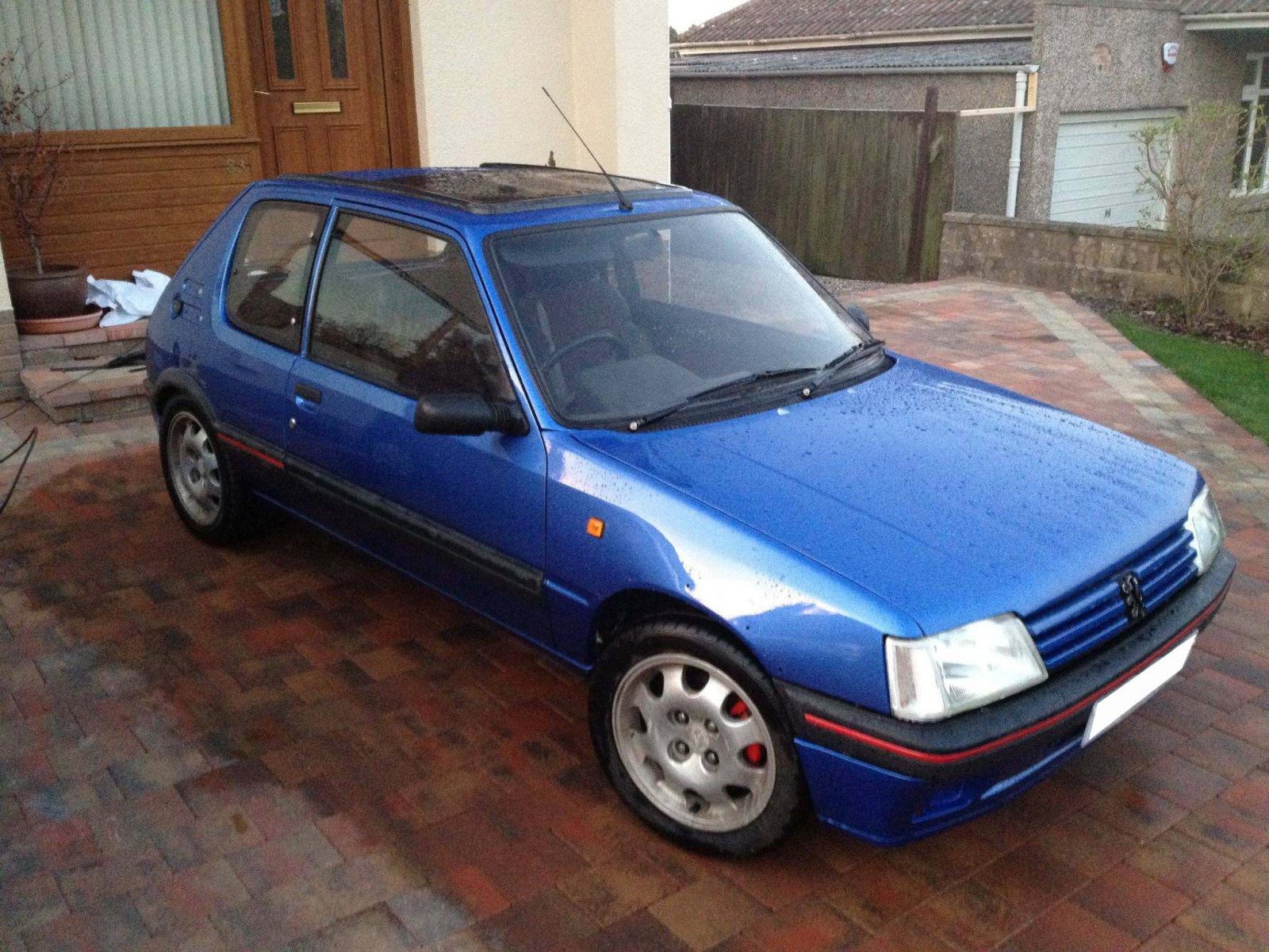

gavbrum
Nice ride height with Bilsteins and Eibach's.

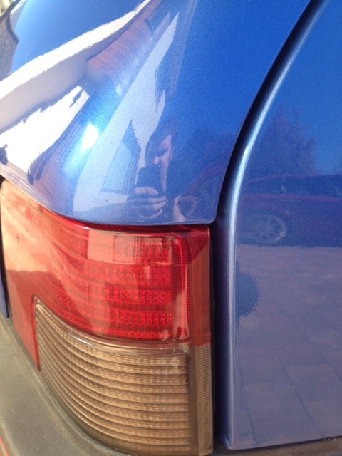

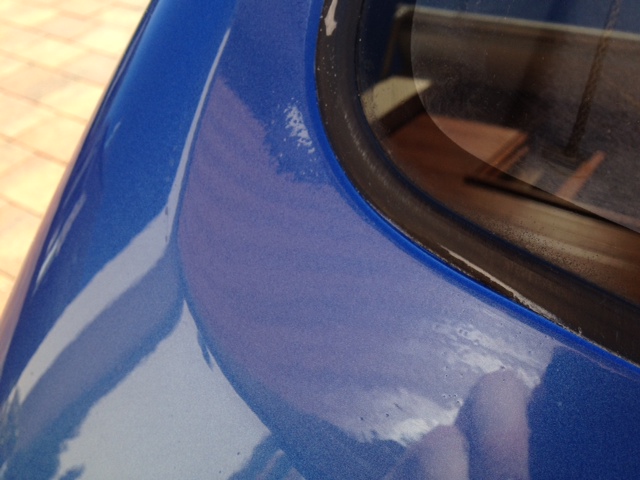

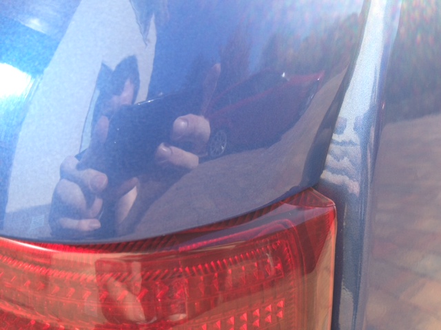

Over the last couple of weeks started noticing some real bad bits in terms of the paint job and panels.
Bent tailgate.
And after some gentle persuasion. Paint is now under tension so might crack at any time.
Poor paintwork
Not too happy. More bad bits to follow....
gavbrum

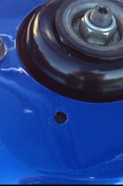

Painting over rust. This is one example of numerous bits around the car.
toddydal
who prepped the car mate as i have just been looking at your pictures and they have started rubbing your car down before stripping it out(taking trims and door handles off etc)which tells me straight away not right.the orange peel on the rear 1/4 just needs a flat and polish and the strut tops ground out and treated but you cant garantee rust never to come back unless you replace it but you can hold it back along time it treated properly.was it a expensive respray?if so give it a good going over but give the guy a chance to put it right
toddydal
sorry mate just had a closer look and thats poor prep work paint contaminated depending how many coats of clearcoat over the top they might get away with blocking it out and polishing it but i would check the rest of the car for this as there will be signs of attempting to remove it,if its all over the car and they canot remove it or rub through the clear trying to remove it it will need redone
