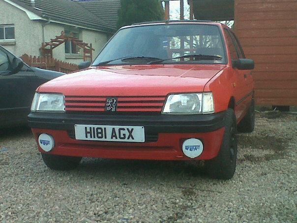

HI Everyone ive just motd my 1991 peugeot 205 dturbo 5 door in red!,after a few weeks the head gasket went so ive decided its time for an engine swap ;)
it has a 1769cc turbo diesel engine ,no intercooler!
My plan is to pick up a secondhand peugeot 306 d turbo engine with the enginemounted intercooler?
