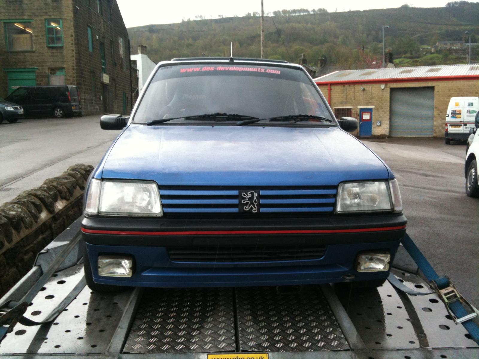

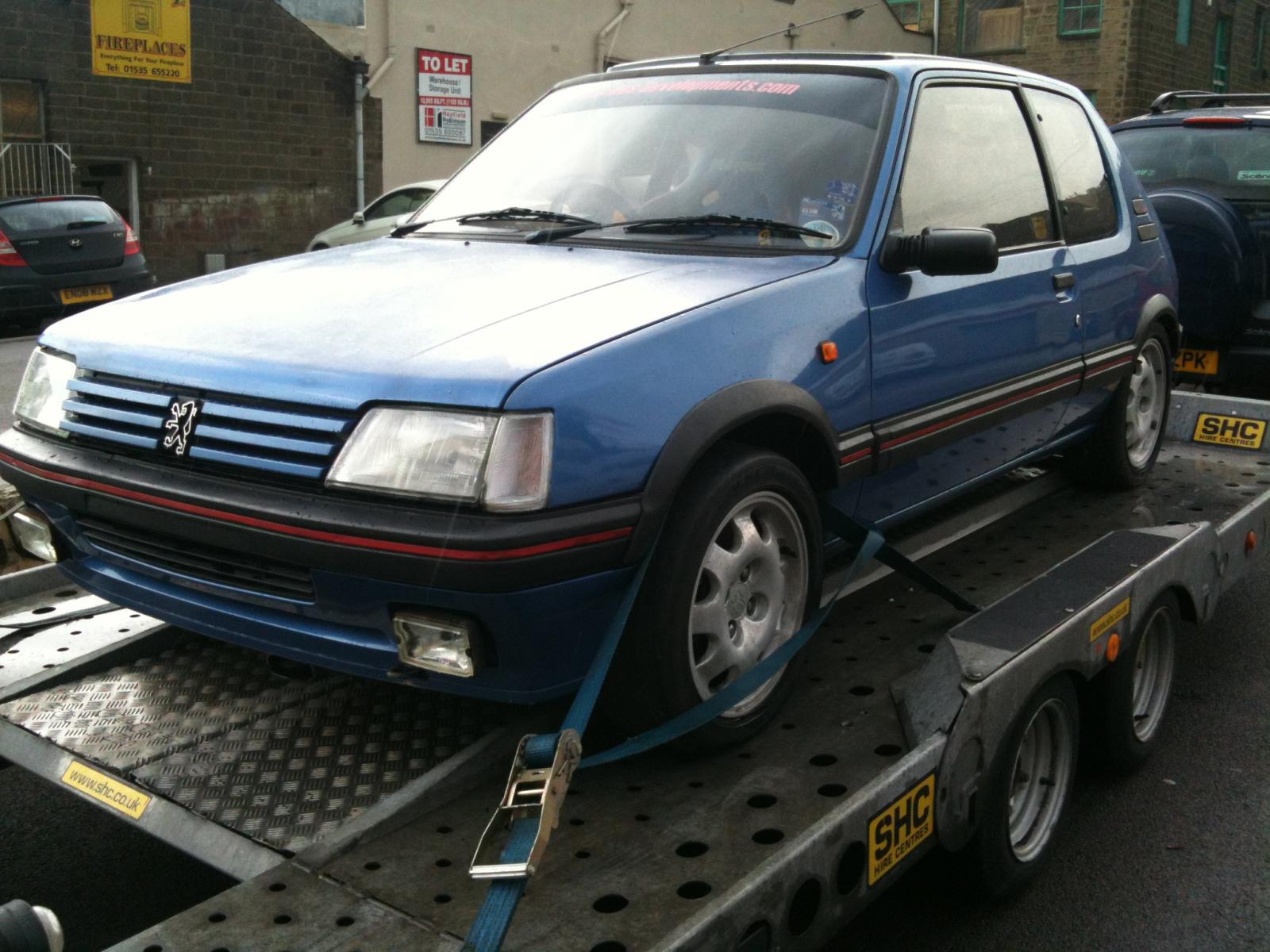

After owning two 1.6 gti's & a 306 S16 in my younger years, I have finally got a car I have always wanted, a miami blue 1.9!! This one has had the Mi16 conversion done already, albeit 5 years ago & unfortunately has not really been used since it was done!!
It has (according to the invoice in the paperwork):-
Mi16 conversion with baffled sump,
head ported & polished with Piper 264 cams,
Peugeot Sport driveshafts,
Peugeot Sport Gp N exhaust,
Gti6 master cylinder,
Gti6 front brake conversion,
re-furbished rear beam with Gp N torsion bars,
poly-bushed throughout,
GAZ adjustable suspension.
All the work was done by DES DEVELOPMENTS.
It also came with an unpainted automatic bonnet which will replace the usual laquer peeled standard one.
Apparently it goes like a rocket but not at the moment!! Due to not being used there is the possibility that the head gasket may have gone!! (praying not the case!)
It was picked up this morning & dropped off at a garage for a proper diagnosis. So other than this major (possible) issue, the car just needs tidying cosmetically.

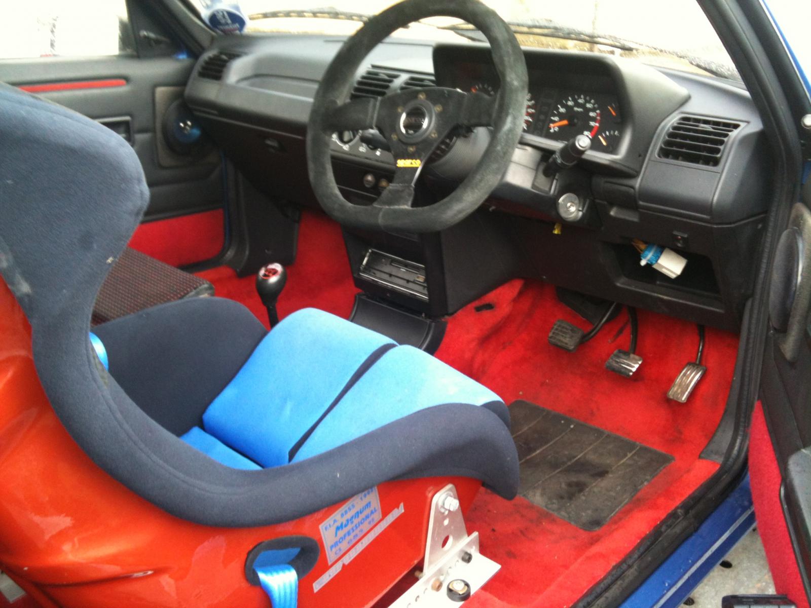

Not yet sure if the Magnum bucket seats & Sabelt harnesses will stay, only driver's seat fitted at moment, i will have to think about that one.

Looks good mate. Buckets look comfy

externally it looks good and should look amazing after a good detail! :)
as for those seats and steering wheel being a very modified 205 gti i dont suppose it matters if the interior is modified too but if it were my car it would be back to oem in no time!!!

The seats & steering wheel are going!!! I much prefer the stock look with the surprise under the bonnet!!!
I just need to get a drivers seat as the previous owner 'lost' the original seat & my good lady wants to drive it (in spite of her whining & protesting about me purchasing another toy!). I also need to raise the rear suspension as well.
