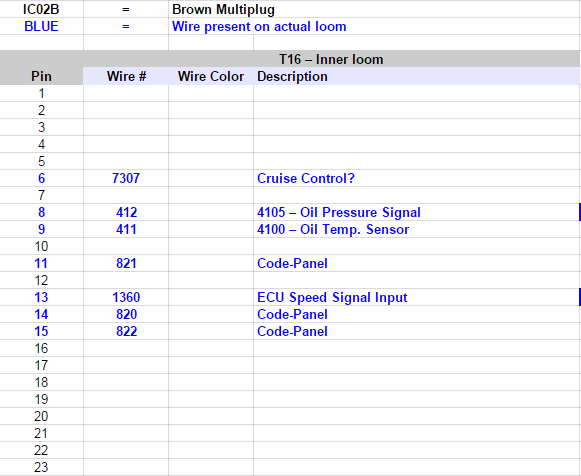

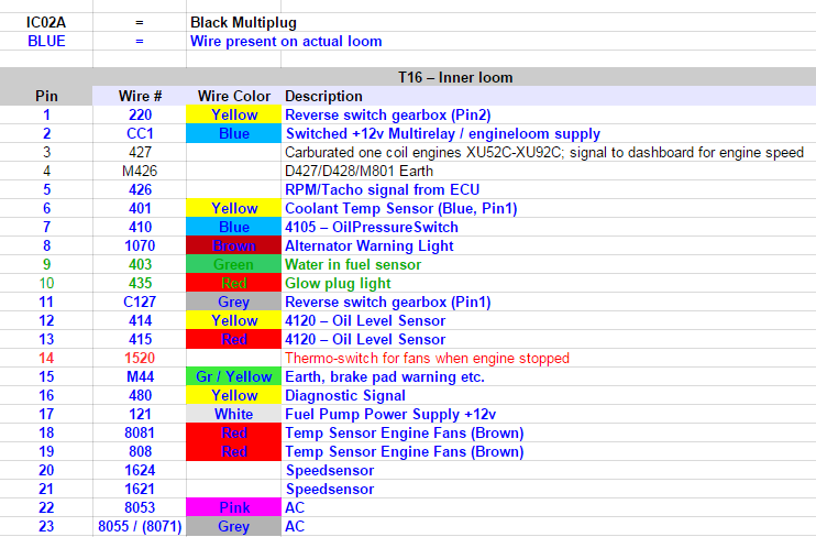

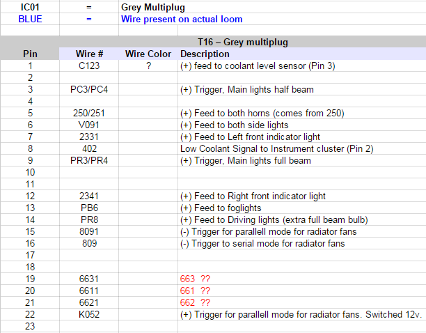

Not much response on this but here are what I've found out after soem investigation.
Black multiplug:
(should be generic for all models, but not all wires present between the different one, most models only got one wire from speed-sensor etc.)
Brown multiplug:
Grey multiplug: (lightning, horn and cooling-fan related)
