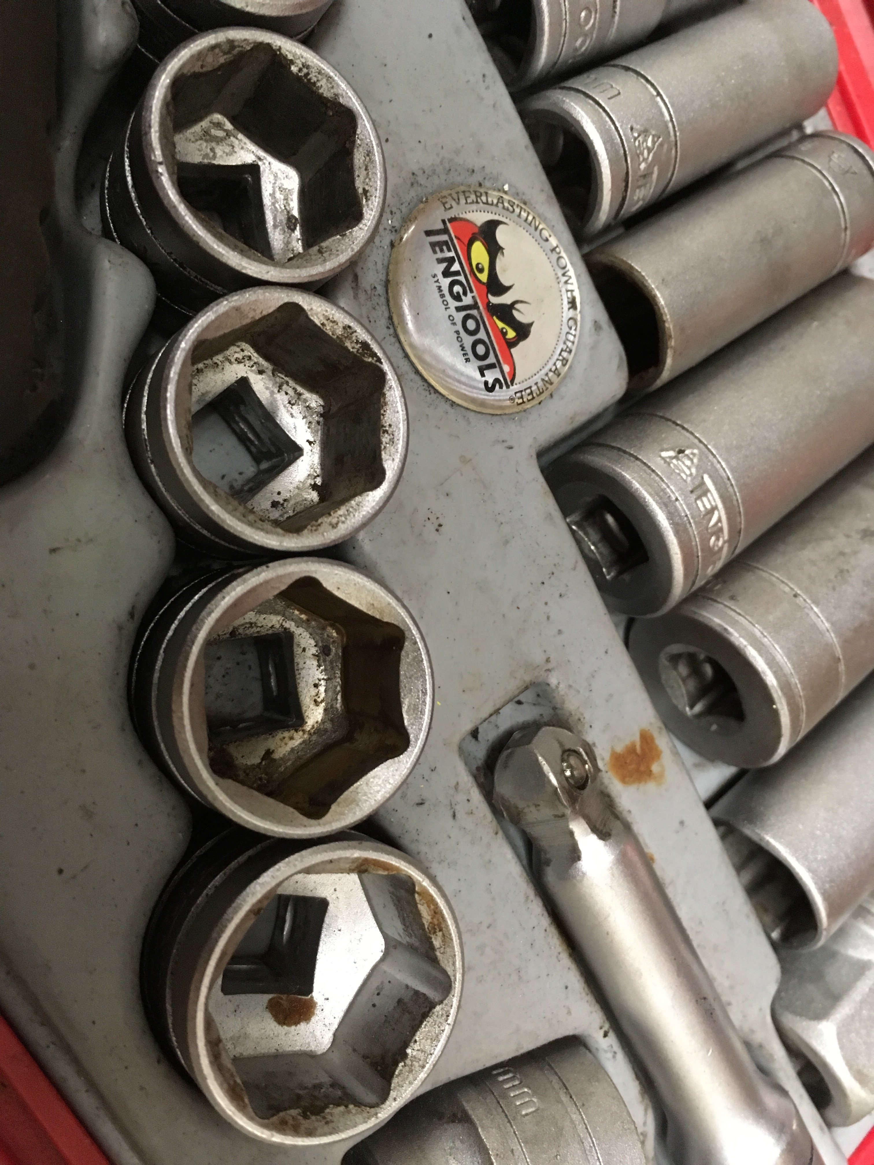

Here are the tools I used doing this job,
Hammer and small chisel
3/8 ratchet and extension
Nutgrips
13mm spanner and socket
Wire brush
Big screwdriver to work the rubber bush into the cup
