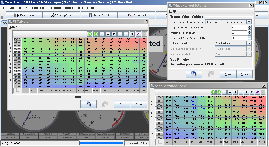

Hi, im new in this forum, im from Argentina and i have two little cti´s . One is standard 1.6 and the other one has a 1.9 engine from a gti and megasquirt2.
 I installed an Mi16 flywheel and im using a cranck sensor in the 1.9 engine, so i have a wasted spark  coil pack.
I didnt check it with a timing light but with a BTDC angle of 114 degrees it crancks well and engine starts with no problems.
 The real problem is that after the engine starts it dies after a few seconds, im lost because adding more or taking off fuel isnt working and the same for the spark advance. I think there is another problem and i cannot find it. The fuel pump is working fine.
  Does anyone have a clue of why is this could be happening?
Thanks!!, sorry for my english, im a little bit rusty.

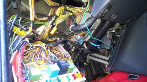

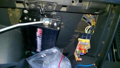

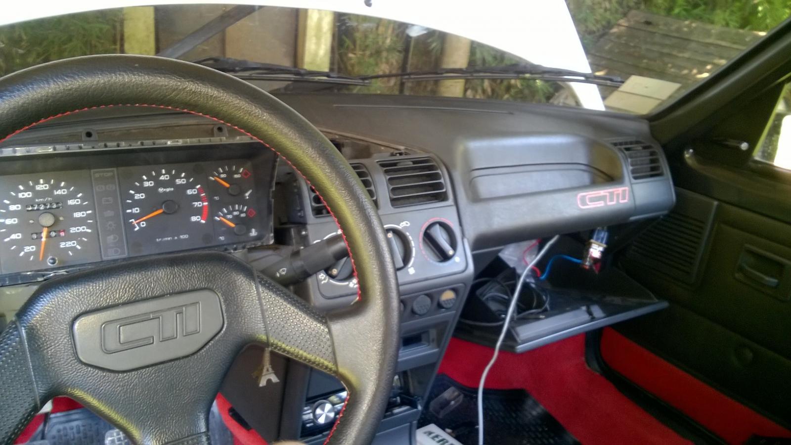

Pitcrew, im gonna attach some pictures so you can help me to switch the cable because i dont know which brown plug you are saying. Im a little bit lost with that
Wicked, i dont have that option in my MS2 , i checked every option but there isnt nothing like that.
I thnk the best way is like Pitcrew i saying but im still needing help to locate that brown plug, Here some pictures....
Thank you both!!
Thank you both!!
Welshpug, not pitcrew haha

Problem solved! i was missing the cable thats gets the coil signal, so i connected this cable (the same cable that gets the rpm signal for the dash) to one of the two coils signal and the tachymetric relay stayed on. Thank you guys!
