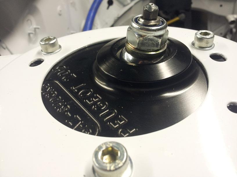

The shell, the biggest changes are going to be a cage made from t45 and some adjustable front suspension made more for the drag strip. The front end also has fibreglass dimma front arches and the front bumper which im modifying to be completely smooth on the front with a re moveable panel for when its driven on the road. Stew from baker bm has made me a shortened radiator with an oil cooler added as my last engine oil temps got quite hot whilst driving round Spain. The radiator is stunning but more importantly should keep my temps good on the road.

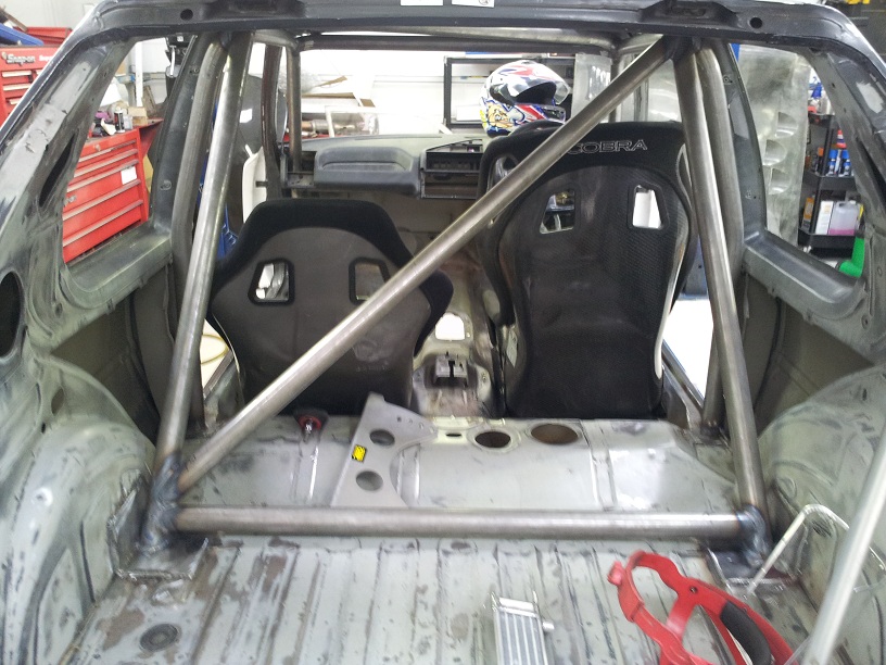

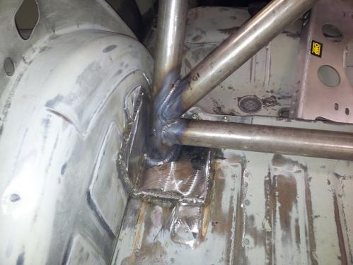

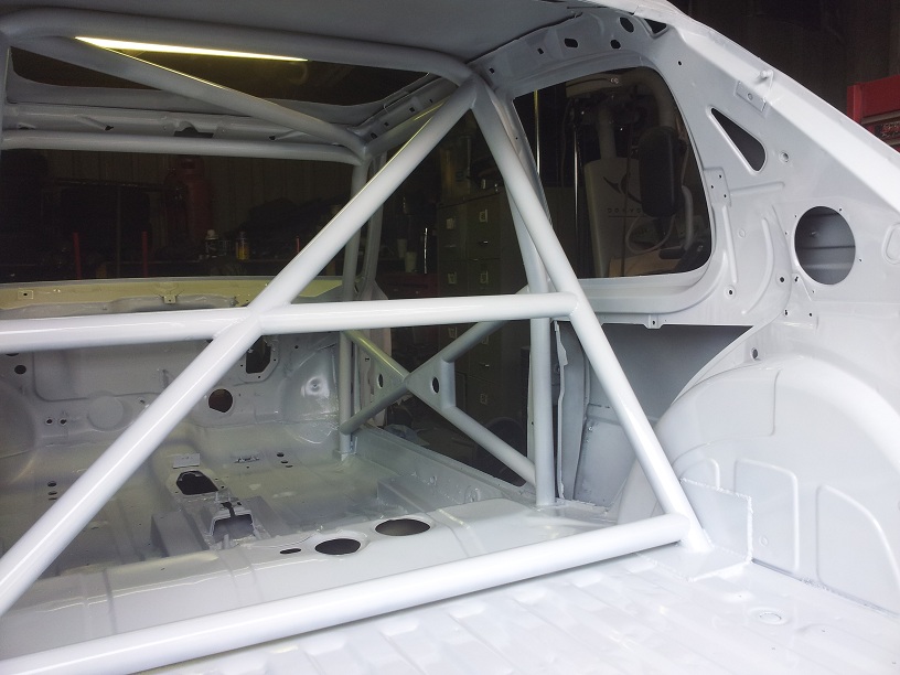

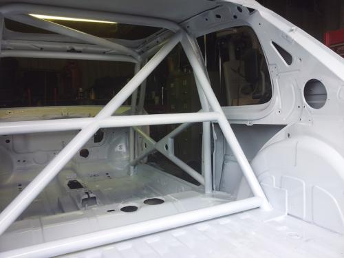

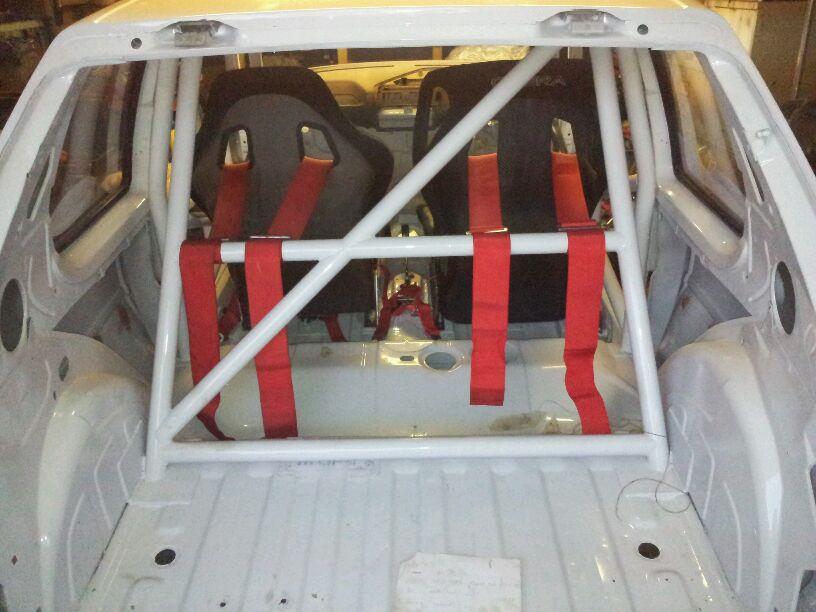

Cage now finished ane sprayed the inside yesterday. Really pleased with the results. I found it very difficult to get into all the nooks and crannys and there are bits ive missed on closer inspection but still very happy with it. Im just plodding on little by little.

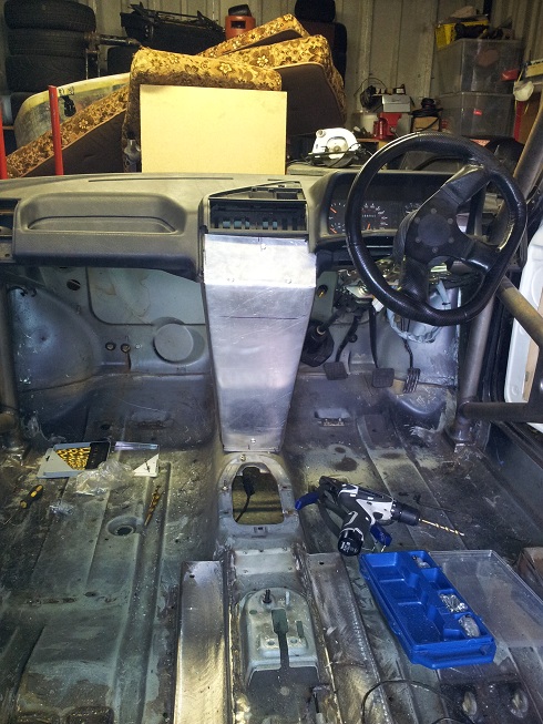

Also made a switch panel for when the time comes to do the dreaded wiring. I want to have this flocked along with the dash. should look good against the white. I need to move onto the engine bay now. so will upload the pics when i make more progress.

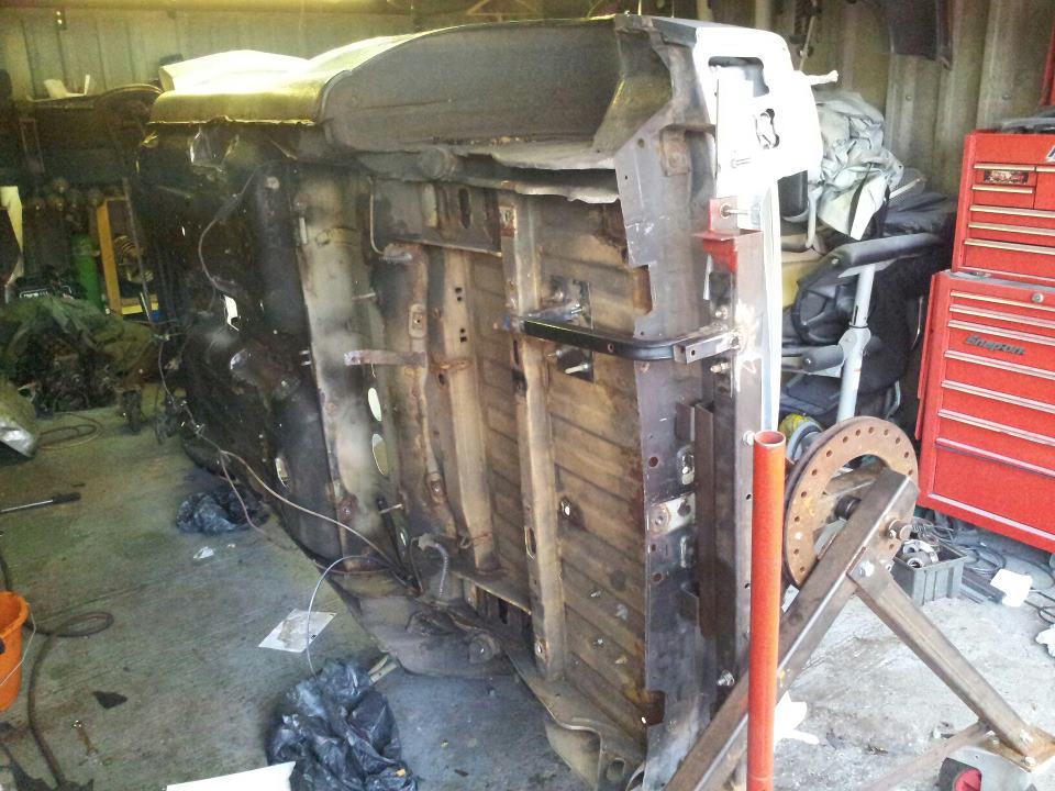

What an effort it was to get the car on a spit, the front was easy, i just mounted it straight to the bumper mounts. The rear was a lot more difficult, i have mounted it to the rear scuttle panel and added some extra bracing as this metal is just too thin to be taking the weight. I wasnt going to do anything underneath but where the seat mounts and cage have been added it had burnt through the under seal so if im going to do a good job on the car it needs to be done right. I hate car preparation. Heres the pics.

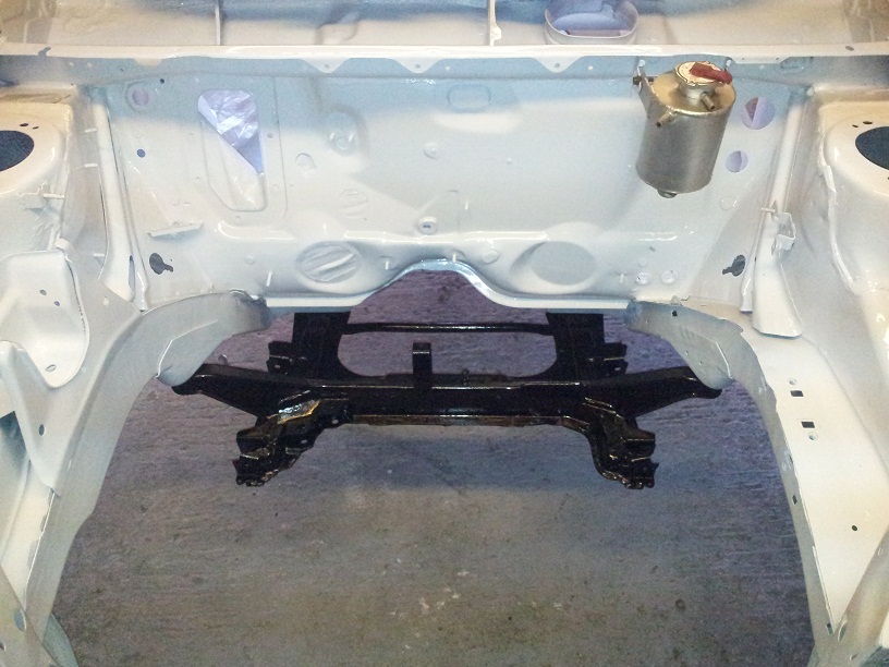

Update time. I have stripped all the underseal off as best i could without wanting to send myself insane. Sprayed the engine bay white and started fitting a few things. I have the outside of the shell to paint next. Then i can really start on getting everything clean and painted and bolting it all on. Engine work has all but stopped due to us saving all our money to buy the house but im aiming for July to run this car again. Still lots to do though, heres a couple of pics.

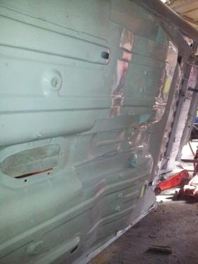

Well i spent this week Spraying the outside of the shell and its a disaster. Never had this problem before but its full of pinholes, Bought a new cheap gun which i wasnt happy with the amount of fluid leaving the gun so i was possibly a bit close or it could be water in the air. I had the heater on in the garage this time so its possible water had condensated in my compressor. Thats a full week wasted. Need a little bit of time away from it.

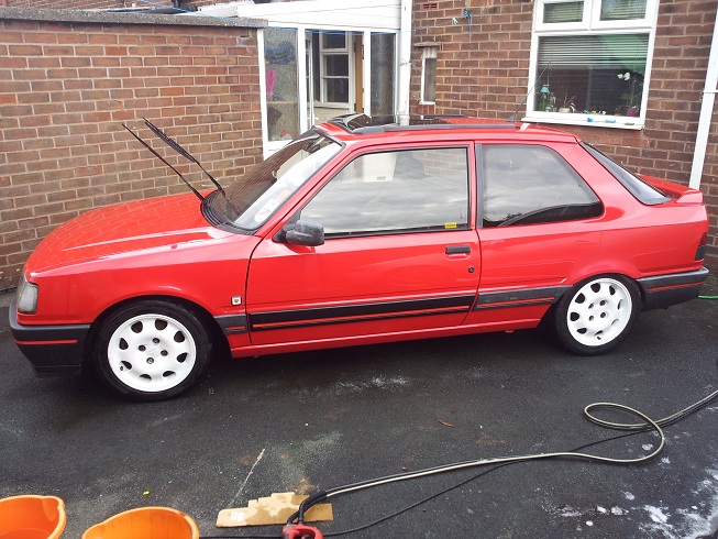

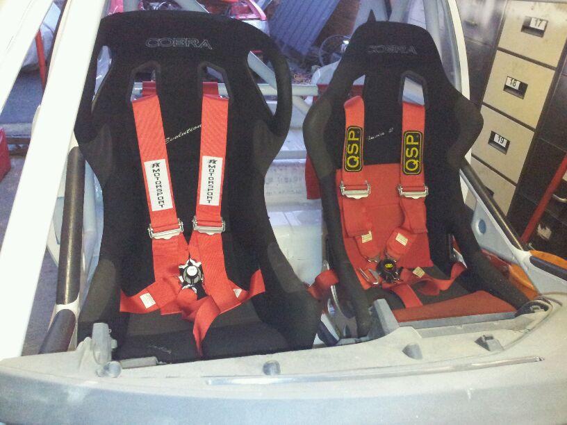

Ok, had a long hard think about the paint. I can live with it, and because its my car and i want to get it racing again so it will have to do. After a season i could always get it resprayed again by a professional. But i cant face having another year not racing.

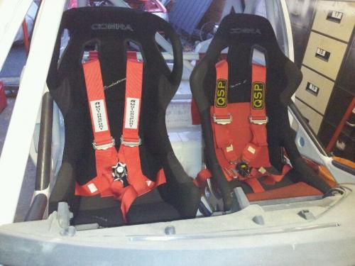

So seats are in and the rear beam is back on so I could return the rotisserie to the owner. I also put the back windows in. There only little jobs but after the last few hickups, not just with this car but with my turbo 309 and my GF's freelander problems i feel like im making progress again. Heres some pics.

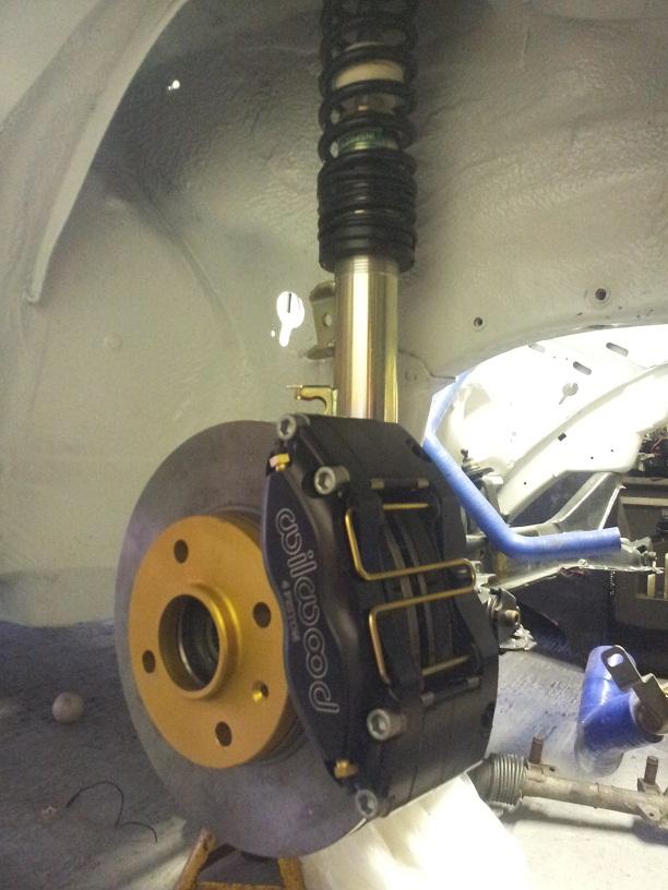

Small bit of progress with some shineys. Not much to say about it though so ill just show the pics. Suspension will be set up when the car is finished.

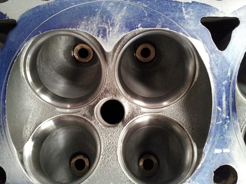

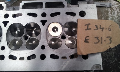

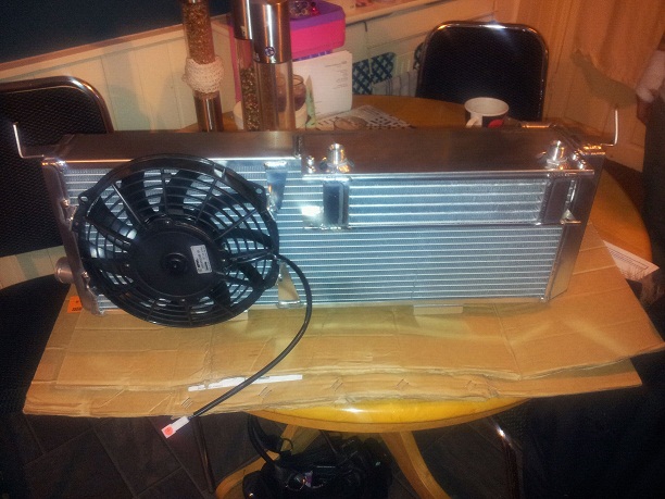

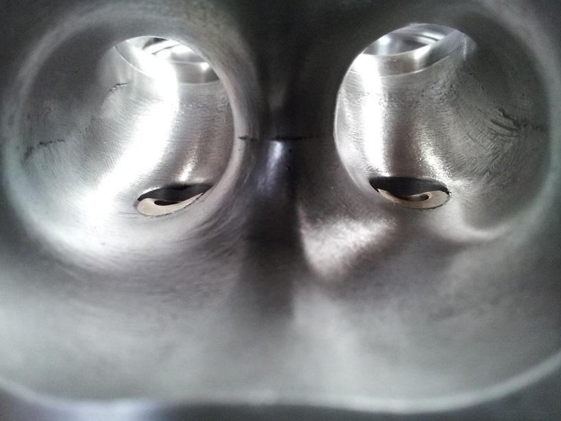

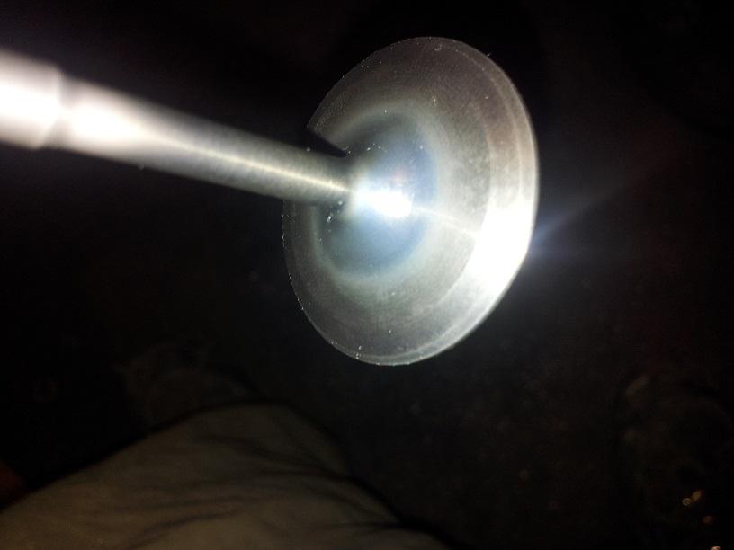

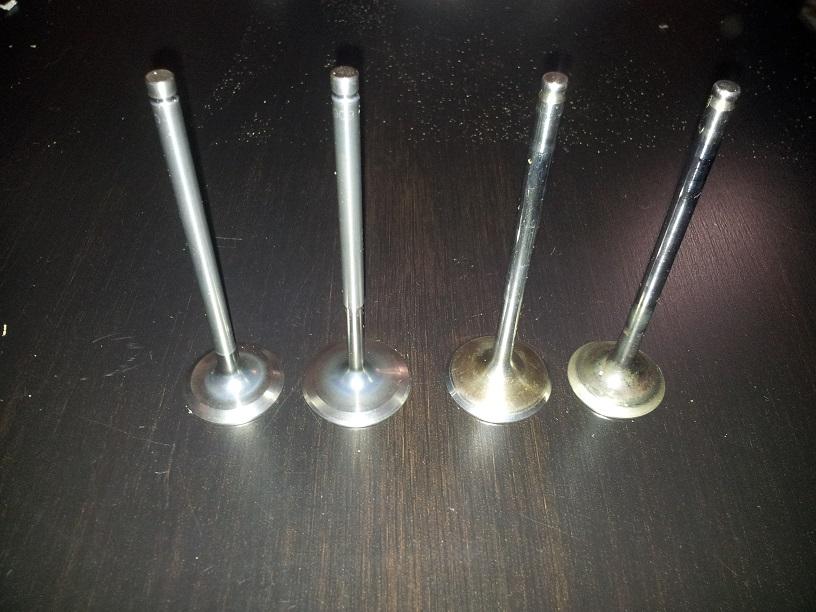

I have been slowly progressing with the engine build. The head is back from cnc heads who hand ported it as they dont have a program for cnc. I also have bought slightly bigger valves.
Next i need cams, springs and solid lifters and verniers. When will the spending end??
Then for the engine to go on the engine dyno i need some throttle bodies.
Heres some pics.
New valves on the left and old on the right.

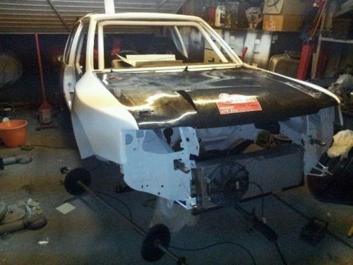

So much work still left to do. it seems never ending. All the jobs are tied in with other jobs and sometimes i feel like i can never finish anything. Well my new unit has been a godsend as im spending so much more time there. I now have throttle boddies cams ect to finish the head.

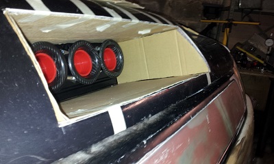

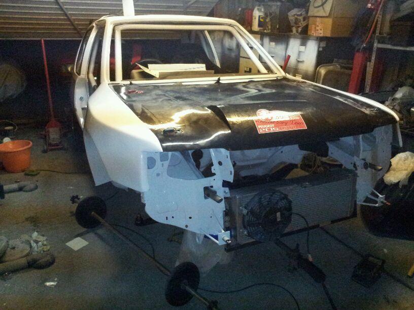

The front end is nearly all bolted together, I still want to finish the new scoop ive started making. For the end product i want the insert for the scoop to be made from carbonfiber that slots in and can be removed with quick release fastners.

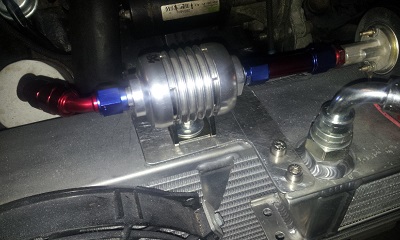

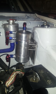

The fuel system uses the standard pump in the fuel tank to feed through a 100 micron fuel filter to the engine bay swirl pot, which will feed a bosch pump which then feeds through a 10 micron fuel filter to the boddies then returns to the swirl pot after the regulator. The swirl pot also has a return from the top back to the fuel tank.
Ive ordered 3 drums of q16 to run the engine on the dyno and should have enough for the first race day however im strugling to get it. Apparently the shipment has gone to Isreal from america instead of this country. Becoming a bit of a headache but I cant find it from anyone else other than trackstuff.
Heres some pics.

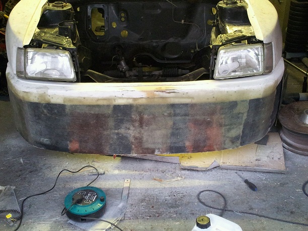

http://vimeo.com/m/92460645
Video of the progression of the bumper. Only took around 3 years. Next is to make a mold and make it in 1 piece of carbon fiber which I have never done. The engine is waiting to be dyno ed soon so watch this space.

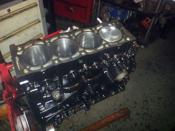

well the bottom end is rebuilt after they dyno session. It made 280hp at 7500 but we started pressurizing the water. I had not been as accurate with some of the measurements.
so I have remachined the pistons and built the bottom end. I need new valves which I have ordered and 2 new head gaskets that are slightly thicker from cometic.

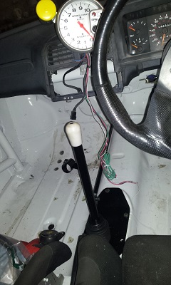

The wiring of the car has really took it out of me but its nearly there. Heres a pic.
