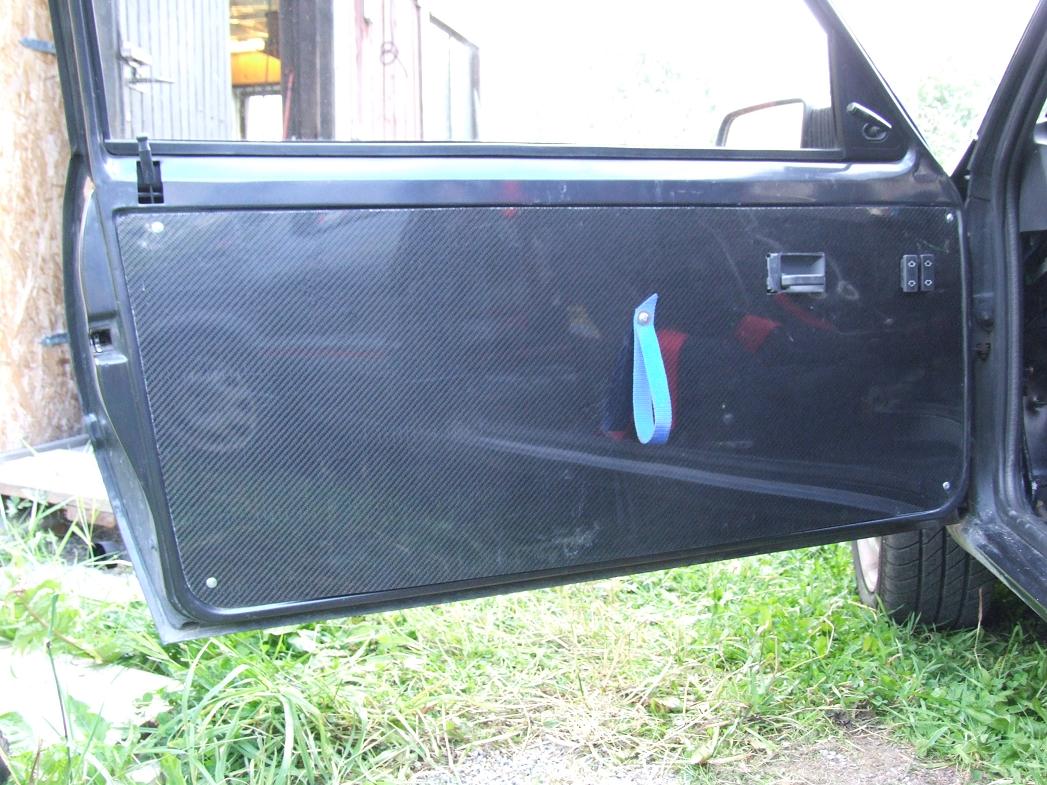

And some carbonfibre. Why not save some wight.

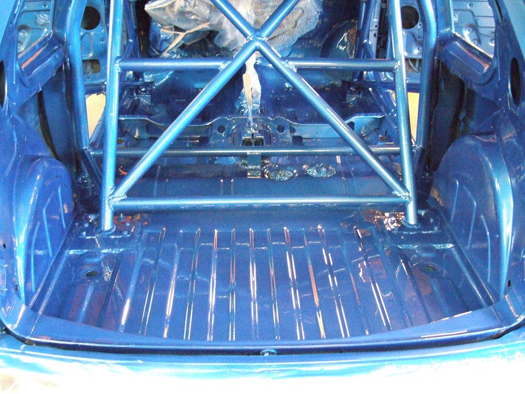

Almost done with the roll cage.

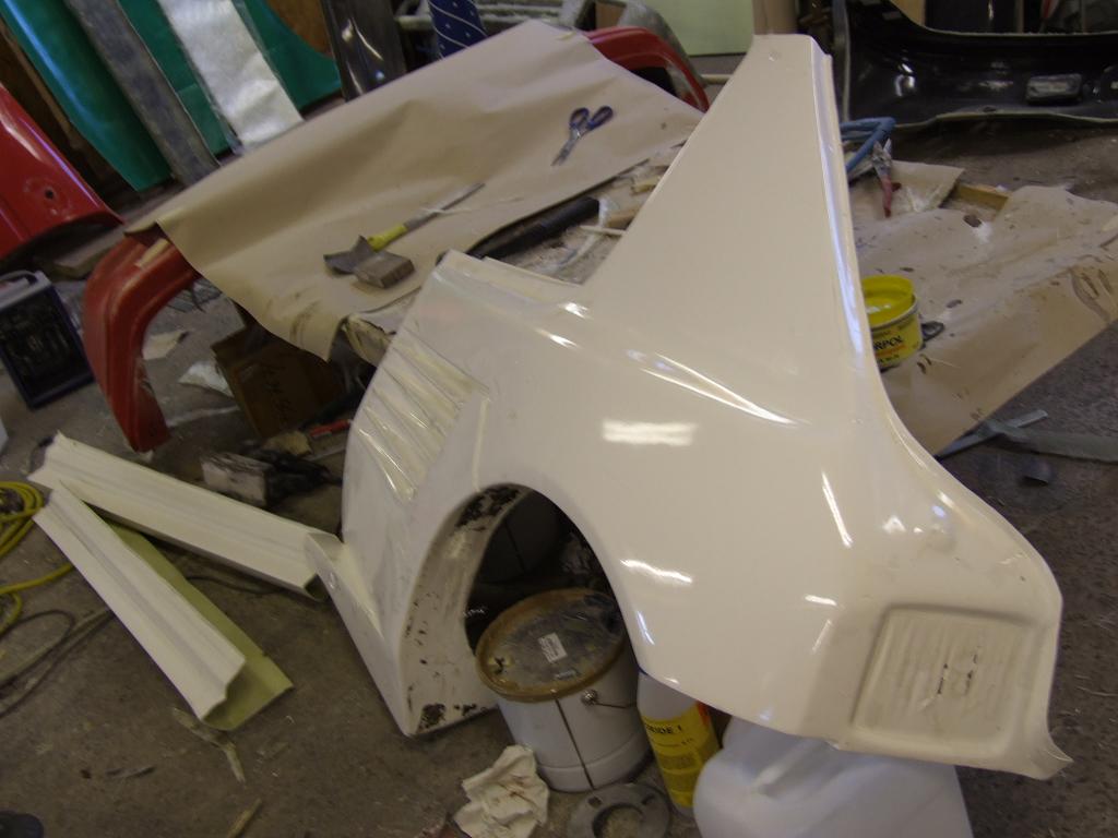

I borrowed a Dimma shell of a buddy. And start the plastic work.First of all the moulds.
O some more carbonfibre. I like carbon fibre.
Fron wing's on it's way.
O there it is.
Ready with more and more of the plastic parts.

As I can't sleep I go on with the paintwork.
Some part's been painted.
And the shell itself.
O I forgot I've doors to. And even they need some paint.
Yes they got blue.

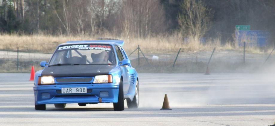

Time for a test run.
Down to the beach.
Some polycarbonate windows.
Got some spacer today but I can't find a picture of them. they are 55mm wide. Here's the car with the trackday tires and the spacers in place. Just like glowing in the dark.
A little aggresive look?
First real testrun.

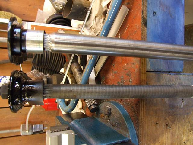

Some more for the road use. Refurbished rear axle from a 309.
Including a better ARB.
Everyone who has refurbish a rear axle know what it means when you forgot this little thing. Found it on the desk when I think I've done all the work. So I've to start over.
