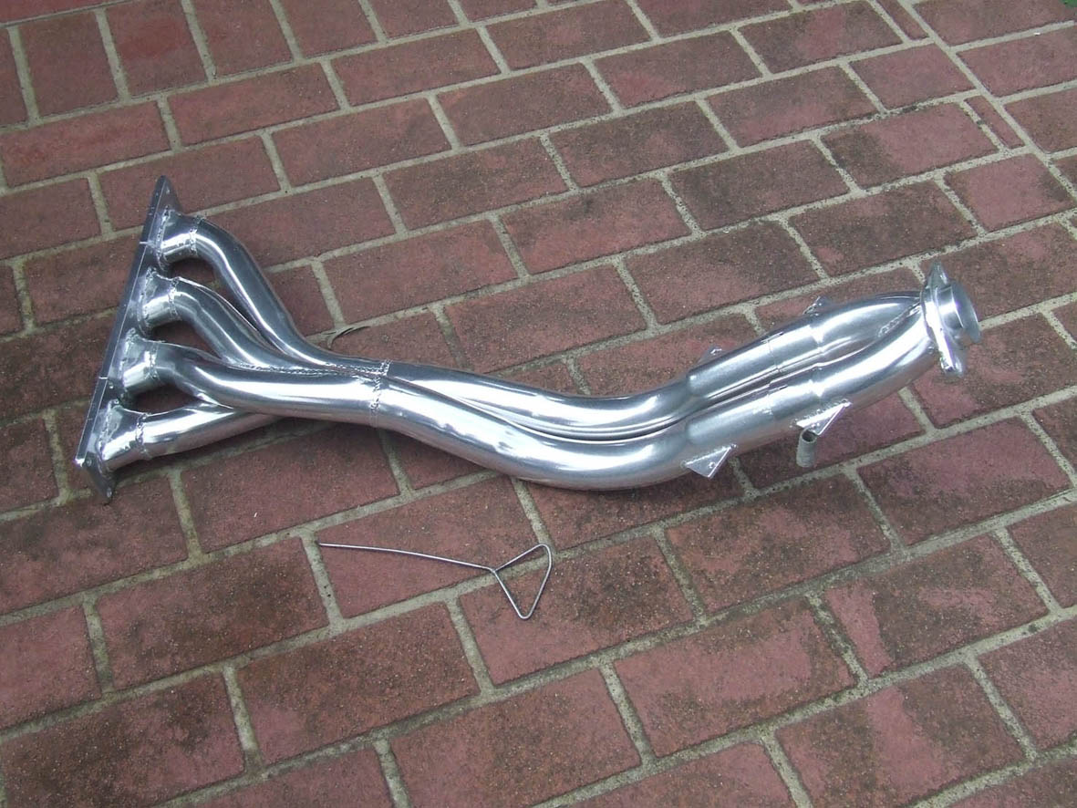

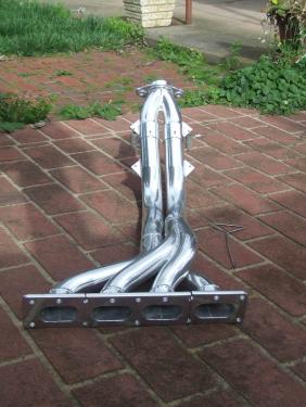

I have had one of of Miles' 4-2-1 manifolds done using the metallic ceramic coating system for my 405 track car. Being dark grey (Magnum) & fully stripped out, it didn't need a hot track day to make things pretty uncomfortable behind the wheel so the resulting drop in cabin temps from heat soak through the firewall & floor was very noticeable-and welcome!
A well worth it exercise IMHO.
$AUD280 included welding on the spring coupling 'ears'
http://blastfactoryabrasiveblasting.com.au/index.php?pageid=3936

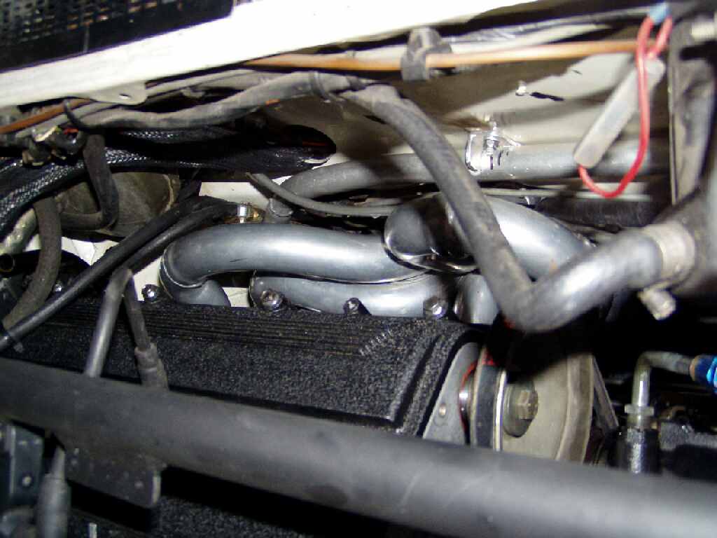

I've got ceramic coated GTi6 pipes. Not sure what the hp gain is but they certainly help keep down cabin temps as Jeff said.
