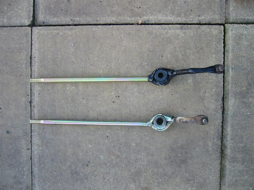

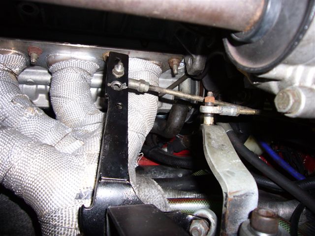

Henry Yorke 269 3 Cars Posted July 31, 2012 My CTI one. Nice and punchy through the gears. Lightly clips on the cat on second, but managable. Share this post Link to post Share on other sites
allye 530 3 Cars Posted July 31, 2012 Here's mine, lift reverse fits fine for my 6speed. Doesn't hit the exhaust at all. Share this post Link to post Share on other sites

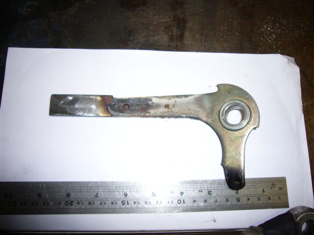

Baz 421 Posted August 1, 2012 Mines to go in a stripped car so doesnt matter to much about trim. Do you have any issues with the bottom of the stick fouling the heatshields/exhaust? Nope, nothing. I do have a modified L-quadrant on the subframe too, gear to gear movement is really reduced, shift-time is too obviously and you can get your hands back on the wheel very quickly. I wouldn't go too long on a rally car, but on a road/track car i'd happily extend the bottom a little longer for a shorter-shift, but be warned, go too far and it makes it horrid. Share this post Link to post Share on other sites

dave205 19 Posted August 2, 2012 What mods have you done to the L-bracket then? I want it to be reasonably short, but when you say it can be to short, i pressume it becomes snatchy? Share this post Link to post Share on other sites
engine killer 5 Posted August 4, 2012 What mods have you done to the L-bracket then? I want it to be reasonably short, but when you say it can be to short, i pressume it becomes snatchy? you can always shorten the short side or extend the long side. i extended the long side as it gives "options" to go back to original and a few different settings. Share this post Link to post Share on other sites
