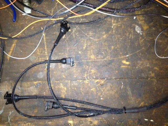

Nice work, but have you seen this stuff?
http://www.ebay.com.au/itm/230661544820
It's cheap, available in many sizes, far more flexible and looks very professional. I've made three looms this year with this stuff. Love it. He'll bag multiple sizes into one bag and charge one lot of postage.
sport1901966
That does look good - does it have good abrasion resistance?
Will keep that in mind when I finally get round to building the loom for my new ECU
So far so good. Here's a portion, the injectors. I used 1/8" for individual and 3/8" for the mains.
