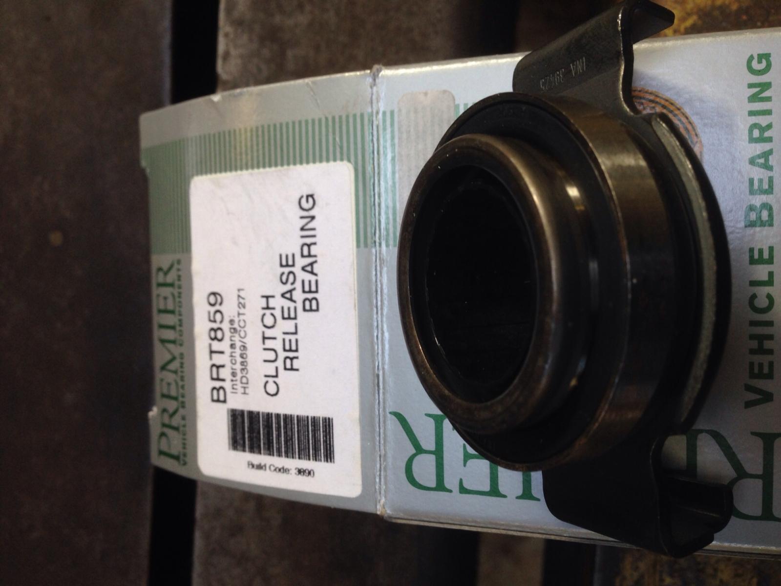

I've managed to get a Sachs one on order for tomorrow part no 3151841001 (£22 inc) is anyone able to confirm if this looks right as I haven't removed mine yet?

Mattr5uk
That's from total motor factors hopefully that's for the be1 they have told me it's up to 89 but you know what some part suppliers are like!
Mattr5uk
This is the bearing and part no on the box for it if anyone else is interested
