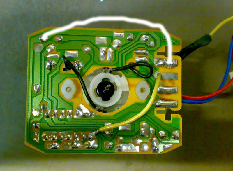

Henry Yorke 269 3 Cars Posted May 11, 2014 You can modify the back of the tacho to get this to work as above (though I have not actually done this myself). It is the same mod that you do for a GTI6 conversion Share this post Link to post Share on other sites

Anthony 1,000 Posted May 12, 2014 There's two ways of making the tacho work: You combine the two outputs from the wasted spark coil using the simple diode circuit above and wire this straight to the existing 205 tacho wire without modifying the tacho You wire the existing 205 tacho wire to the tacho out pin on the ECU and don't touch the coils, but you need to modify the 205 tacho PCB to remove/bypass part of the filter circuit so that it will work. Share this post Link to post Share on other sites
Wod 0 Posted May 12, 2014 There's two ways of making the tacho work: You combine the two outputs from the wasted spark coil using the simple diode circuit above and wire this straight to the existing 205 tacho wire without modifying the tacho You wire the existing 205 tacho wire to the tacho out pin on the ECU and don't touch the coils, but you need to modify the 205 tacho PCB to remove/bypass part of the filter circuit so that it will work. Thats it mate I was just double checking option 2 and making sure the line from the ecu is direct into the tacho Sounds easy enough! Thank you for the advise Share this post Link to post Share on other sites
