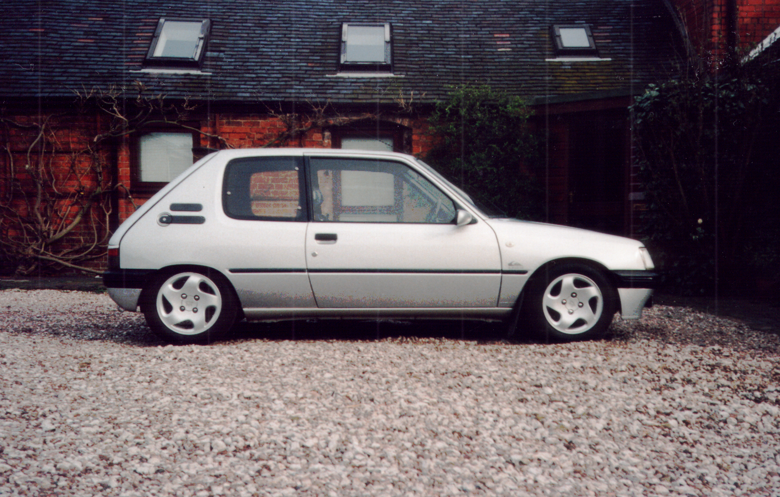

I had to pull the arches slightly at the top IIRC but got away with these 195/45/15s. lookstream.jpg
