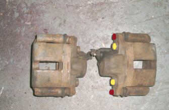

GLPoomobile 958 Posted February 23, 2006 When trying to remove my front (1.9) calipers the other day I became stumped as I didn't appear to have the right tool. The bolts that I assumed to be the correct ones that hold the caliper to the hub seemed to be of the variety that require a large allen key to remove. A 10mm was too big, an 8mm too small, and I didn't have a 9mm. Dropped in to Halfords last night to pick up a new set of allen keys and realised that none of the sets have 9mm keys! So, I just had a look on the main site at the guide to doing the 307 brake swap and it mentions that the caliper bolts are 13mm. So what's going on? Has some muppet put some weird bolts on my brakes or what? Thanks. Share this post Link to post Share on other sites

pug_ham 242 3 Cars Posted February 23, 2006 Steve, I think you have been trying to undo the two five sided bolts, to remove the caliper completely there are two 19mm bolts (like Mike says) underneath the piston body to remove yokes, calipers & all but two 13mm(ish) nuts slightly outside the two you've been trying that screw into the sliders to lift the caliper body clear for changing pads. (The maroon dots in attached picture, the ones you've been trying are the yellow ones afaik). The 19mm bolt holes are visable in that picture though. Graham. Share this post Link to post Share on other sites
