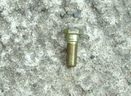

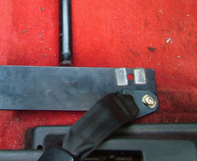

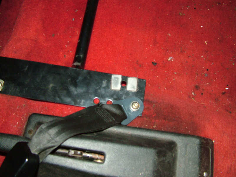

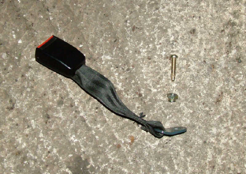

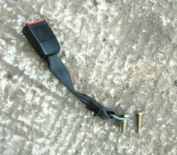

pug_ham 240 3 Cars Posted June 30, 2006 I've just been looking at fixing my bucket seats (finally) & my intended method for fitting the seatbelt clip can't be used as the subframe will only match one of the inner subframe mounting bolt holes. My thoughts now are to use the clip I got from a BX rear seats that I always wanted to use but mount it differently. The pictures below show my plans but to expand on what I'm thinking of doing now, I'm going to drill through the hex head bolt in the picture with an 8mm clearance drill & turn the threaded section off to the shouldered part so I can bolt through these into the floor pan with the original bolt. All easy enough but do you think it will be strong enough or should I look at a different stronger method & a way to use both inner mountings. (elongate the subframe holes). It'll be fine imo. Graham. Share this post Link to post Share on other sites
Miles 331 1 Cars Posted June 30, 2006 I would use a nice big washer on the belt mounting, you don;t want it pulling thru if the worst was to happen, But even better I always like to have the belts mounted to the floor. The main thing is that the fixing's in the car are fine, I know the metal by the handbrake and front cross brace tend to fail Share this post Link to post Share on other sites

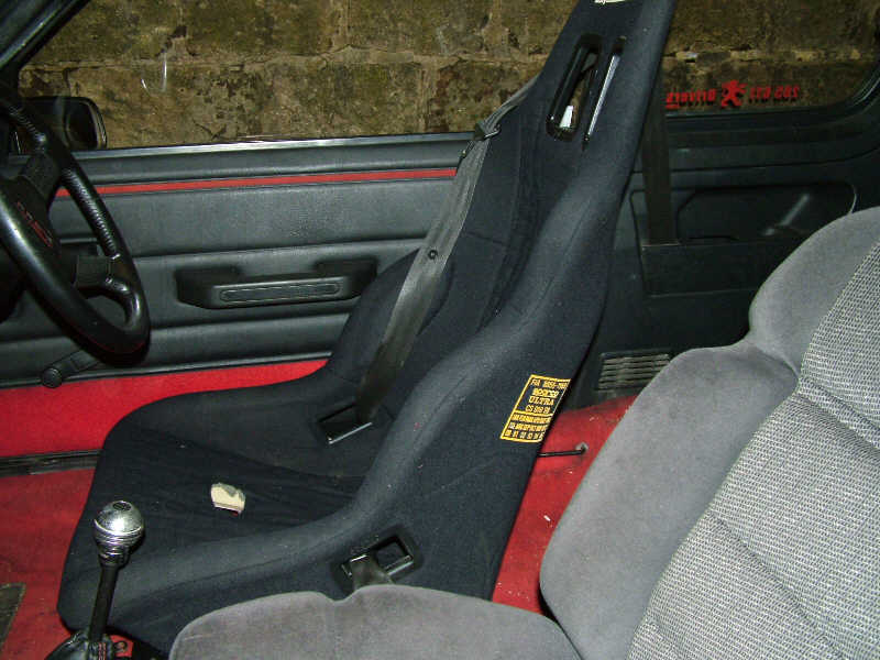

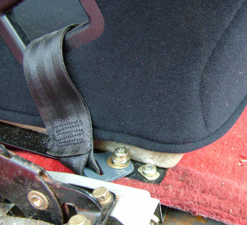

pug_ham 240 3 Cars Posted July 1, 2006 Thanks Miles, it might be a temporary thing but I'll have a good look around the underside & see if its looking weak & if so have some plates welded in to accomodate the extra strength back into that section before fitting proper floor mounted eye ends. I did everything I intended to do with the current set up & the results are attached below. I'm happy with it & the seat feels ace. Passenger seat tomorrow. Graham. Share this post Link to post Share on other sites

pug_ham 240 3 Cars Posted July 1, 2006 Assuming the seat doesn't come away from it's mountings in the event of an accident The seat is mounted to the subframe by four bolts, same as normal, the only difference now is how the seatbelt clip is fixed & there is one less bolt holding the subframe to the body but I'm already thinking of elongating the one hole on the subframe to get that in. Graham. Share this post Link to post Share on other sites

pug_ham 240 3 Cars Posted July 3, 2006 Nice one Doug, I'm going to get some big washers soon like Miles uggested though. The seats are strangely uber comfortable, I was the closest I've ever been to falling asleep behind the wheel last night but that also might've been something to do with the; heat lack of sleep for previous the three nights lack of food intake early afternoon beer at Pugfest Graham. Share this post Link to post Share on other sites
