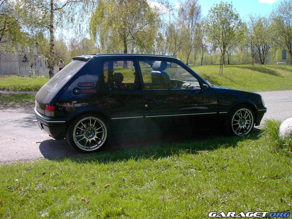

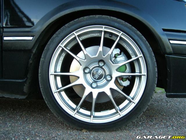

I've been looking around for some superleggeras and cant find a decent set at the moment. In the ford fitment of ET38 they were 4.9 KGS. The 10mm spacers I ran were 750g each so per corner the total was 5.65Kgs.
This year OZ have released the ultraleggera and they are available in the correct offset of ET18 and from the research I have done they seem to weight approx 5.3kgs. :)
They have a range of colours available, unfortunately white isn't one of them, so the next best looks like matt black
I'll be running 195/45/r15 ACB10 tyres, so do I need 6.5 or 7 inch wide rims ?
cheers
sean
Sandy
I'd say 6.5's, the Caterhams run those ACB10's on 6.5's.
Dj_mini
6.5 for 195's 7 for 205's. Keep you eye out on ssc for superlegeras i picked a mint set for £200 with tyres!

as a bonus, ultraleggera's look good on 205's :).
number2301
You reckon? When I first saw the ultras I thought they were a bit bling compared to the nice motorsport style Superls.

a deal has confirmed they weigh 4.8kgs each with the correct offset...nice. Unfortunately they can only supply silver, so the quest continues to get someone to supply me a set in matt black...hopefully be orderding a set this week....

number> yeah me too, but they actually look ok, at least on this car.

smighall
I think you'd be better off with 7" wide. These should give even a 195 tyre a squarer profile, ultimatley giving more grip, as the side walls should flex less.
