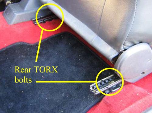

There are two TORX bolts at the front, one at the back door side and two at the back where the seat belt clip is. Unfortunately removing all the bolts does take a long time as access is very limited. Persevere; lowering the seat is well worth the trouble!

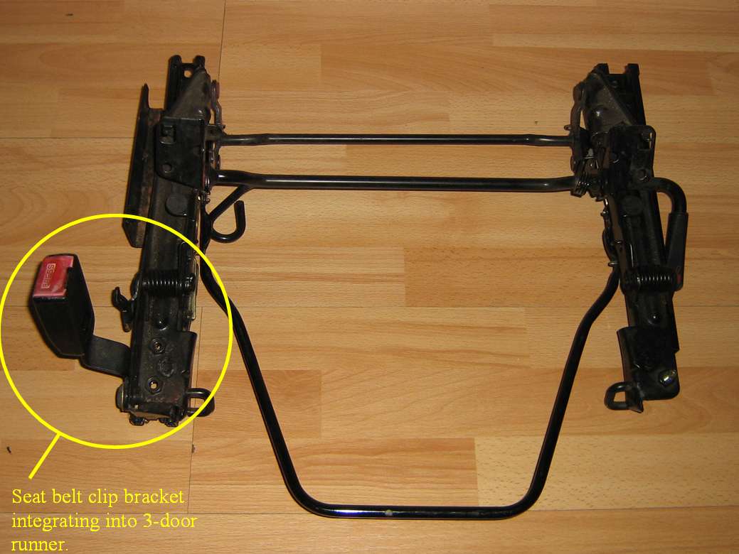

At this point you will notice that unlike the 3-door model, the seat belt clip is attached to a separate bracket that bolts between the floor pan and the seat runner. MAKE SURE YOU ALSO TAKE THIS. (Again keep all plastic washers and TORX bolts).

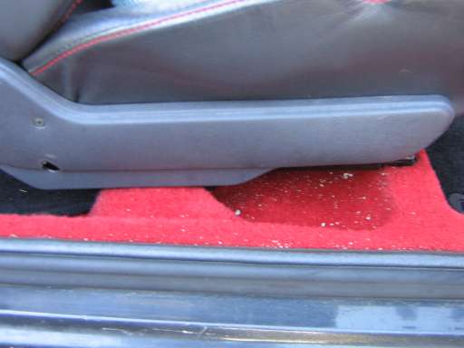

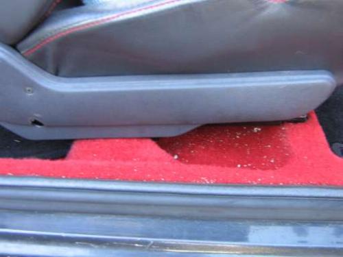

With the plastic washers (runner to floor pan) removed, there is just enough clearance for the seat to slide back & forth easily:
