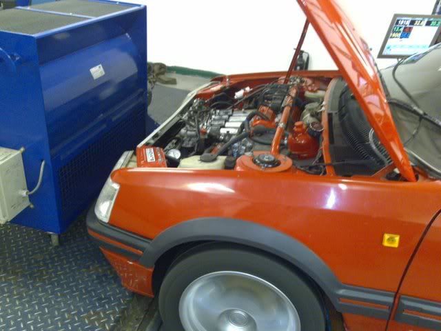

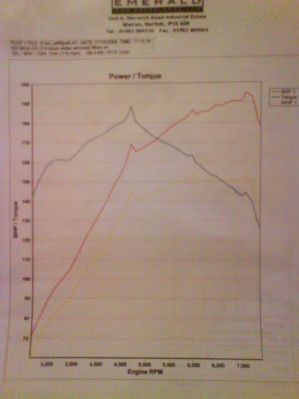

I love the extra life the Mi has, particularly that mine had after 5k with PeterT's very successful mods and the Gardias head, where it quite simply got lairy. As I'm older and not a track person, I believe I would prefer the performance (read: torque) to be delivered with less drama. I simply cannot see that these components as they stand, whilst relatively simple and 'off the shelf' - which was another budget orientated goal of mine - if set up corretly, won't deliver spades of torque in a very smooth fashion.
