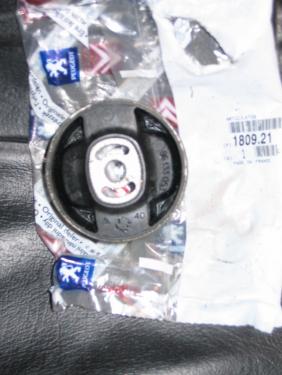

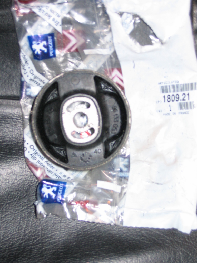

Super Josh 4 Posted June 5, 2007 I got fed up with the vibration of my solid lower engine mount and the feeling that the dash was about to jump into my lap every time I started the engine I'm using a Maniflow style manifold and have reverted back to a used standard mount. Unfortunately the exhaust knocks when accelerating in 1st gear. Has anyone fitted a TD lower mount? Which way round have you fitted it, with the solid rubber part running up/down or front/rear? Obviously I want something that is going to restrict manifold movement enough, so that it doesn't knock on the underside of the car or induce stress cracks. But I don't want anything as harsh as the group N mounts. How bad is the vibration from a TD mount with the solid piece running up/down? Any real life experiences? Josh Share this post Link to post Share on other sites

Super Josh 4 Posted June 6, 2007 Thanks Barry and Graham, very helpful replies Graham that's interesting about Nick using a TD one, that is what I have here. Under a tenner too, with PSOOC discount. Like this..... Graham, how harsh did it seem compared to a standard mount? Cheers Josh Share this post Link to post Share on other sites

jonnie205 1 Posted June 6, 2007 the baker bm one is very good and not much vibration from it. If you go for a td one then make sure you rotate it so the solid part is in line with lower mount fork Share this post Link to post Share on other sites

Baz 421 Posted June 7, 2007 the baker bm one is very good and not much vibration from it. If you go for a td one then make sure you rotate it so the solid part is in line with lower mount fork That's exactly the way i've asked for them to be pressed in before, not that it always happens though! Share this post Link to post Share on other sites
