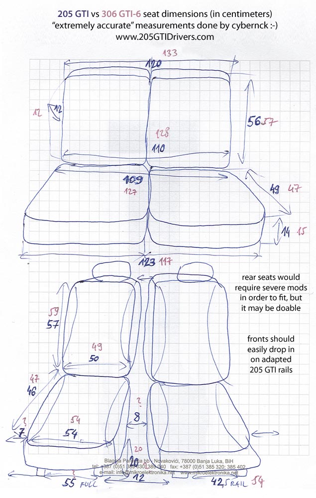

i've measured 205 GTI and 306 GTI-6 front and rear seats all over a while ago :).
surprisingly, 306's front seats are about the same dimensions as 205 ones, but very different in shape ofcourse.
the biggest difference is in rails, as outer rails on 306 seats are sort-of side mounted to the car.
someone here on the forum said the solution was to adapt and fit 205's seat rails on them though.
i'll scan in and upload my complete measurements here tomorrow - please remind me if i forget :wub:.

here are my measurements :lol:.
i've got a 205 GTI seat out of the car (and a 306 one too), so i could take a closer look at the rails and take pics and measurements.
tidypug
That would be good, could you please. I'm happy that the seats themselves will fit fine, well the fronts anyway, its just the rails that i'm concerned about.
Would you be able to measure the distance between the 4 squares were the rails mount to the seats. I'm hoping that i could fit a bracket here go between the 205 runners and 306 seat.
yeah that's what i planned to do and i should be able to do it tomorrow :).

ok, i've taken all the pics and measurements and it's looking good! :)
i'll post it all tomorrow though as i didn't have the time today.
