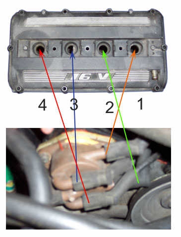

A search should've found this but even though picture shows an Mi engine the leads order & positions on the distributer cap are the same.
Graham.

In other words turn the engine until the cylinder nearest the distributor end is at its highest on the compression stroke (finger over the plug hole should confirm this.) Then remove the distributor cap and work out which electrode the rotor arm is pointing at. Then use that as a starting point in an anticlockwise direction as you look at it from the gearbox end, fit them in the order of 1-3-4-2 with as said number one being the clutch/dizzy end of the engine.
Whatever your cap looks like (the one in the picture is an Mi) the leads should still fit in the same order as the picture I posted on a Pug with the firing order 1-3-4-2.
Graham.
