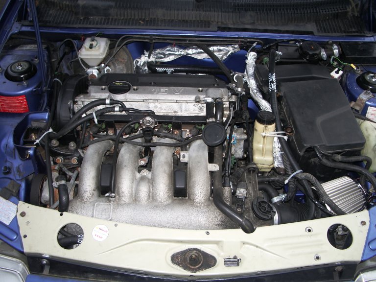

Am planning to do a decent write up for the "car works" forum but heres a pic of the engine bay.
